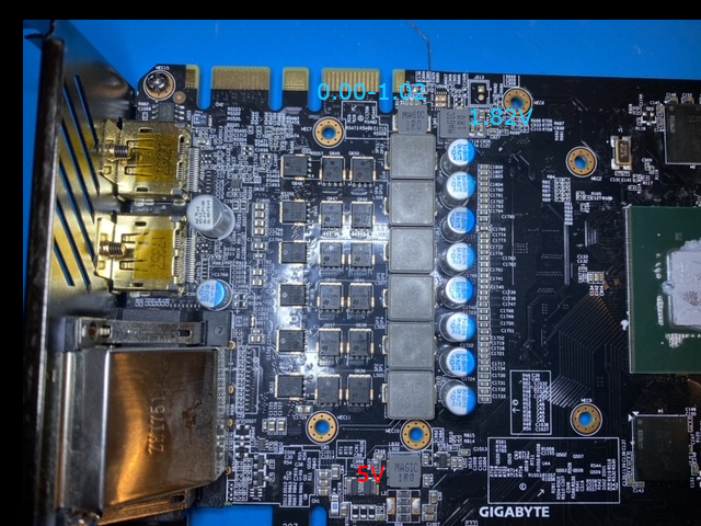

    Just got in a 1070 Ti. It powers up and sometimes gets to the windows desktop but spontaneously reboots.
    No shorts noted.
    The inductor/voltage that I have identified as being intermittent is the 1V inductor ? ? Vmem?
    On the flip side of the board is the UP1728 which is a buck converter.
    I don't have a schematic or a board view for this board so I am working in the dark a bit here.
    Anyone think I am on the right track?
