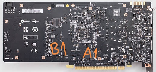

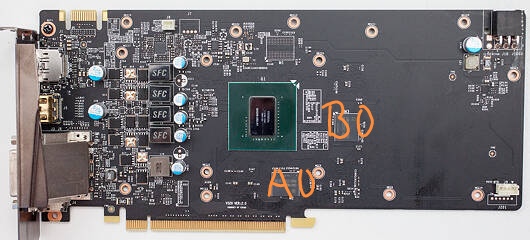

    Nvidia gtx 950 memory chips order
    Hello! I am trying to figure out order of memory banks on gtx 950 card. There are 4 chips in total, 2 in front and 2 on back side of card. Mods is giving me error on A0 and I am not sure which is that...i marked my idea what should be right order but if anyone can confirm or correct me that would be great. Thanks!
  • Opacky
    • Oct 2021
    • 8
    • Serbia
    Re: Nvidia gtx 950 memory chips order
    Nevermind guys I found answer...it is like I thought...just imagine that all chips are in front.
