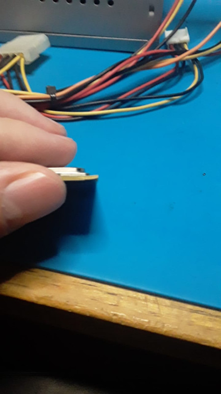

            Oh also - in my videos the motherboard was tripping out the PSU (even when I forced it to run) although I could not find any shorts.
            I didn't damage the CPU as I have used it since to test other boards. I believe this is because I have a good quality ASUS PSU with a very fast protection / over current circuit.
            I hope you don't mind me saying that in your pics you look like you are using a cheap generic ATX PSU?
            I think your case is a very good example of why you must use a good quality ATX PSU when testing and repairing motherboards and GPUs with unknown faults.

              yes i tested with "generic" psu atx..
