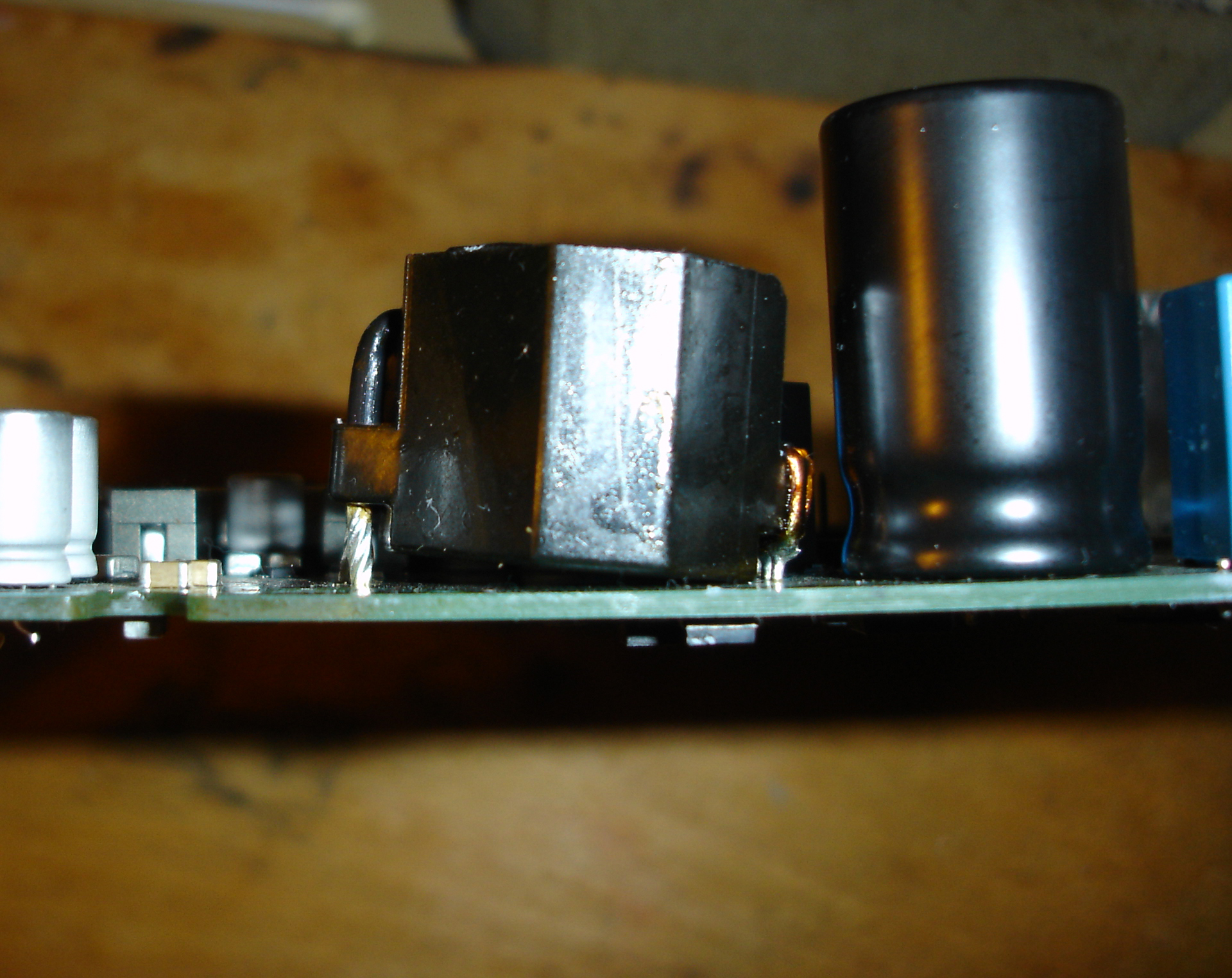

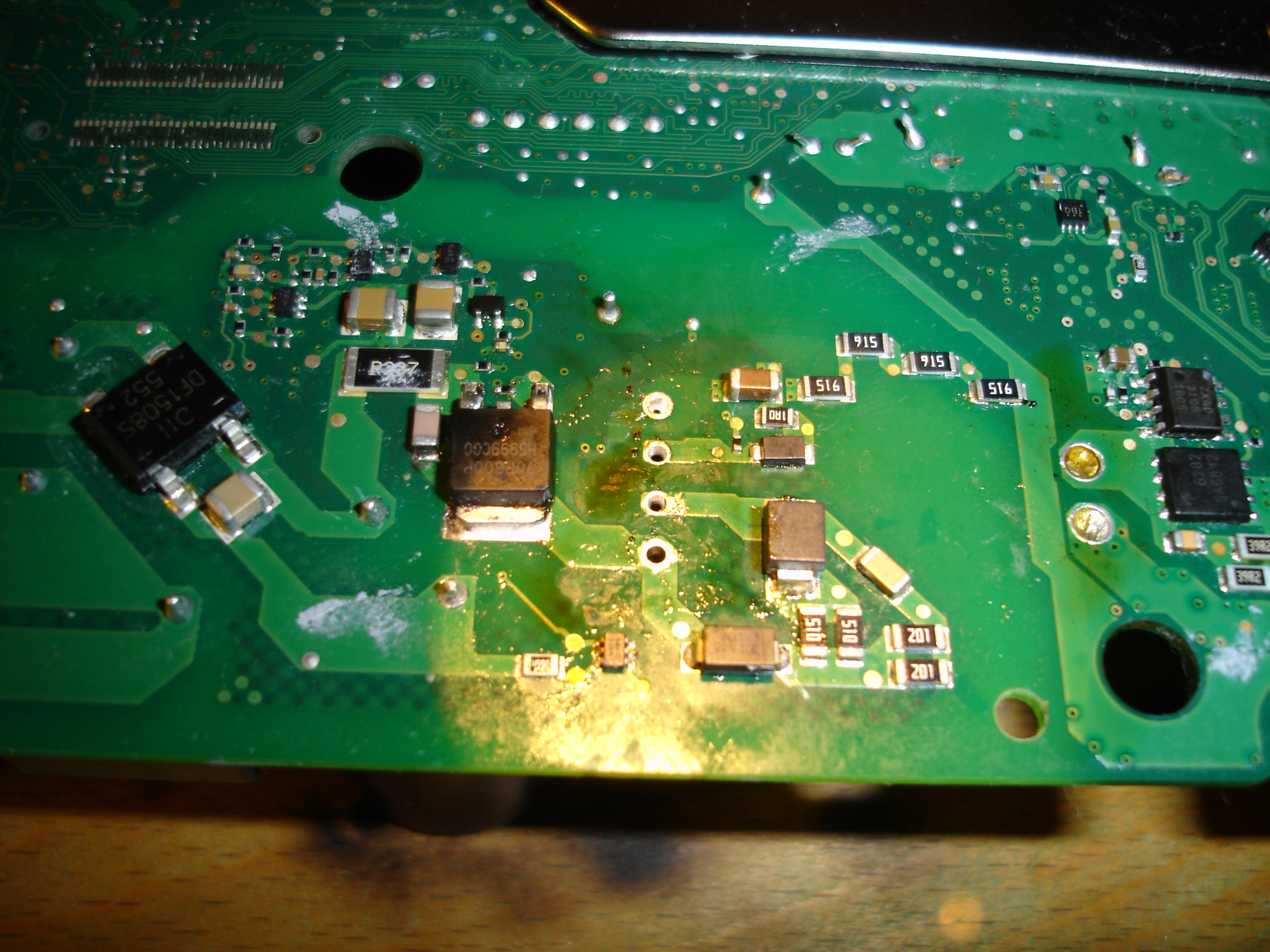

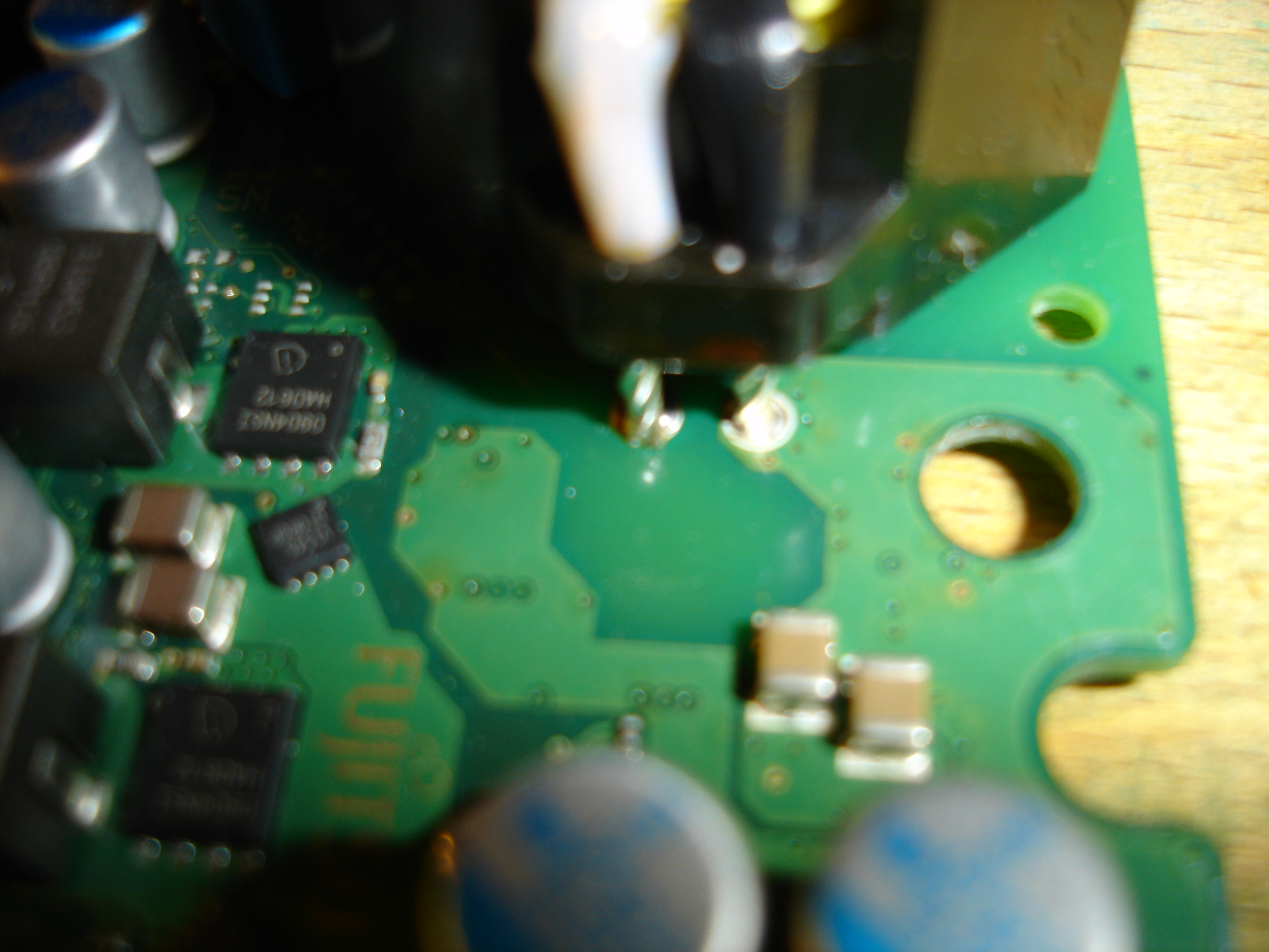

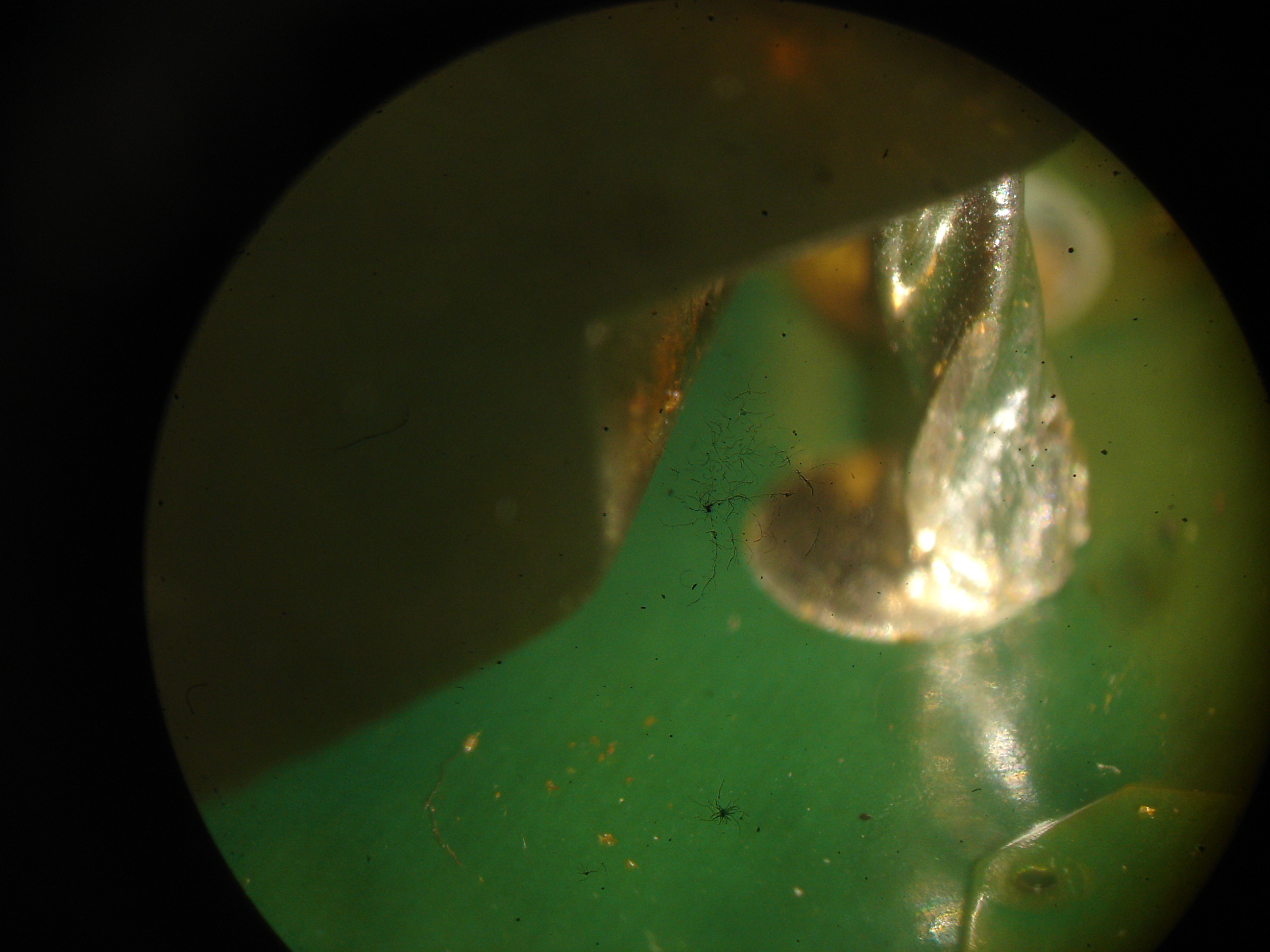

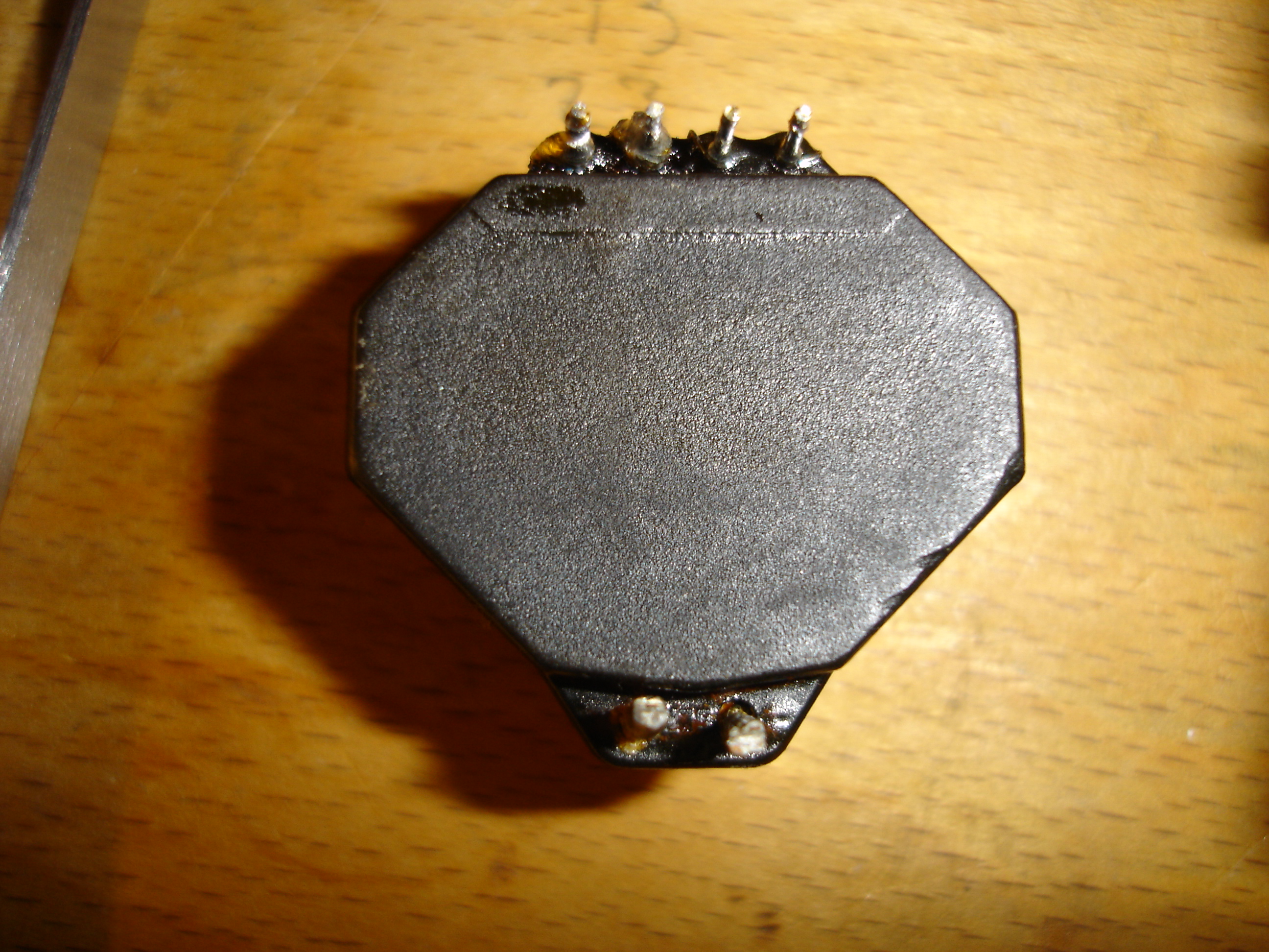

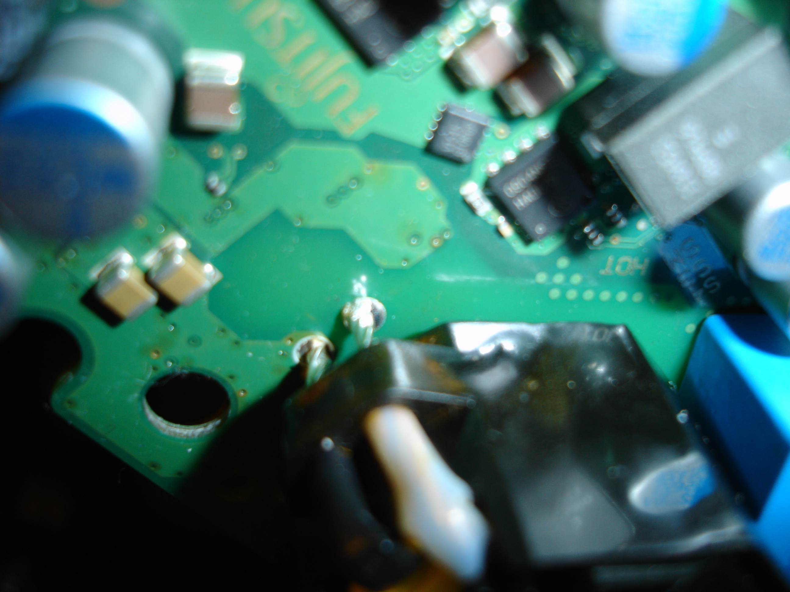

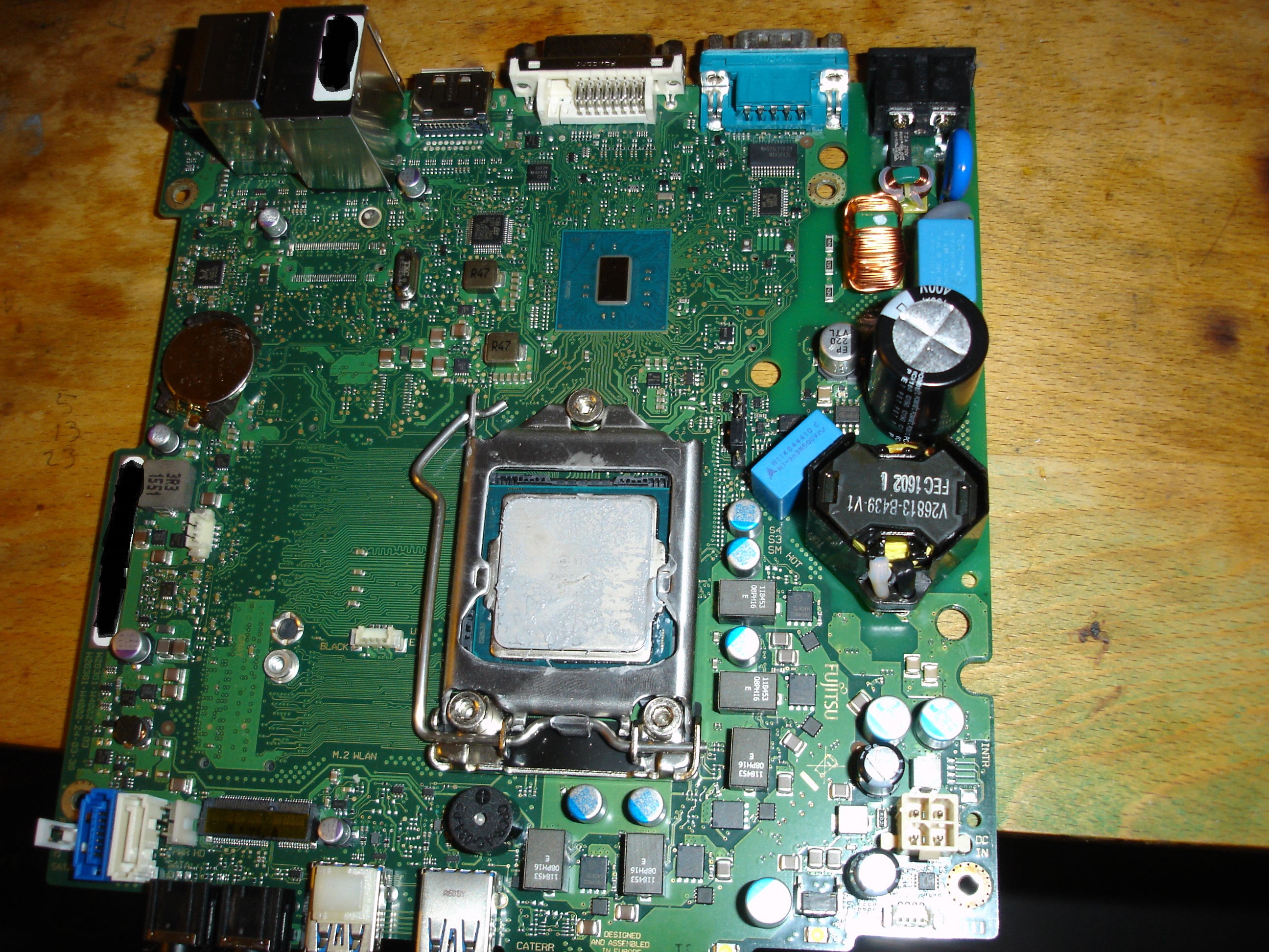

    I had this fujitsu with an intermittent boot, turned out it was the transformer. One of the legs was bent and resting on top of the hole,rather than through it. Eventually the solder cracked and started arcing leading to the intermittent boot.Resoldering fixed it. Quality control
