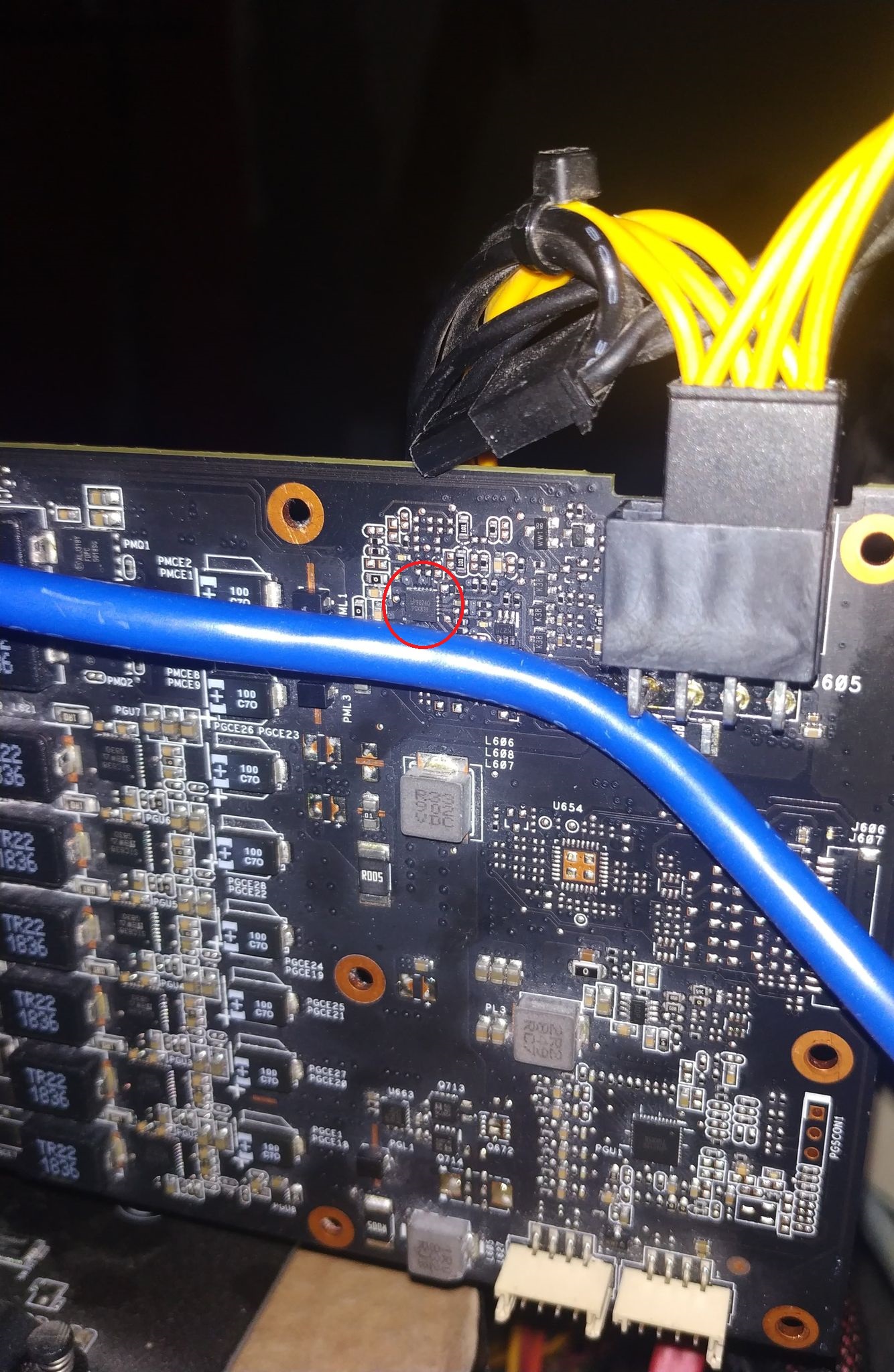

        Hello any one know the name for this part ,
        the repairman told me this part is short.
          Re: RTX 2060 6gb Undetected
          It looks like a multiphase VRM controller but I can't make out the part number from your photo.
          What makes the repair man think that it is 'short'? That is not normally how one of these would fail.

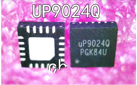

            Hello again ,this is the short part can you tell where can i buy it .
            https://www.guru3d.com/articles-page...-review,4.html
