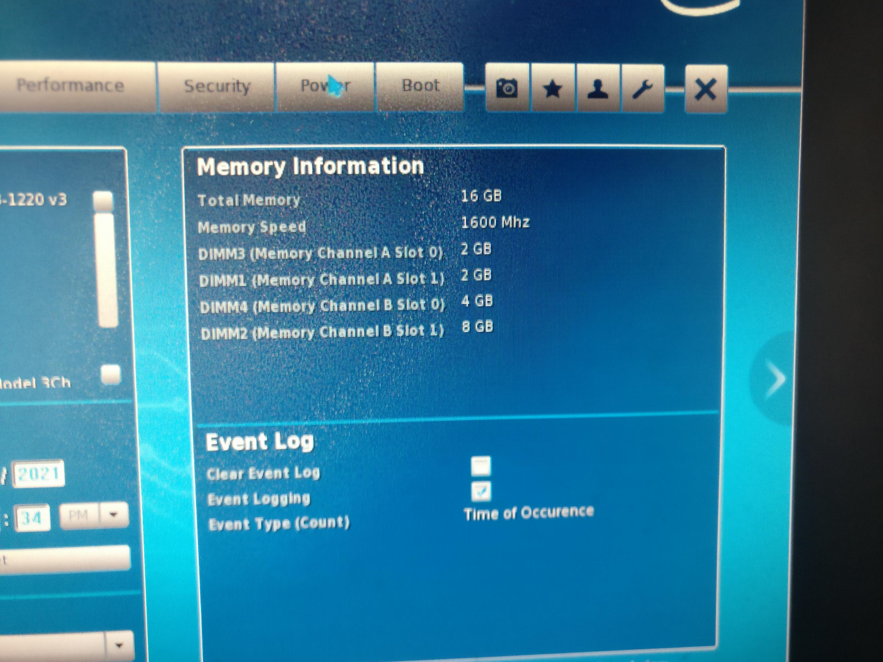

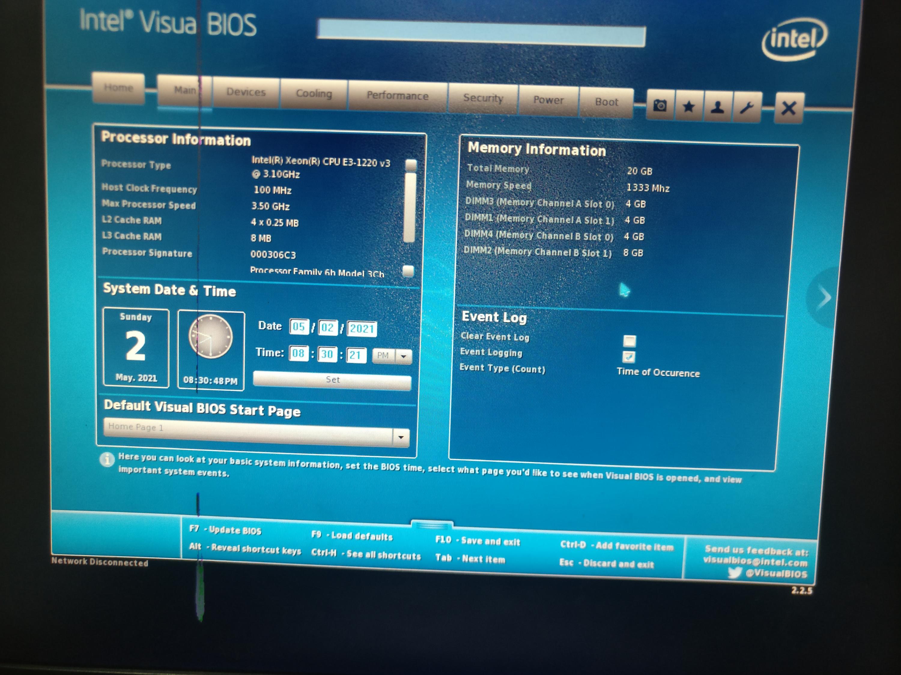

            Re: Intel DH87RL issue with ram slots 1 and 3
            the problem is weird, if I put one ram stick in slot 1 or 3, the motherboard does not recognize the ram stick, I recently did the test by putting ram memories in slots 1 and 3 and the motherboard worked, put all the ram and the motherboard works
            I think that while measuring the ram slots, I did a little force on the pins of the slot, because previously if I put ram sticks in slots 1 and 3 the motherboard would give me 3 beeps
              So the board is working?
              We recall a similar case where the board demanded a specific combination of memory and had to be in a specific order for the ram slots. It seems your board is behaving the same.
              While it is running, update your bios to the latest. This may allow you to use different combinations of memory.
