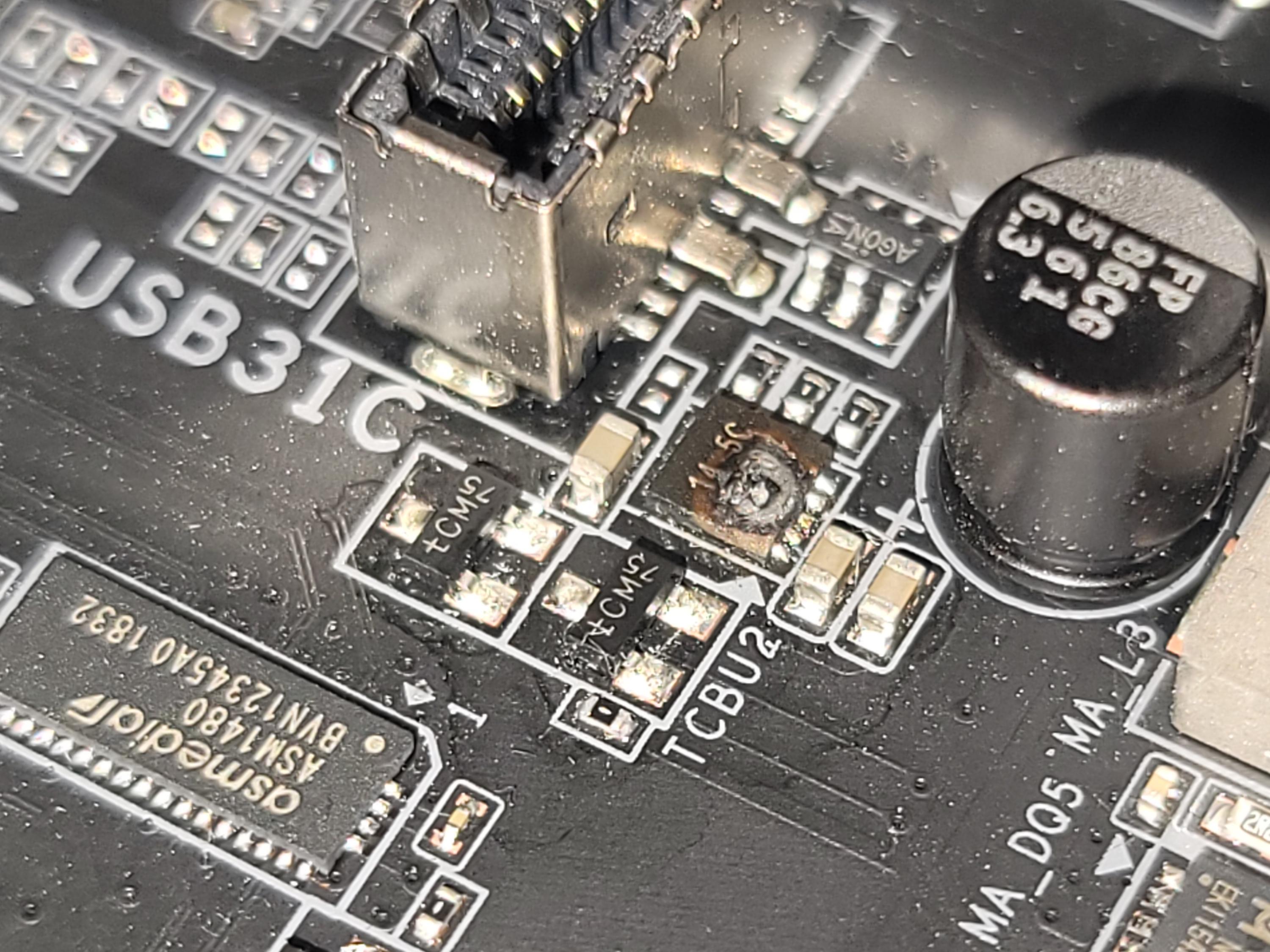

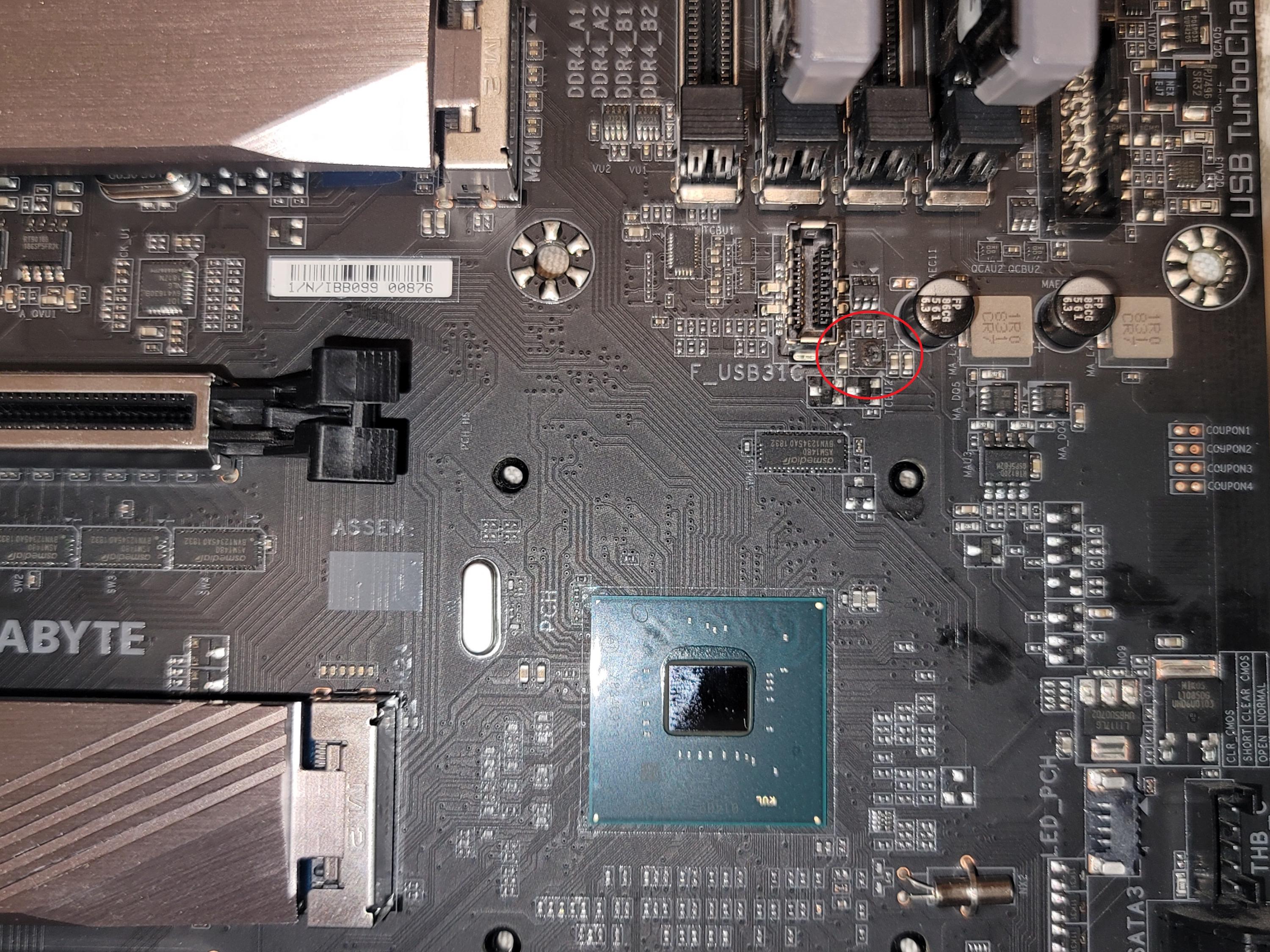

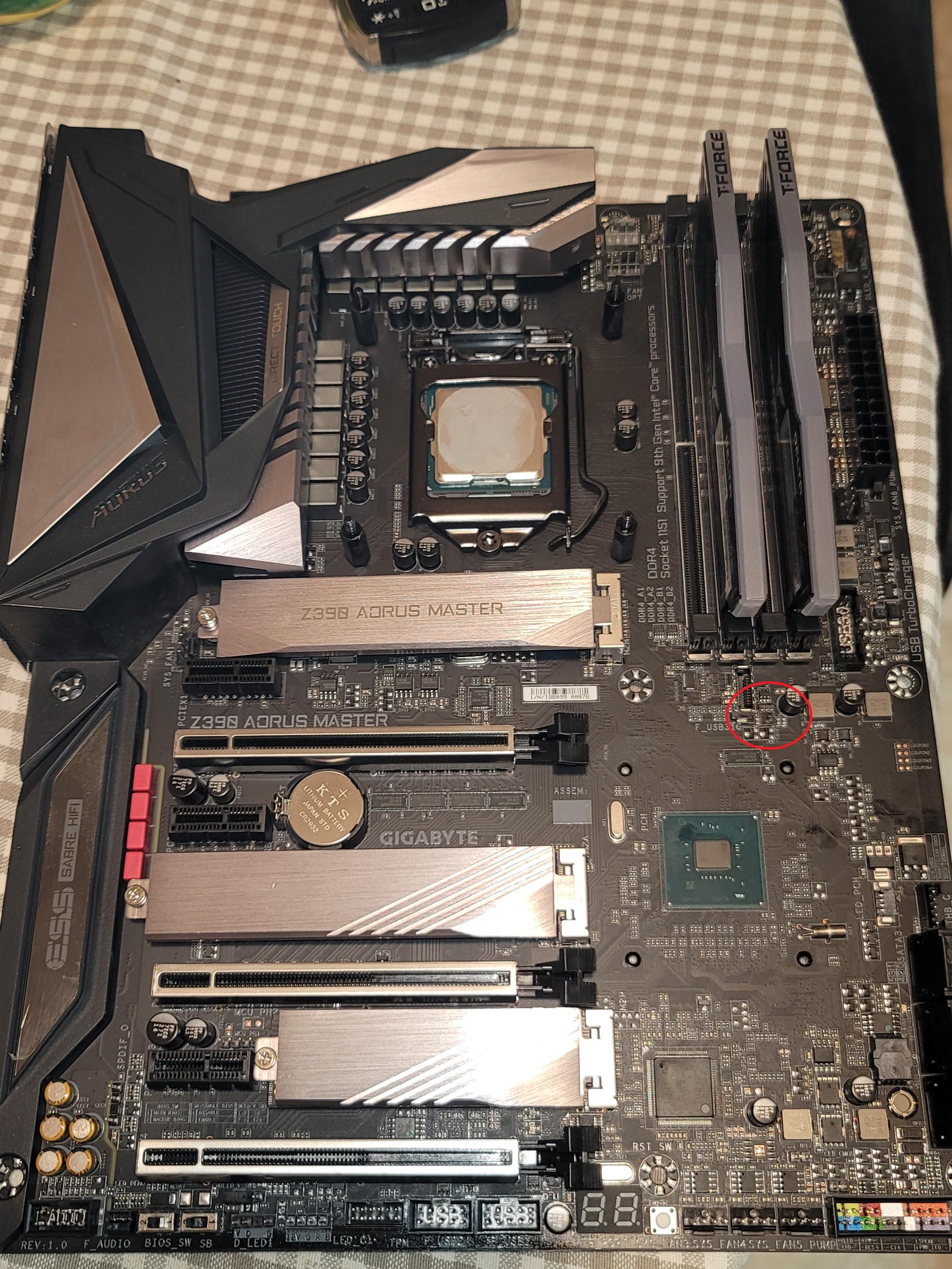

    Hello, today i managed to ruin my motherboard, its a Z390 Aorus Master from Gigabyte, basically what happened is that i wanted to test a videocard that had 2x 8 PCI power pins , so what i wanted to do is power up the machine with 1 power supply for the processor and the motherboard , and one power supply just for the graphics card ( 2x8 pci pins ) , so when i powered on first the Psu for the 2x8 pins , it shorted out a mosfet.
    Ive checked everything with a multimeter and seems fine, also checked the southbridge and its fine , but the problem is i cant read what it writes on the little chip that is burned , the only thing that its readable on the IC is : " 14 5C " , but checked after it and cannot find anything , im guessing its some sort of DC-DC converter or Power supply chip
    The board powers on fine with a graphics card that has got no power pins ( normal graphics card that doesnt need aditional power ) , so the motherboard works fineish ...
    Can someone help me identify that chip, i would really apreciate it.
    I tried to search boardview files but cannot find any for this motherboard ...
    Here are some images of the board and the ic that is burned:
    Thankyou !

    Richtek RT9731AZQW

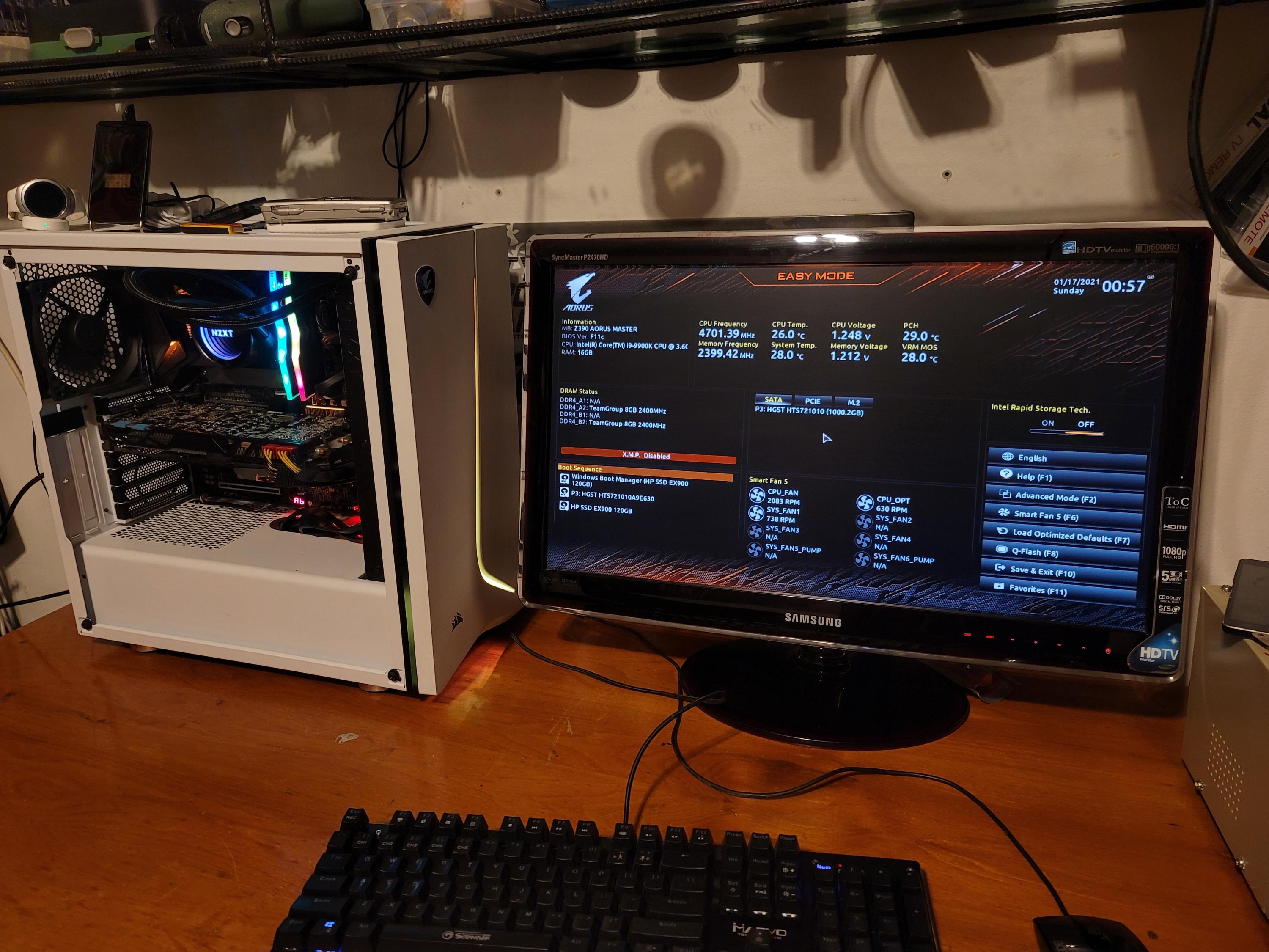

        Confirming repair successful , it was indeed the chip that you suggested , dont know how you knew that was the chip , its still a mistery to me
        But its working perfectly !!!
        Thank you Piernov, you are a genius !!!

          Looks like Richtek markings ( https://www.badcaps.net/forum/showpo...84&postcount=2 ), it's not in the old Richtek Marking Information document but you can search on Google for `Richtek "14 YM"` and the datasheet will show up somewhere in the result, then you just have to confirm the markings and the package in the datasheet match.
