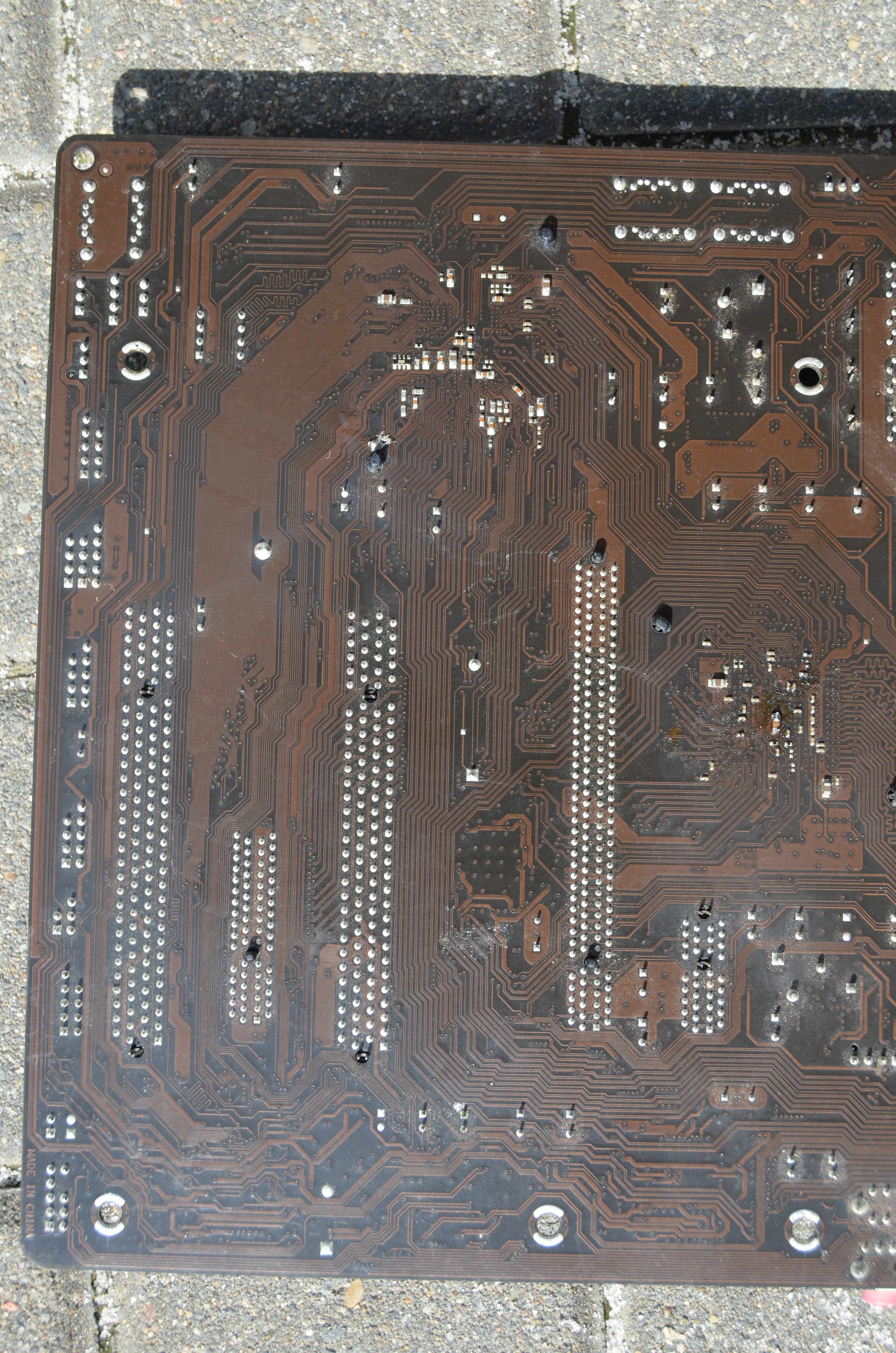

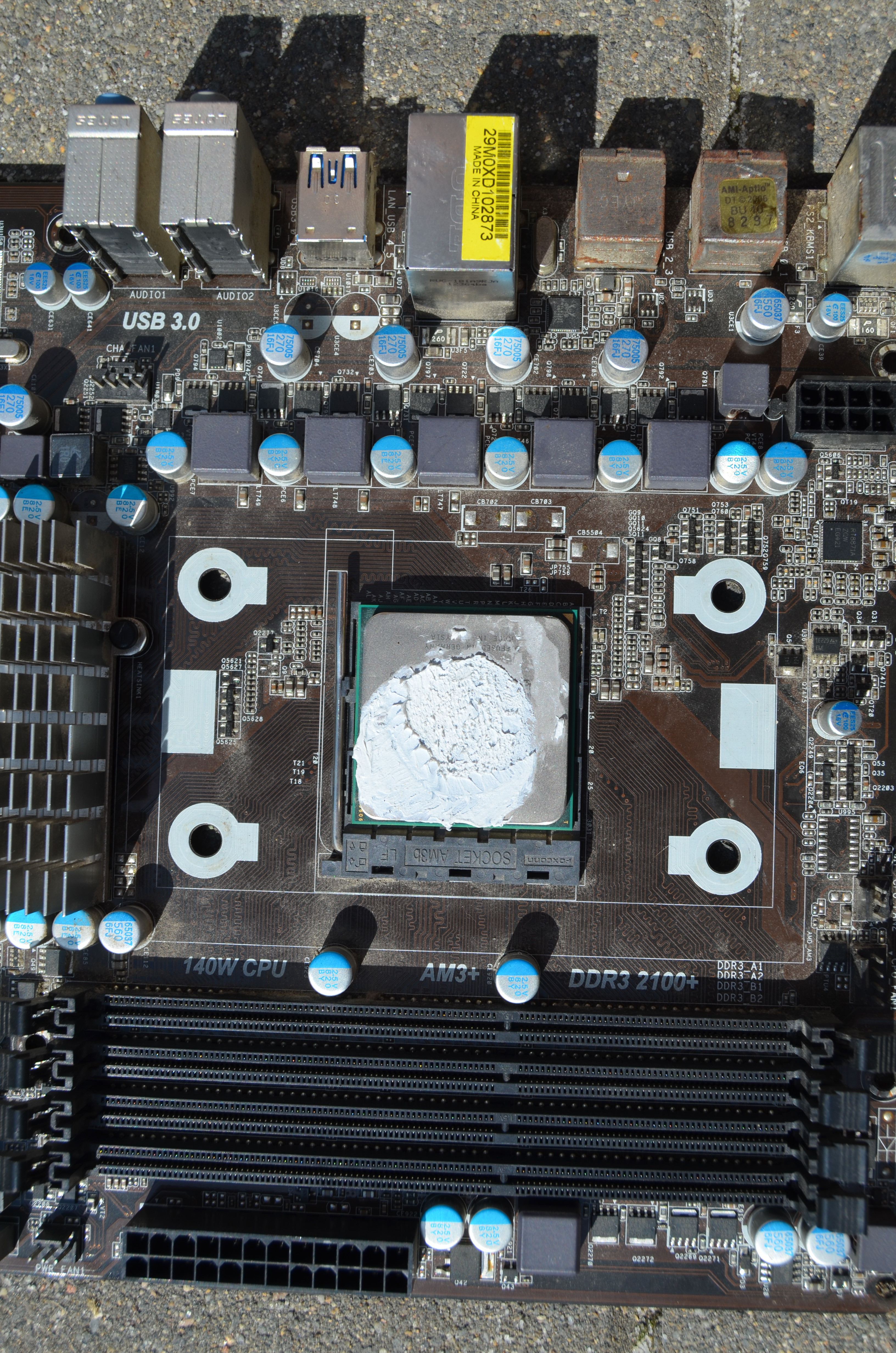

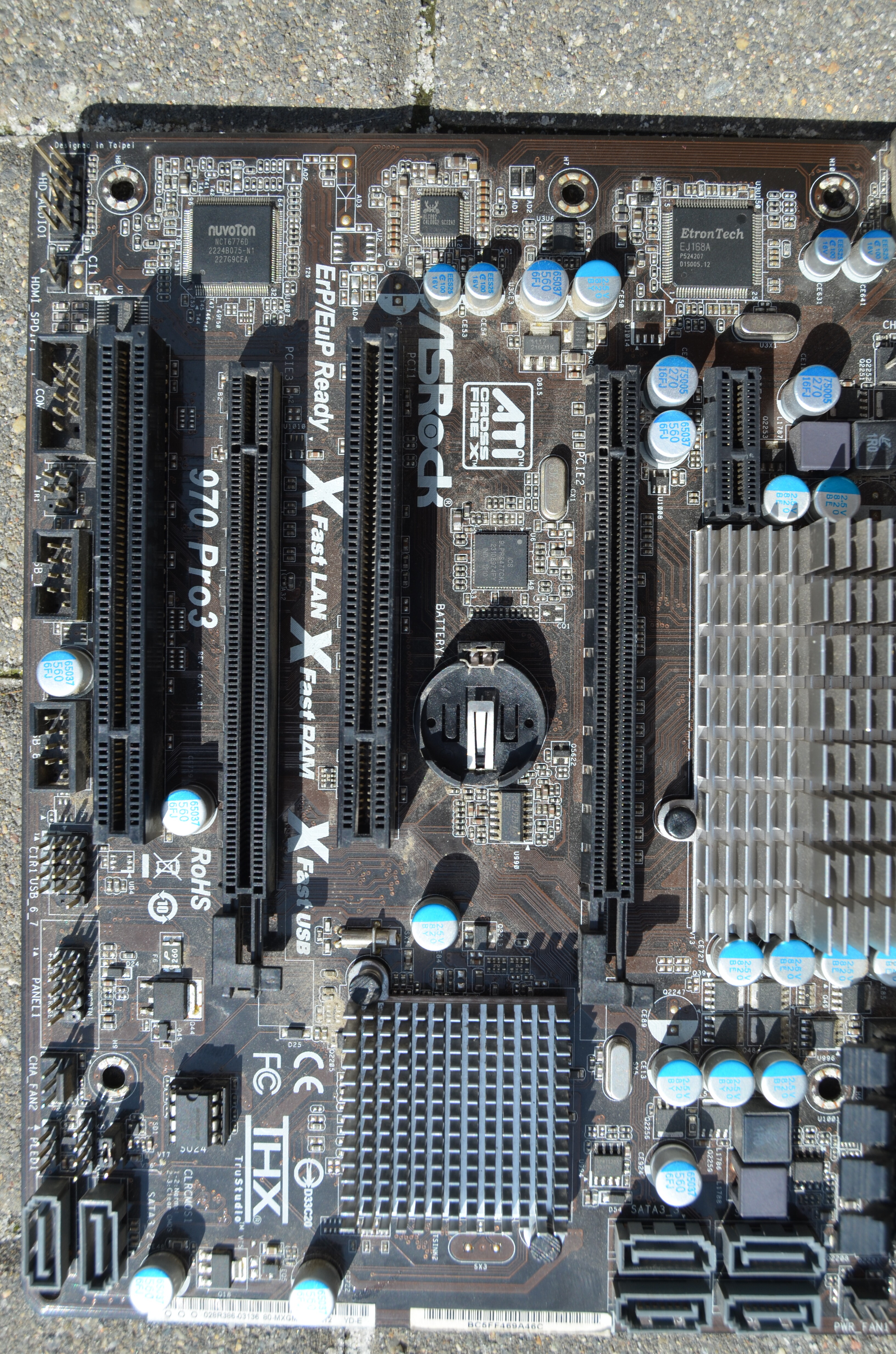

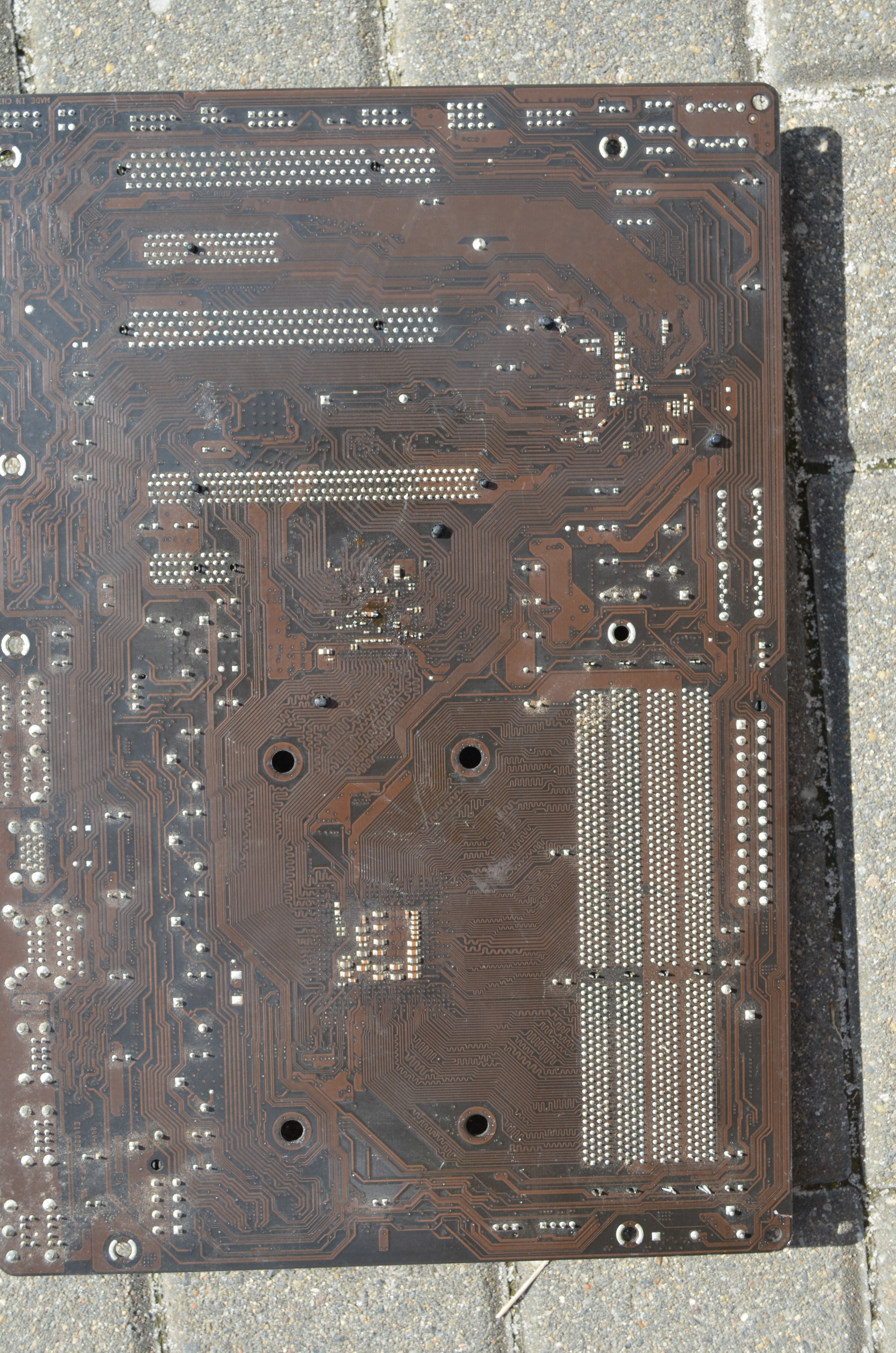

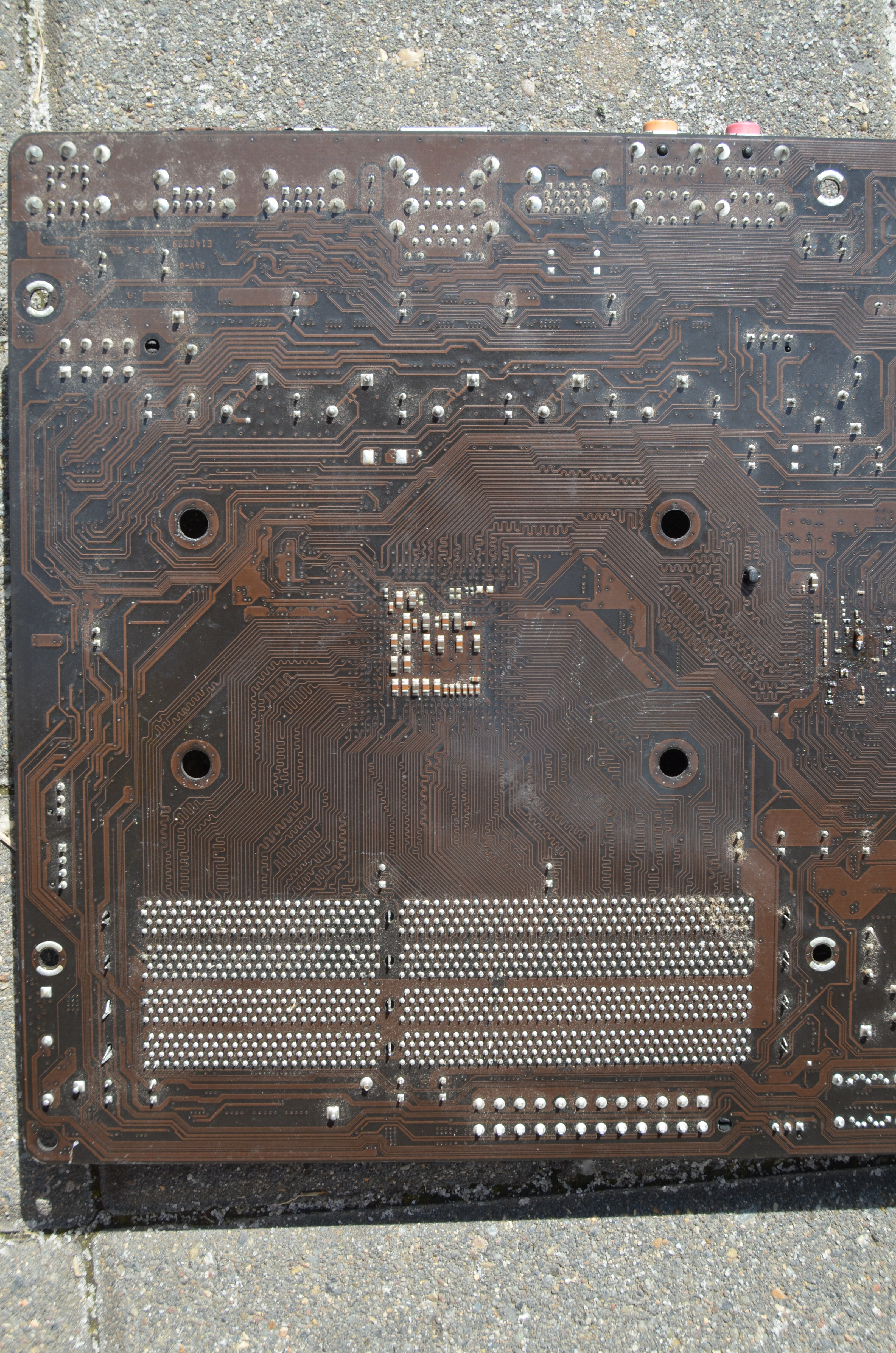

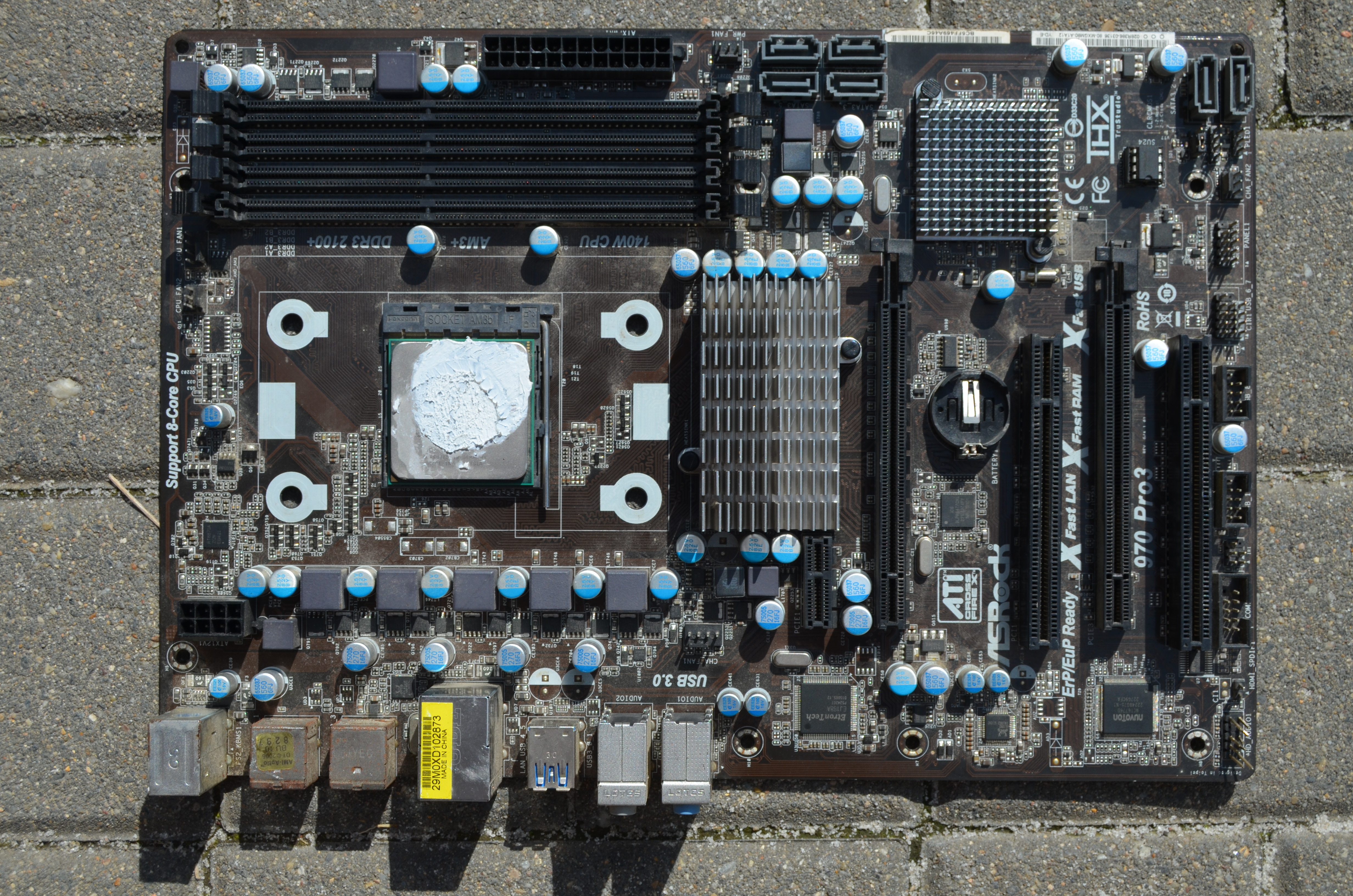

    Recently I got this Asrock 970 PRO3 board from scrap. It had a few missing caps under the NB which I've replaced. Sadly, one of them went short (NC597 from boardview file). I did replace it and there doesn't seem to be any shorts left, but the board is not executing POST nor beep codes. I once got it to POST after I was slightly bending it, but that was only once. I tried to redo the same steps but to no avail. All caps on the backside of NB have 22-ish ohms.
    I have traced the problem to an dead Northbridge VRM. There's no voltage on Phase (pin 8), FB (pin 6), UGATE (pin 2) and LGATE (pin 3). There's VCC and 0.8v on COMP/EN (pin 7). No voltage besides on the tabs of the two MOSFETs.
    I do not know whether it's a shorted NB or dead VRM, so I'd like to ask for help during troubleshooting.
    I have double checked each component and trace for any obvious damage and there wasn't anything that seemed to be damaged. And yes, that trace repair under the SB is crap, but it made the RESET line work correctly now.
