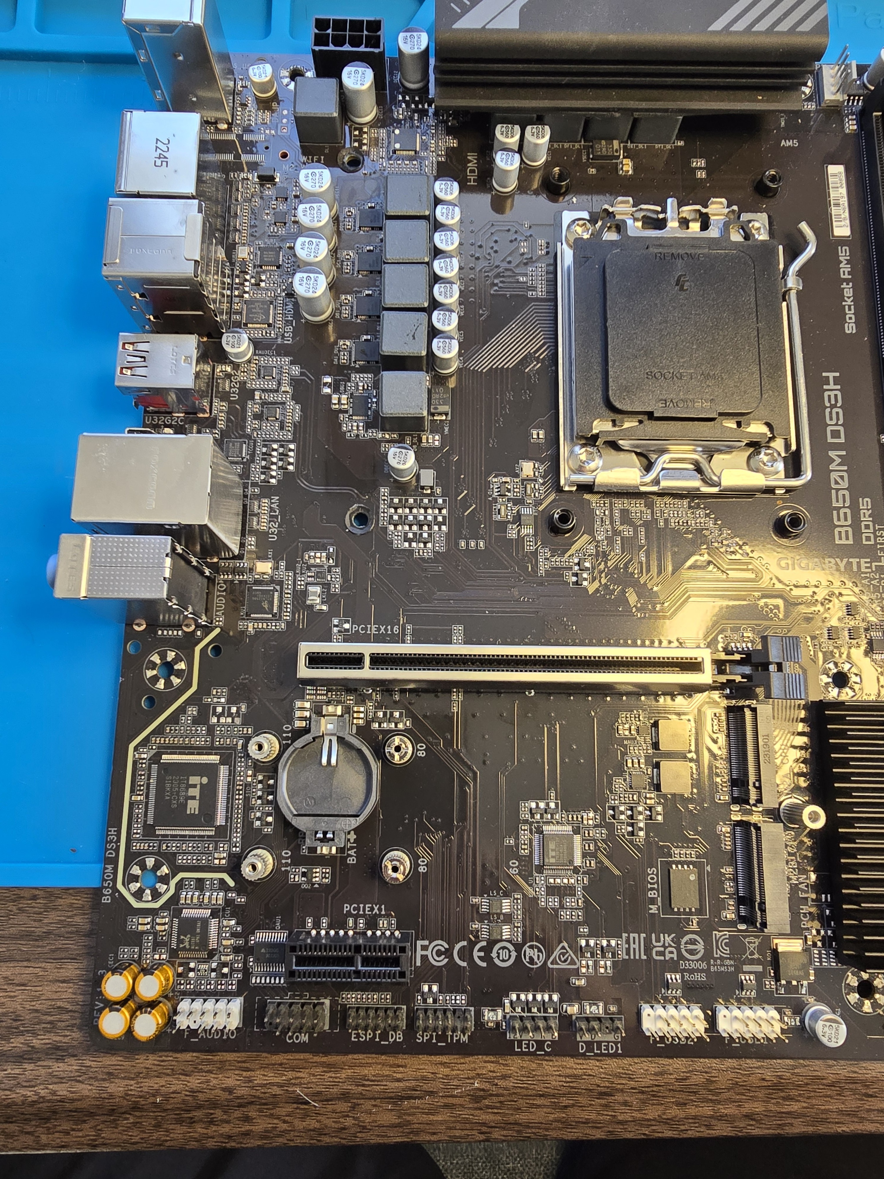

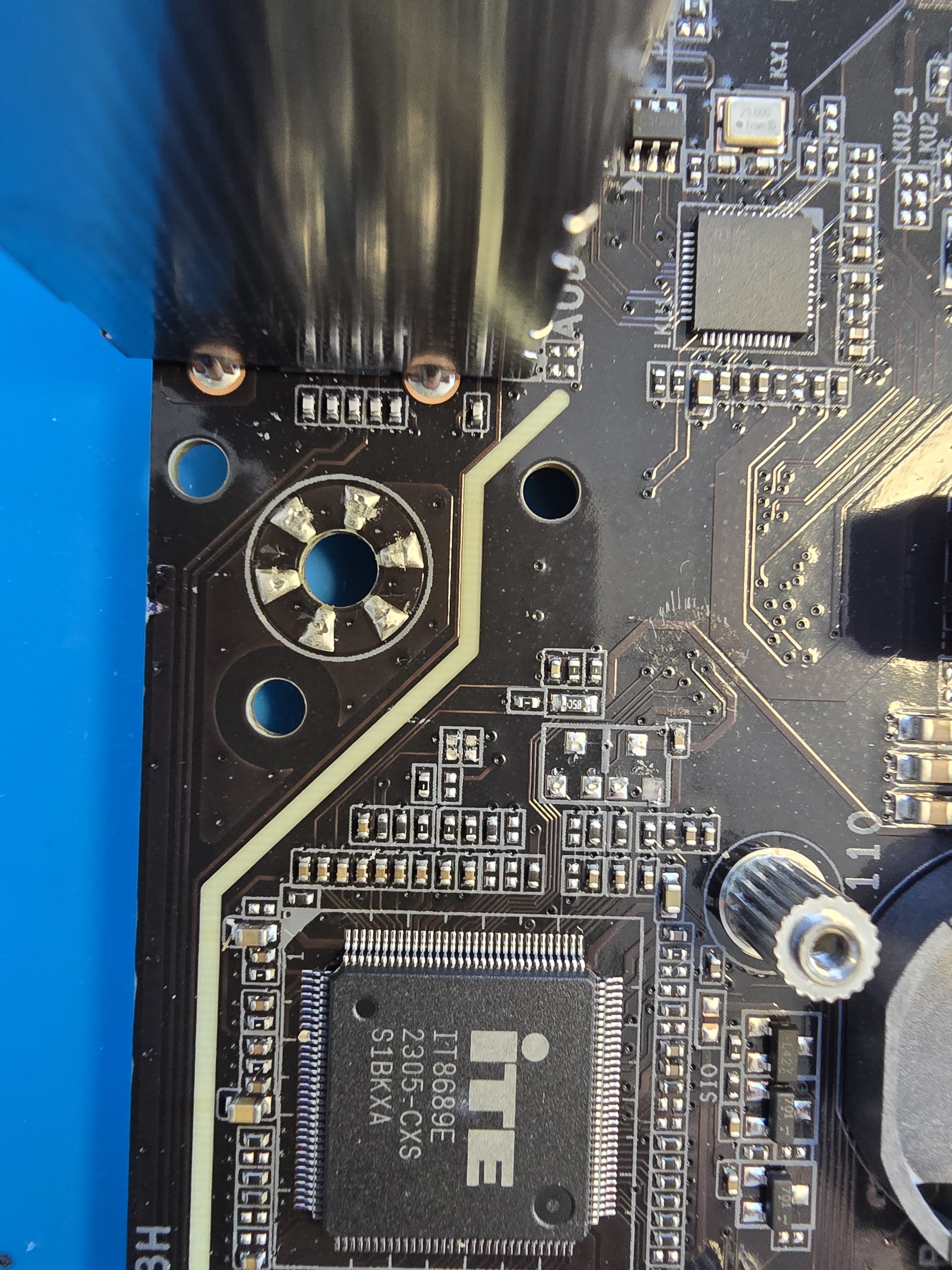

    Would anyone be able to provide me with part information for these missing transistors and capacitors/resistors? A boardview would be great but anything would be helpful.
    Click image for larger version  Name:	20241117_082050.jpg Views:	0 Size:	2.33 MB ID:	3509150 Click image for larger version  Name:	20241117_082056.jpg Views:	0 Size:	2.81 MB ID:	3509151

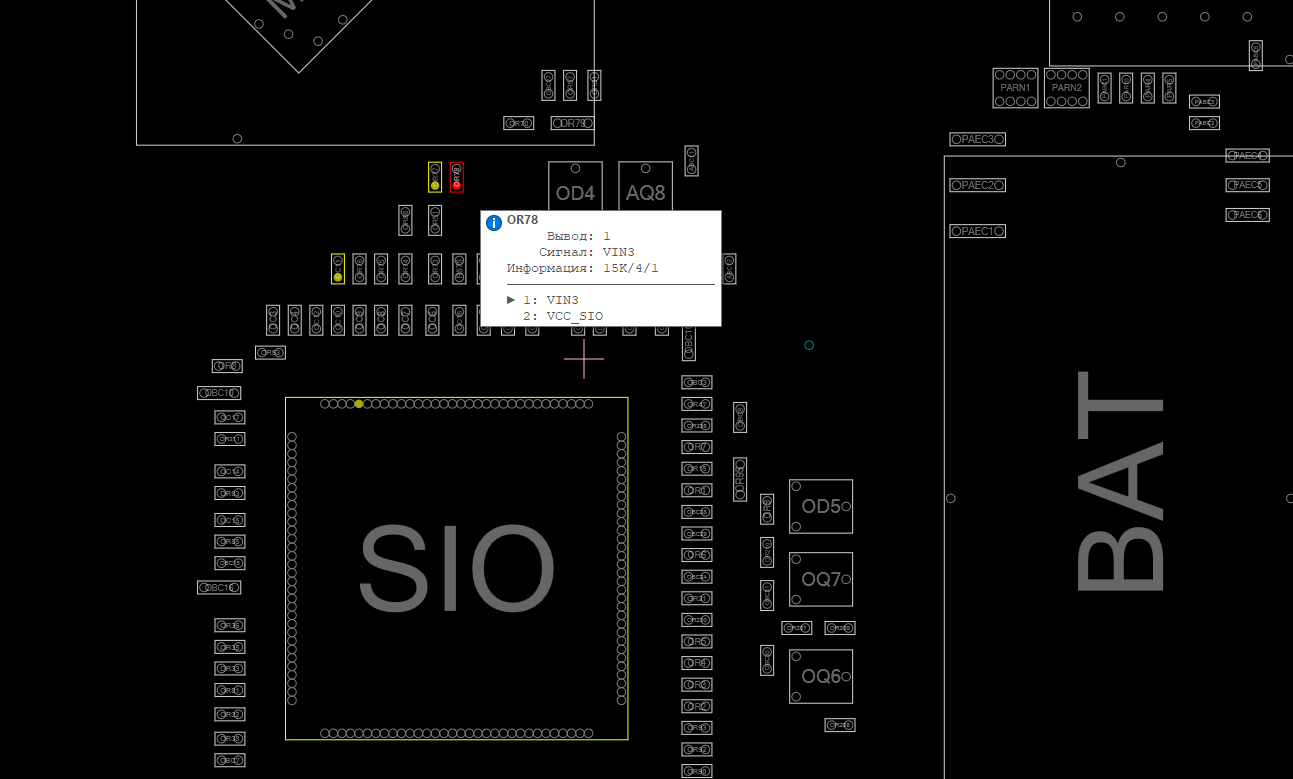

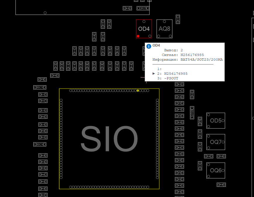

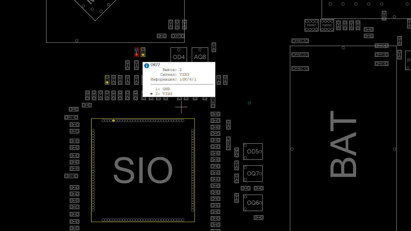

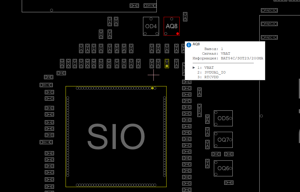

    Resistors 10K, 15K and Schottky diodes BAT54A, BAT54C

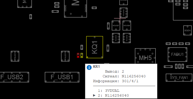

      Could you help me identify the missing part on a similar motherboard?(B650M Gaming X AX) Thank you very much.
      • Rezistor
        • Jun 2021
        • 304
        • USSR
        The resistor is 301 ohms
        • suti88
          • Aug 2016
          • 2
          • Romania
          it works you are the best, thank you.
