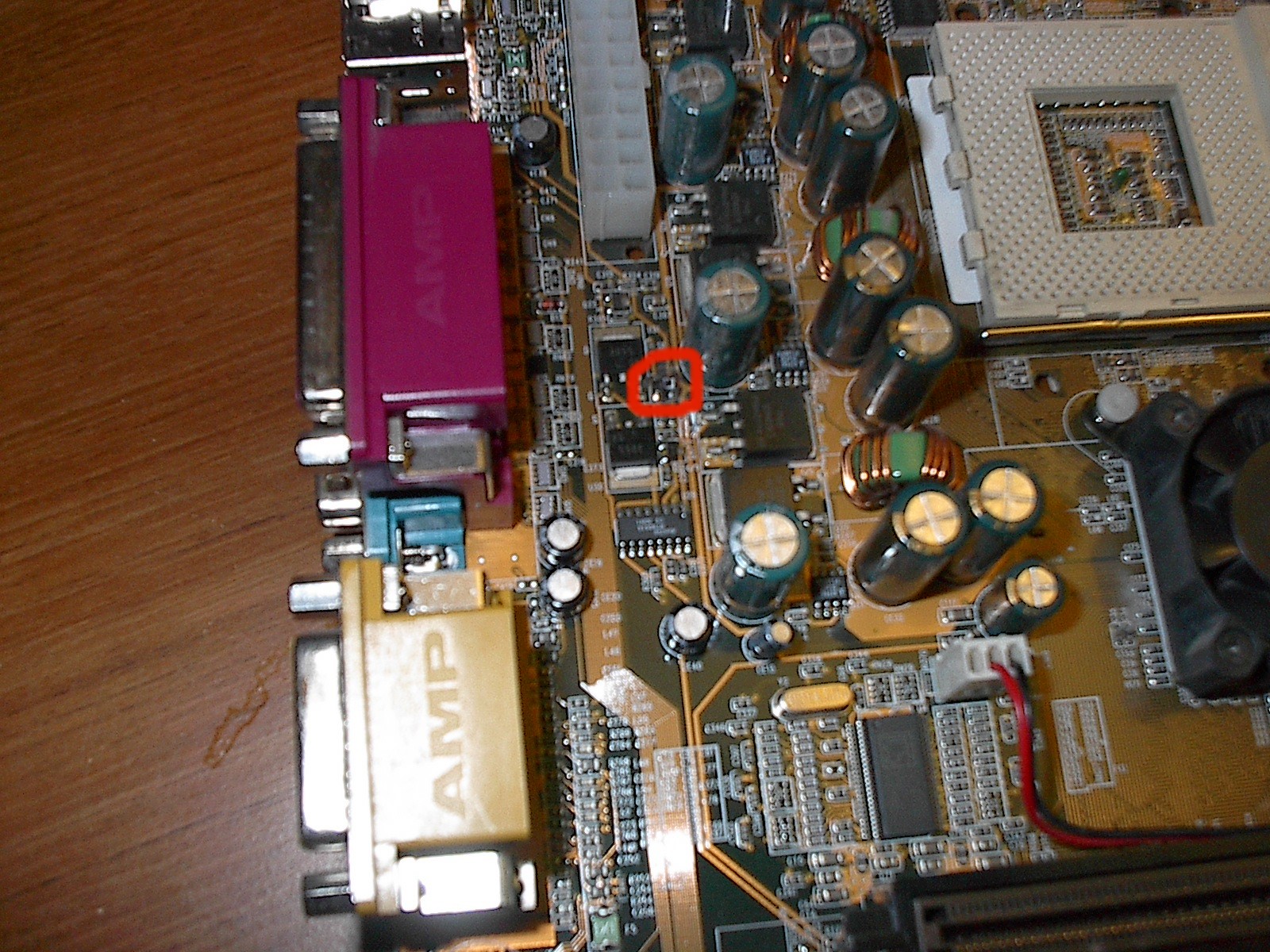

    I have this AK31 board that will not post. I found a blown SMT component on it, but I can't tell what it was.
    I can't get a good picture of it. See the red circle. Darn G-Luxon caps...
    I really liked this board and would like to get it going again. Does anyone here have one that can identify the bad component so I can replace it?

    Looks like a transistor that drives the MOSFET. Check all the MOSFETs, some of them might be shorted.
