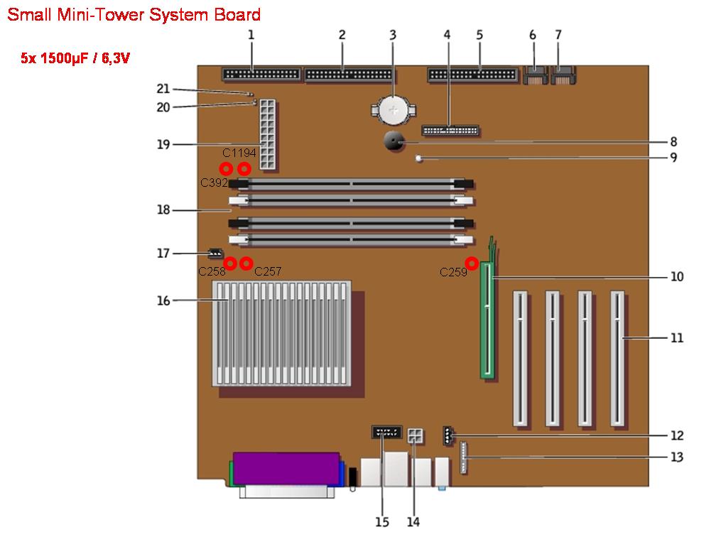

    DELL Optiplex GX270 Small-Mini-Tower
    bought to: 10/2003
    5x 1500uF/6,3V - Gold Service!

    yup, the gx270 systems are common to see with failed capacitors.
    The great capacitor showdown!

      Yes, the problem is generally admits with DELL.
