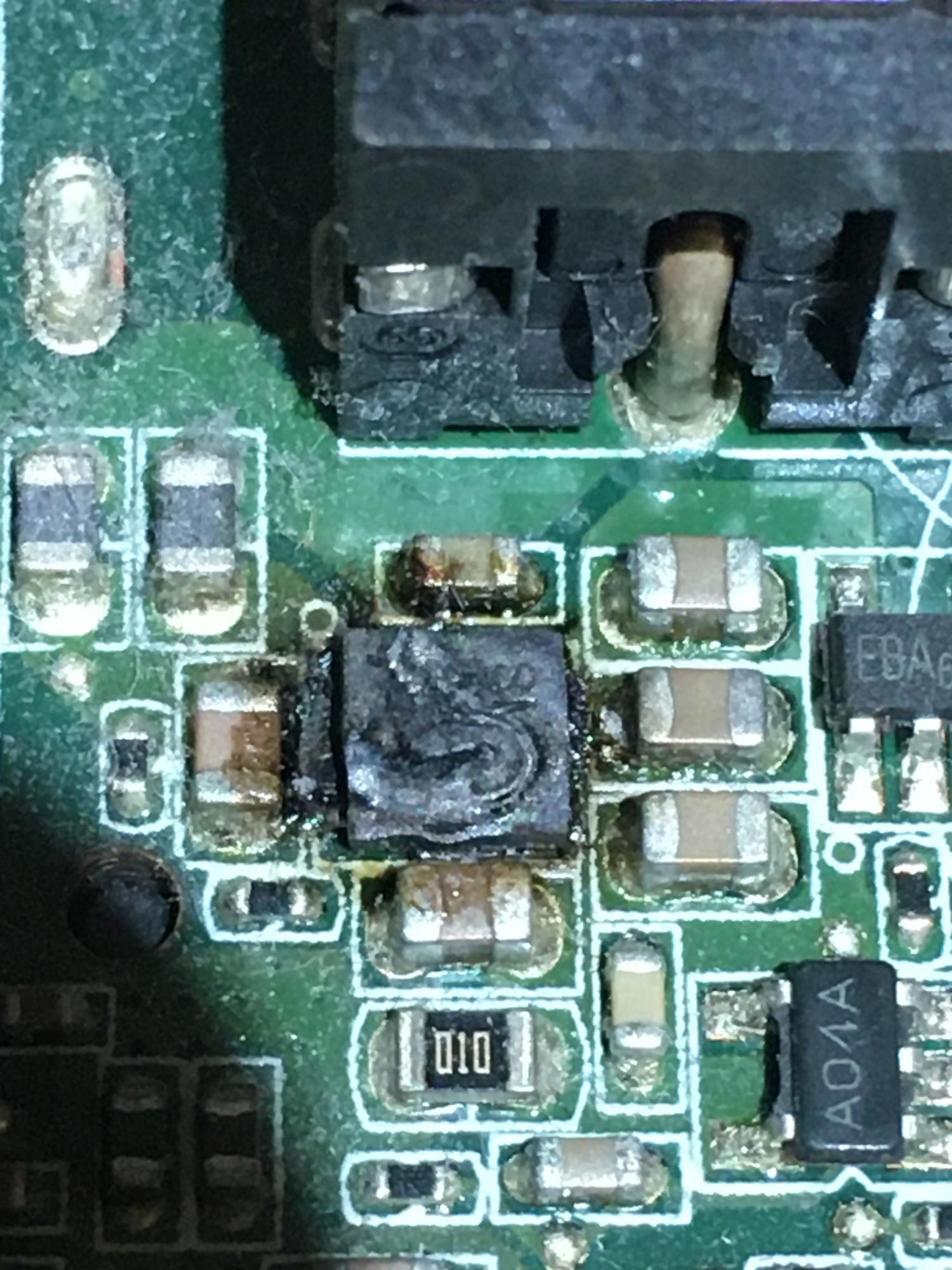

    Good morning.
    Could someone tell me the reference of the burnt IC shown in the photo?
    It is a MiniPC Intel NUC NUC6i5SYB, and it is located just behind the DC power connector.
    Thank you very much.

    I'm still looking for a solution to this problem. Can someone please send a photo of a board where the component is identified or any schematic? Thank you.

      Here's an image of the IC from a working unit. I searched for the ID codes but couldn't find a data sheet, if you work out what it is I'd like to know. I have a unit where this IC has fried itself too. Thanks.

        Loos like a blown input mosfet p type!
        https://www.lcsc.com/datasheet/lcsc_...RG_C207600.pdf

          SM3303PSQG has completely different markings as indicated in the datasheet.
          "J4" could be PE537BA.
