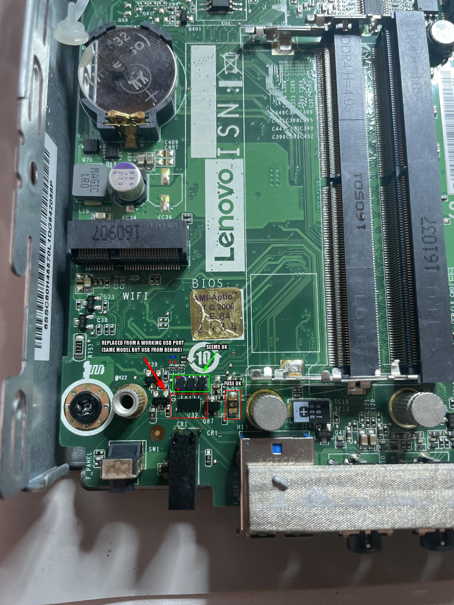

    The first image shows the top of the motherboard. Changing U32 didn't bring any change, 3.0 still works.
    For the green zone I don't know how to properly test this component but in continuity mode each pin is connected to the pin on the other side. For the comparison on a USB which works it is exactly the same thing so I consider that everything is OK at this level.
    The fuse works and sounds good in continuity mode.

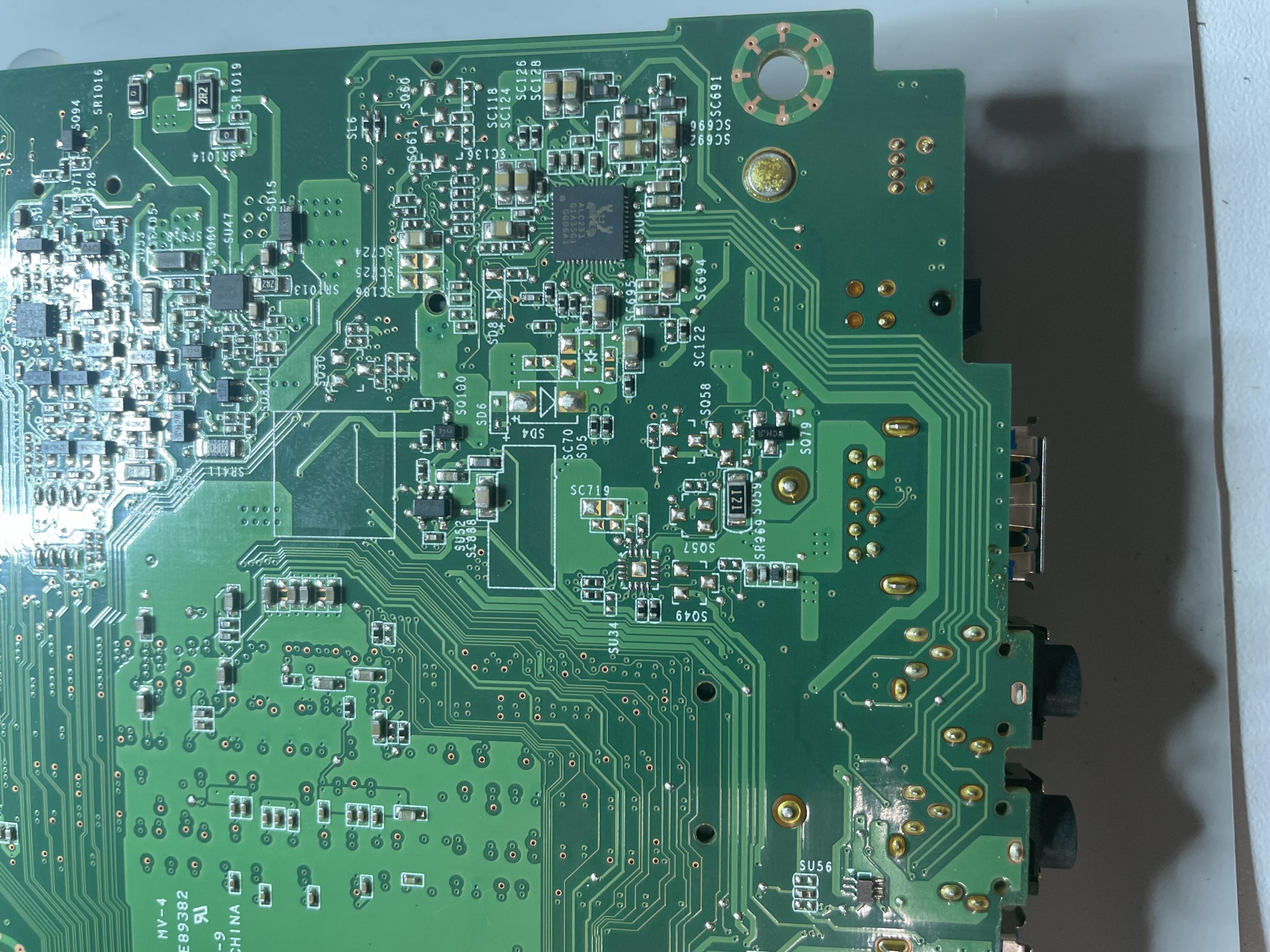

    The second photo shows the underside of the motherboard.
    On the USB pins apart from the ground pins nothing sounds in continuity mode.

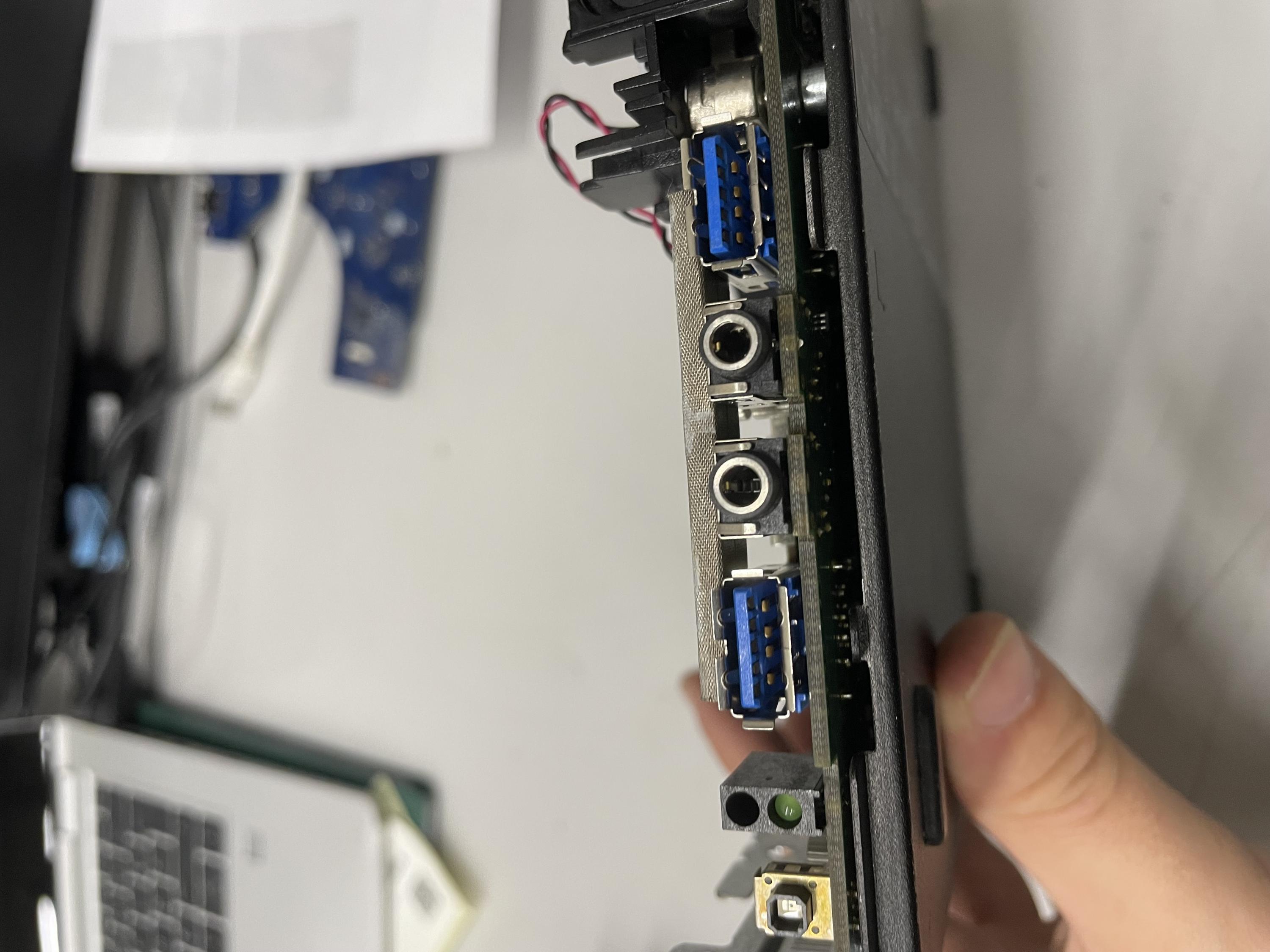

    3rd photo shows the overall status of the USB.

      Highly recommend a Chipmunk USB tester if you can afford it. Tells you pretty quick what is going on. And the connections are exposed so you can just meter things while in situ.
      Anyway, USB ports often go directly to the PCH without any protection other than an inline choke on the data lines. Sometimes you get lucky and it's either a connector or an open choke, but its often one of the data lines is damaged. Only solution usually is the PCH would have to be replaced. You buy a USB hub in that case or just live with it. Upload a link to the schematic and I can take a look.

        Indeed, the D+ and D- lines are probably directly linked to the PCH but what I can't really understand is why there are so many of these machines which have exactly the same failure only on USB 1 while the USB port appears to be in very good condition on these machines.
