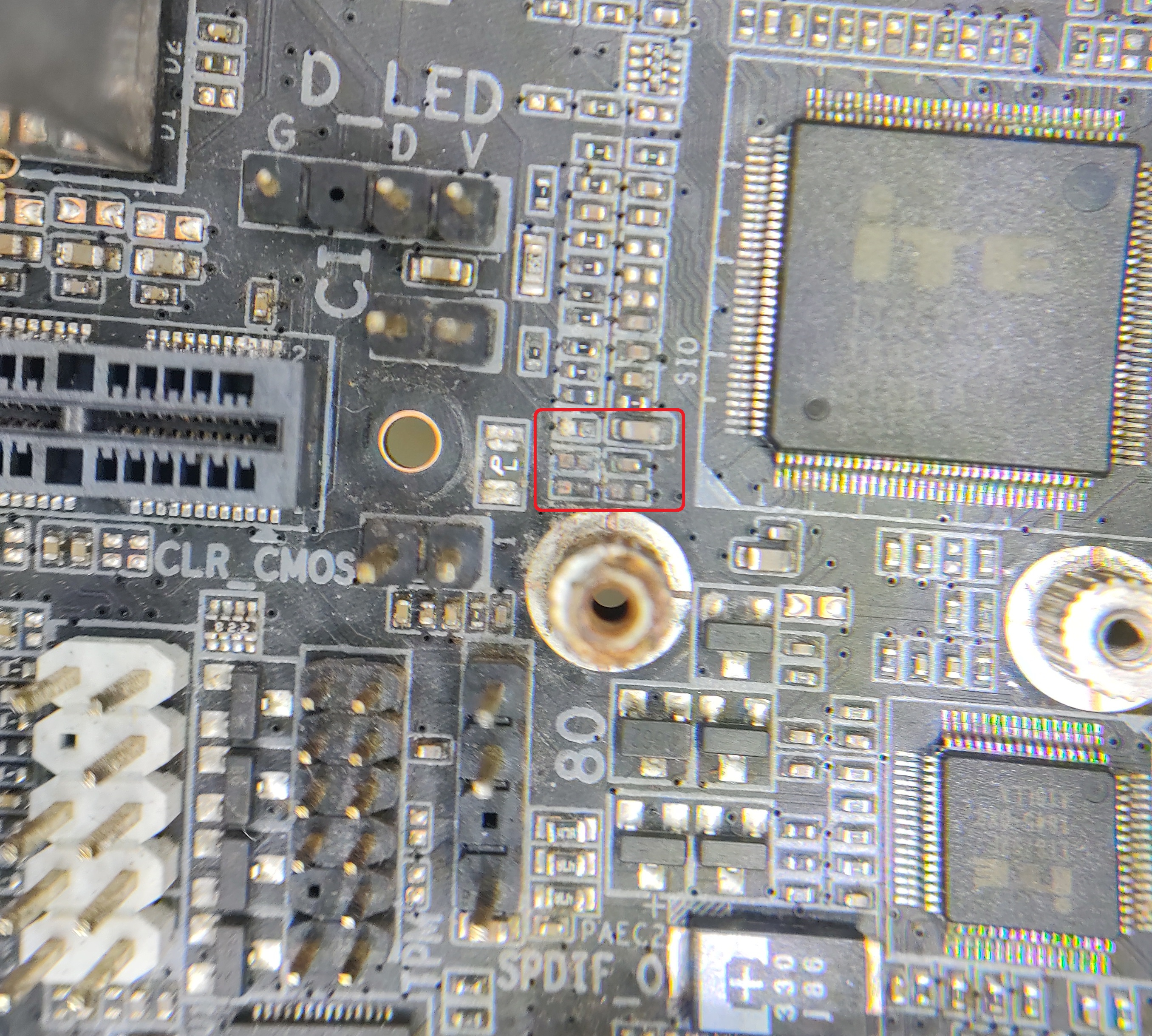

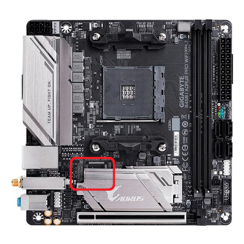

    Hello, I have this board which was damaged with water or something close to it, fell on the SSD and this area underneath, caused oxidation, then 4 components fell, I know two of them, but don't know where should they go.
    One is a 10k resistor, the other is a 1uF ceramic cap(quite rare for this size).
    I can't find high res pictures of the board to see these tiny 0406, I think I would need someone else with this board or some identical circuit, the chip near is the IT8686E.

    I did it by myself, I used 1uF capacitors and 10k resitors, plus cleaning the entire board and resoldering other parts, the voltage readouts are normal, it's now working.
