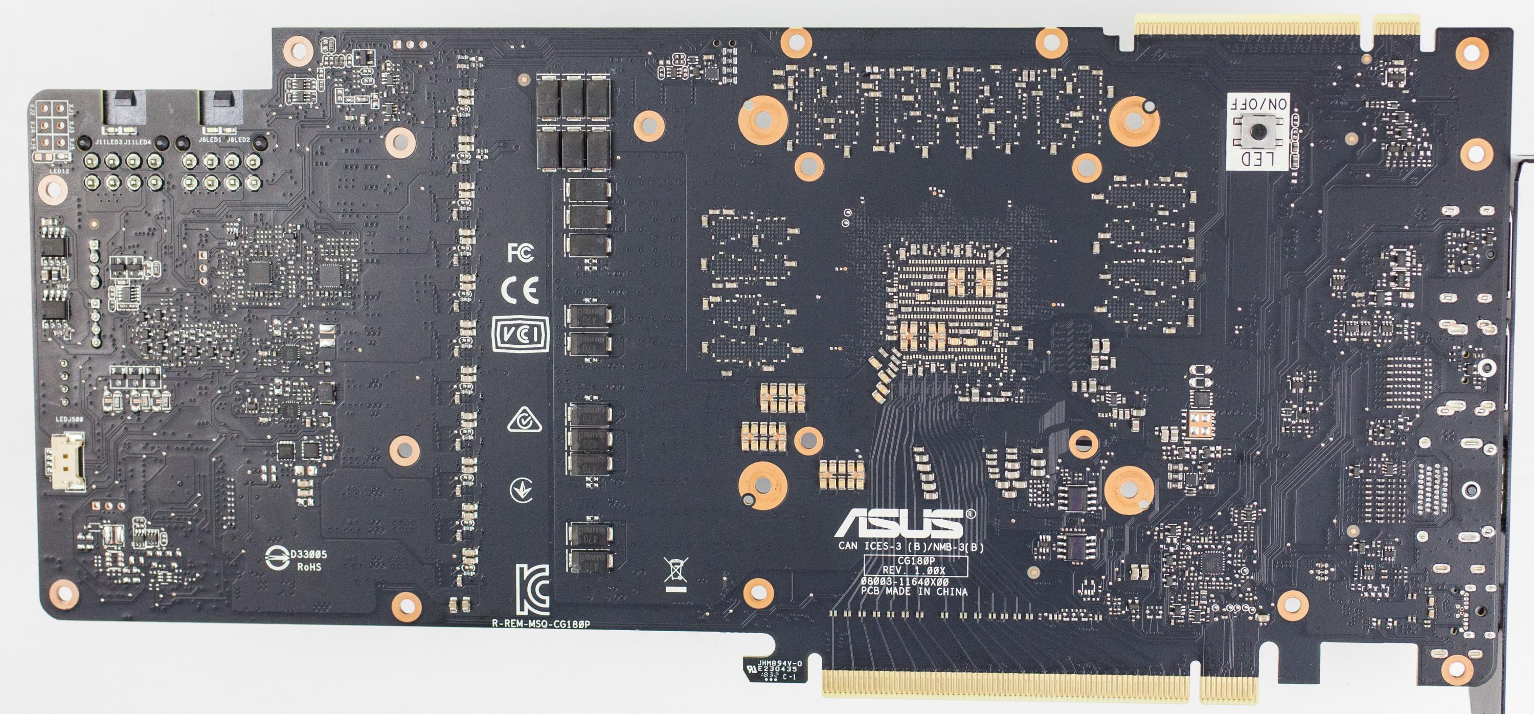

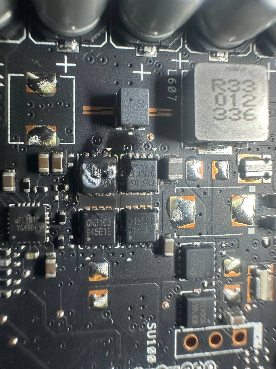

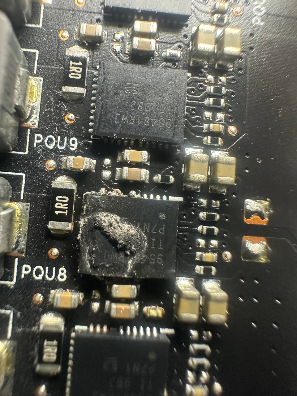

    Hi, my video card has these problems, obviously I bought the new components, I noticed a short circuit behind the gpu but it's probably because my multimeter doesn't read such low resistances. Does this board have fuses? because I can't find them and it seems very strange. Thanks

    Do you have a picture of the full board?
    Also, does your multimeter have a resistance mode?

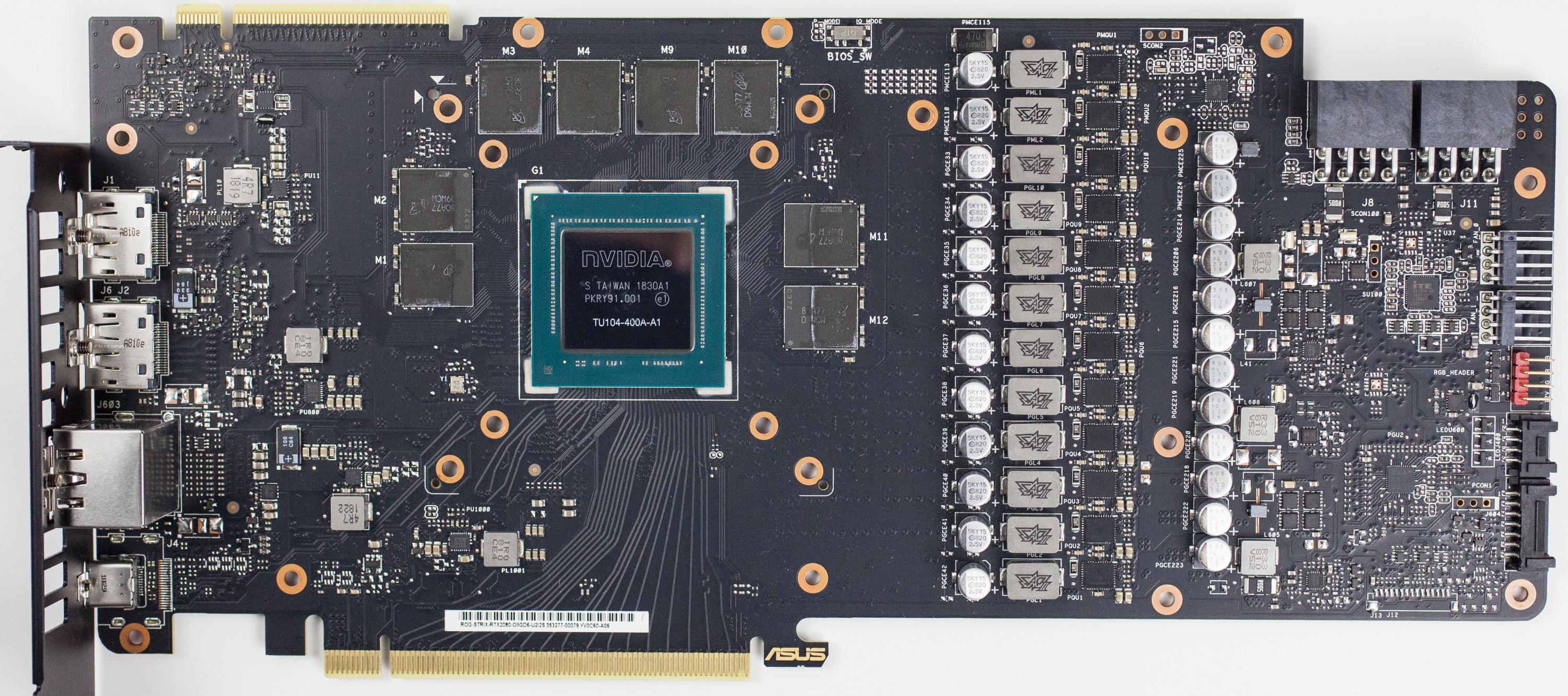

      Re: Rtx strix 2080 oc 8gb
      now i don't have the picture, but i found this picture online

        Ok. Start by measuring the two current sense resistors (located right below the 8 pin power inputs). Red probe on ground.
        You can identify them by the marking R005. Check in both continuity/diode mode and resistance mode. Report the readings here.
        Also what is the issue with the card other than the few components that blew up?
        No power? No video?

          No videos. The lights and fans work.
          Now I've removed the burnt components, I'm waiting for the new ones.
          unfortunately I can't measure it because they are too low, however they sound.
          okay, i tried now, 5 mOhms
