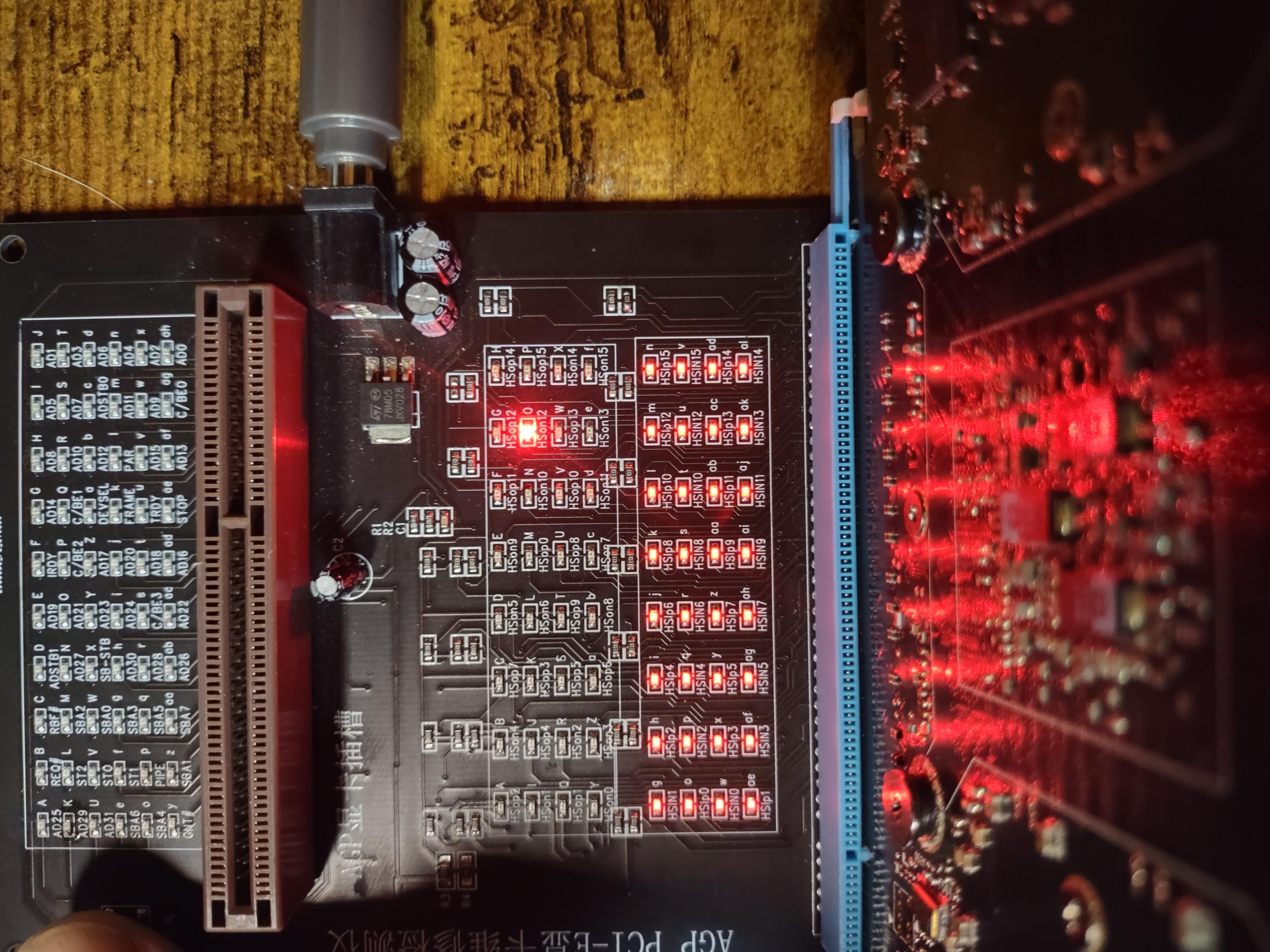

    any help would be greatly appreciated..I was gifted a Nvidia GeForce GTX Titan x from a friend...the issue is the card will boot ,will accept drivers run just fine ...but will crash in furmark unless I uncheck full screen and drop settings all the down in afterburner except power stays the same ..if I do that it will run just fine besides temps gets up to around 79 c...I cannot find any useful info or schematics...also I just bought a pcie tester for gpu's it works fine on a good card but I tested this one and here are the results I cannot find info on the tester either..thank you for anyones help.after doing more testing..will run in heaven,valley,and play PUBG with ultra settings as long as afterburner settings dropped all the way besides power stays the same

    Doing some more testing..no artifacts at all..I can bump up core clock and memory clock with no issues on furmark..as long as I keep power level at 100 percent..if I move up power it will crash within a couple seconds..

      After being up all night testing..when in windows it's fine..the only issue I have now is that I have to turn core clock down on afterburner to at least -25 mhz to get furmark to start testing..once it starts I can move it with now issues..does any body know why I would have to back down core clock in the beginning of stress test but can move it up with no issues..I don't have any experience with a older gpu with as much memory as this one...any help is appreciated..thank you
