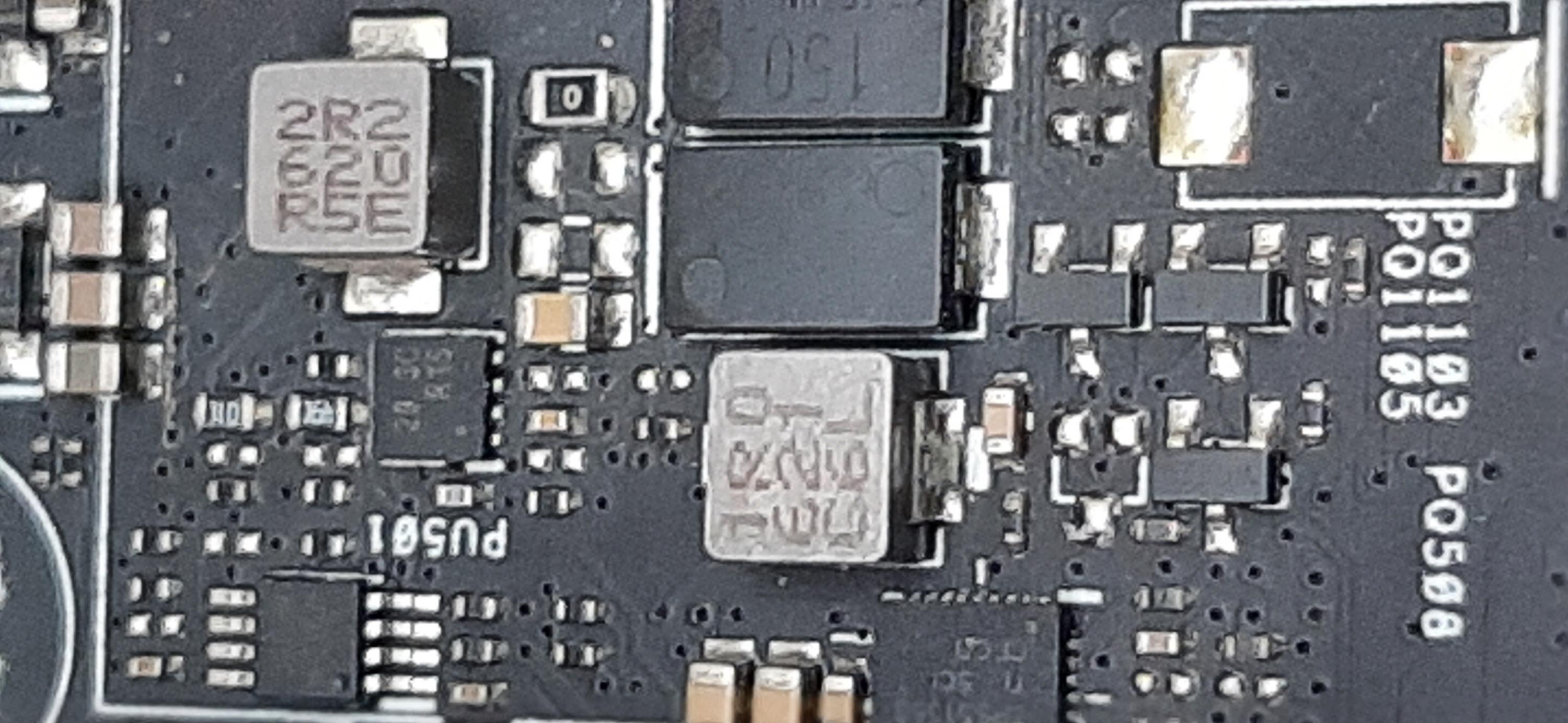

    Hi!
    I would need a type for PU501 for the mainboard in the title. Running extremely hot after seconds. Board try cyclic to start.
    thx

    Re: asus rampage v edition 10
    Pu501, sorry
      type for PU501,and his name is ?
        yes the type, so I can order new one
          Can we have some pictures, can we see the markings on top of the chip .

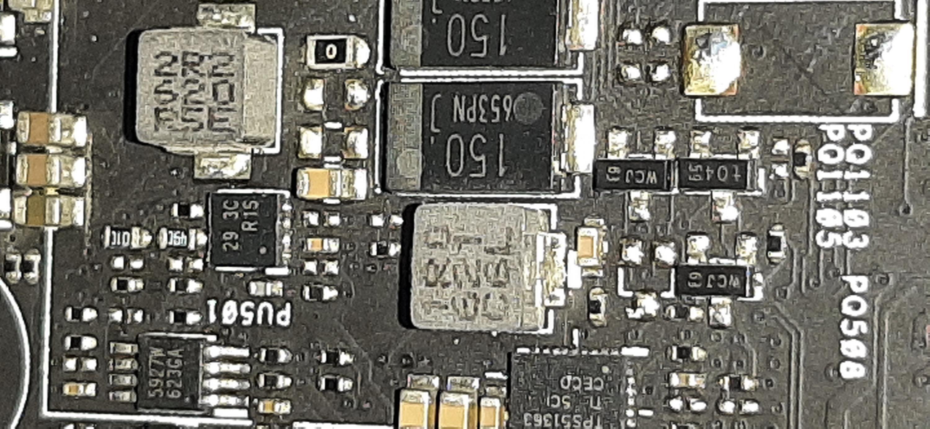

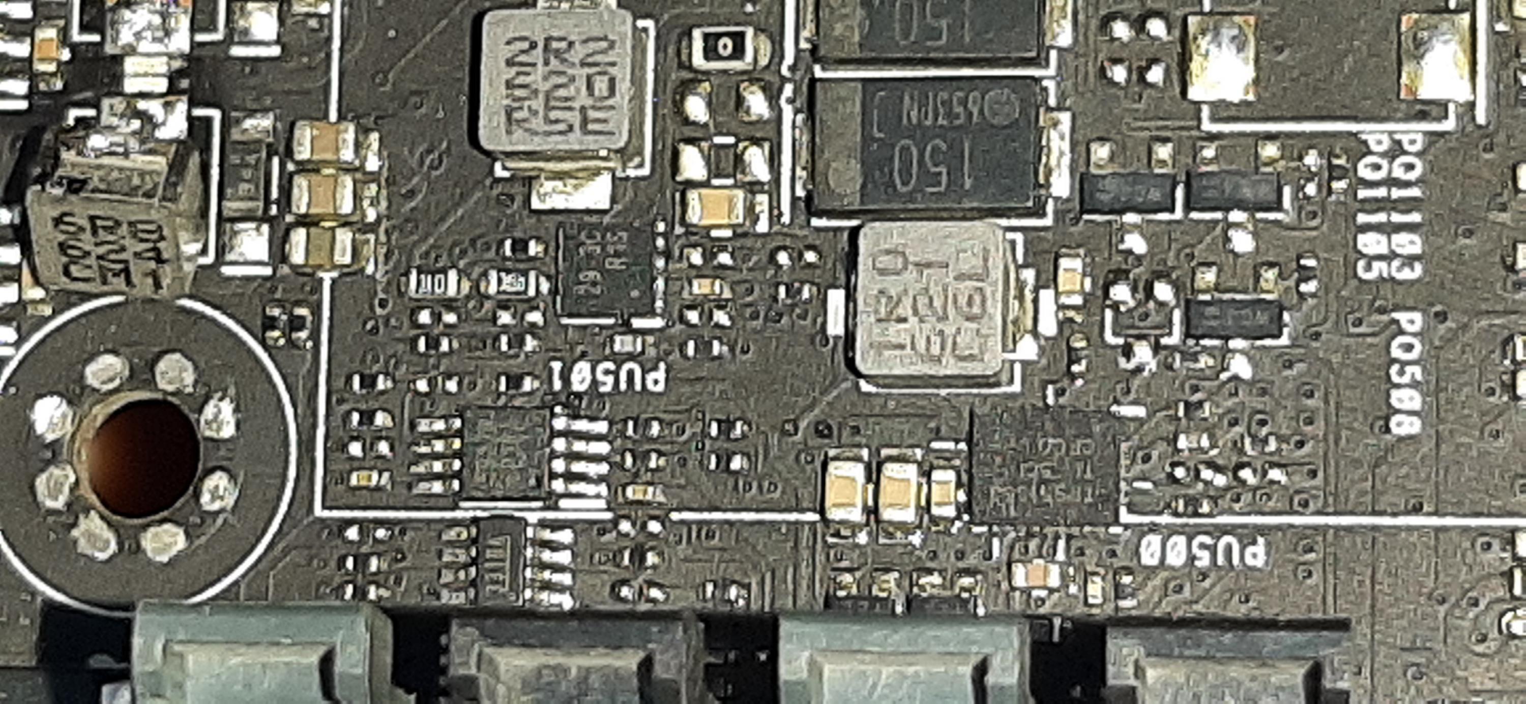

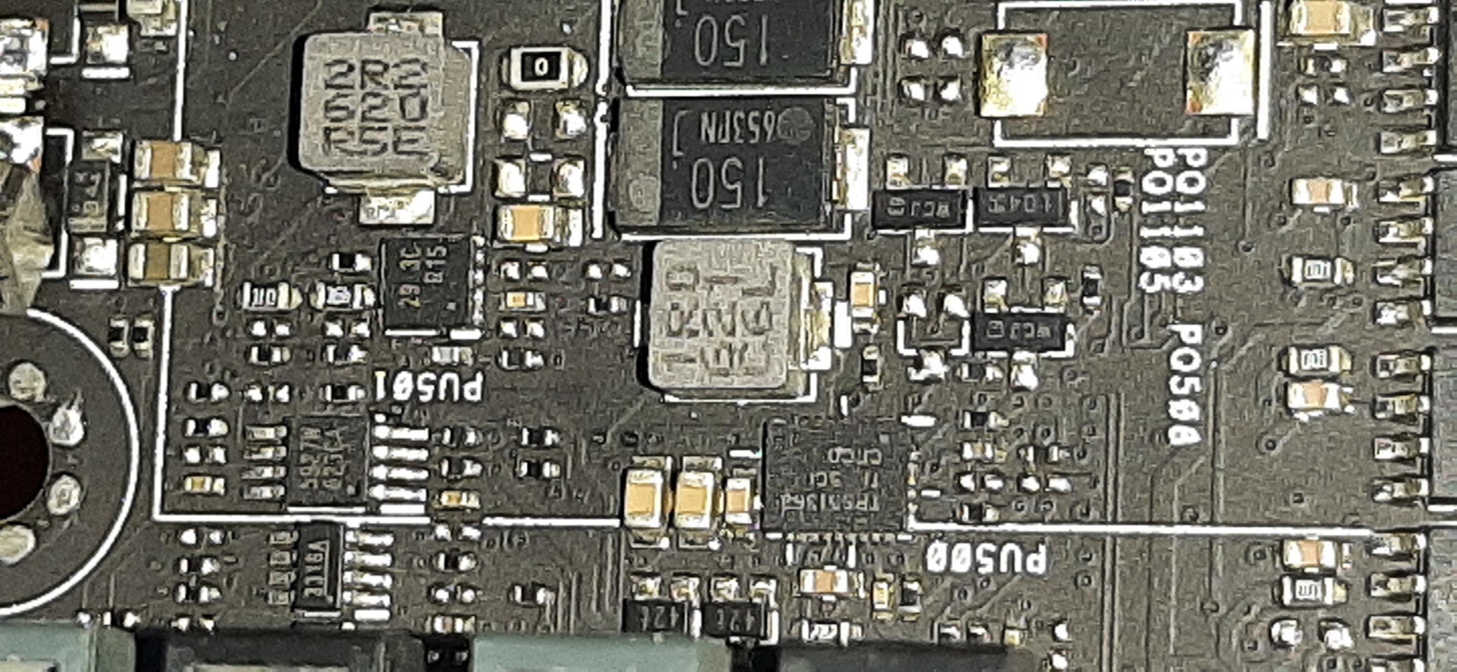

            Pictures of 29 3c r1s (?)
              This is the famous chip that generate 1.05v for the motherboard.RT 8605 zqw
