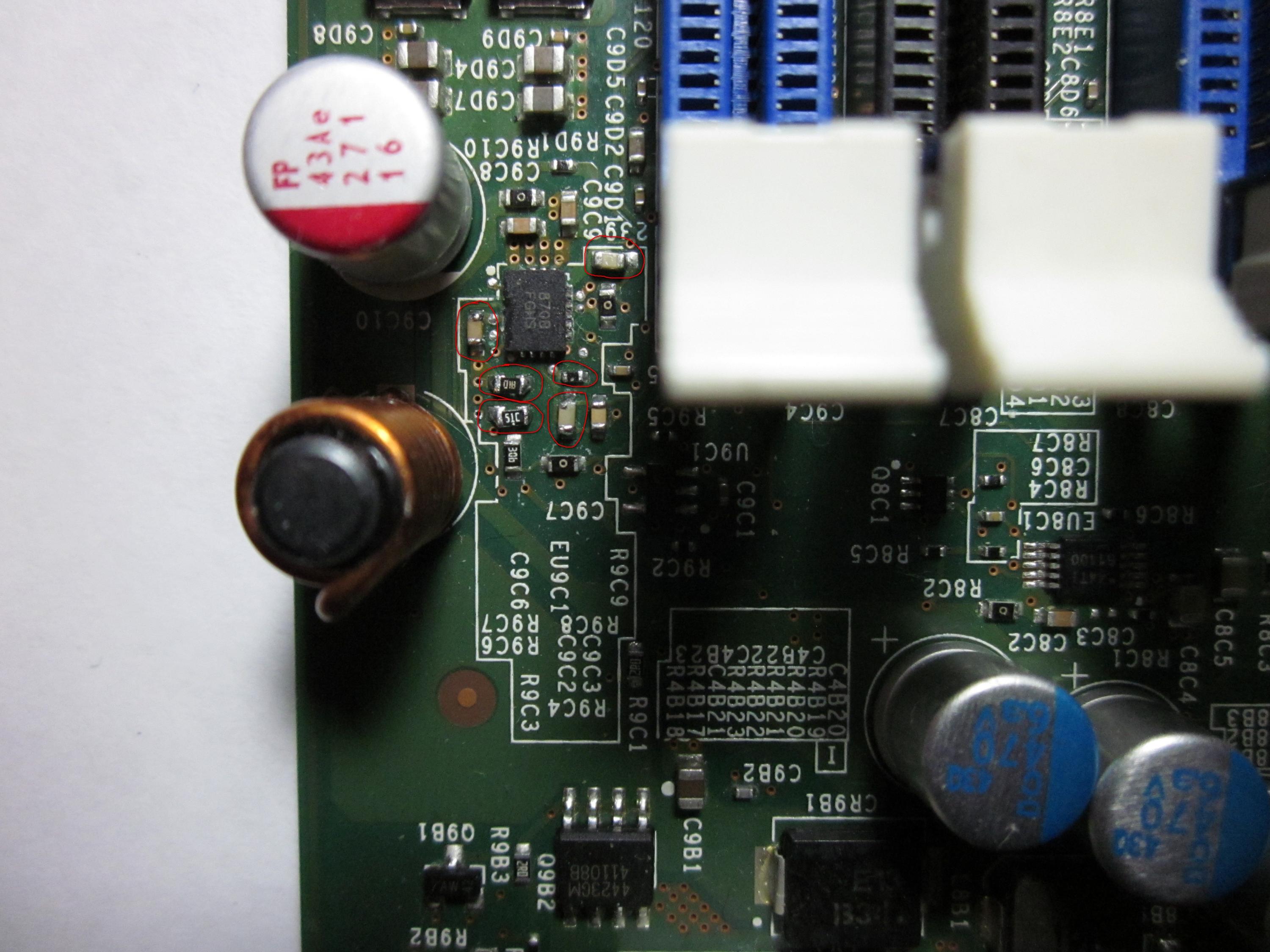

    Intel S1200BTS
    On the INTEL S1200BTS board (DAS09MB14C0) REV.C The ISL95870B memory power supply PWM has been replaced and some strapping elements may have been mixed up.1.5V memory power is present, as well as the rest of the necessary voltages on the DDR3 slots.When running without memory, three long speaker beeps.With memory in any slots there is no image, there is no speaker signal, on the postcard 84, the LEDs LSB, B1T2 and B1T4 are lit, error 0x15 (North Bridge PEI Module Starts).
    In the photo, I circled the soldered elements around ISL95870B in red.Please, who has this fee, take a photo of this site or suggest which elements are mixed up
