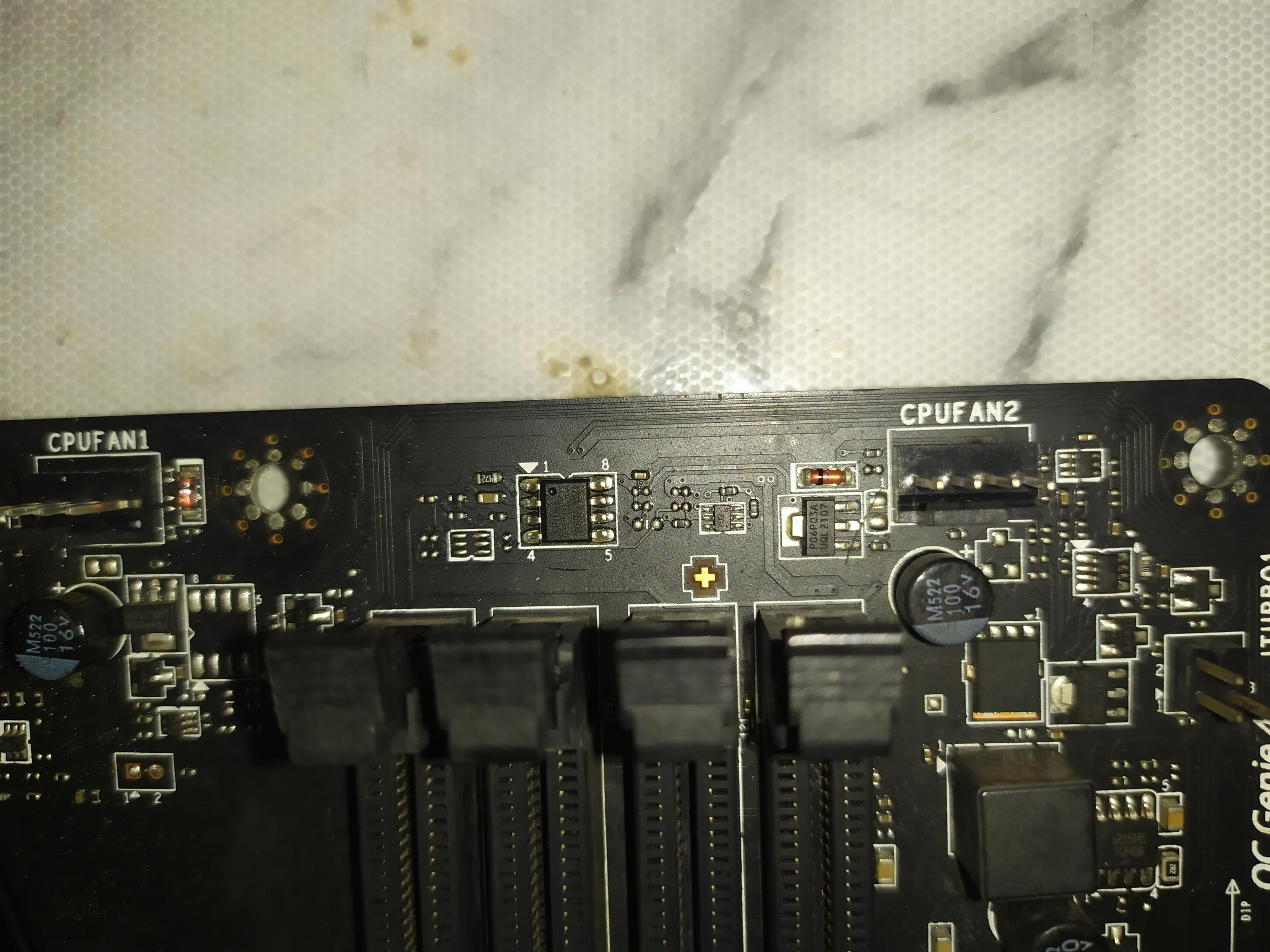

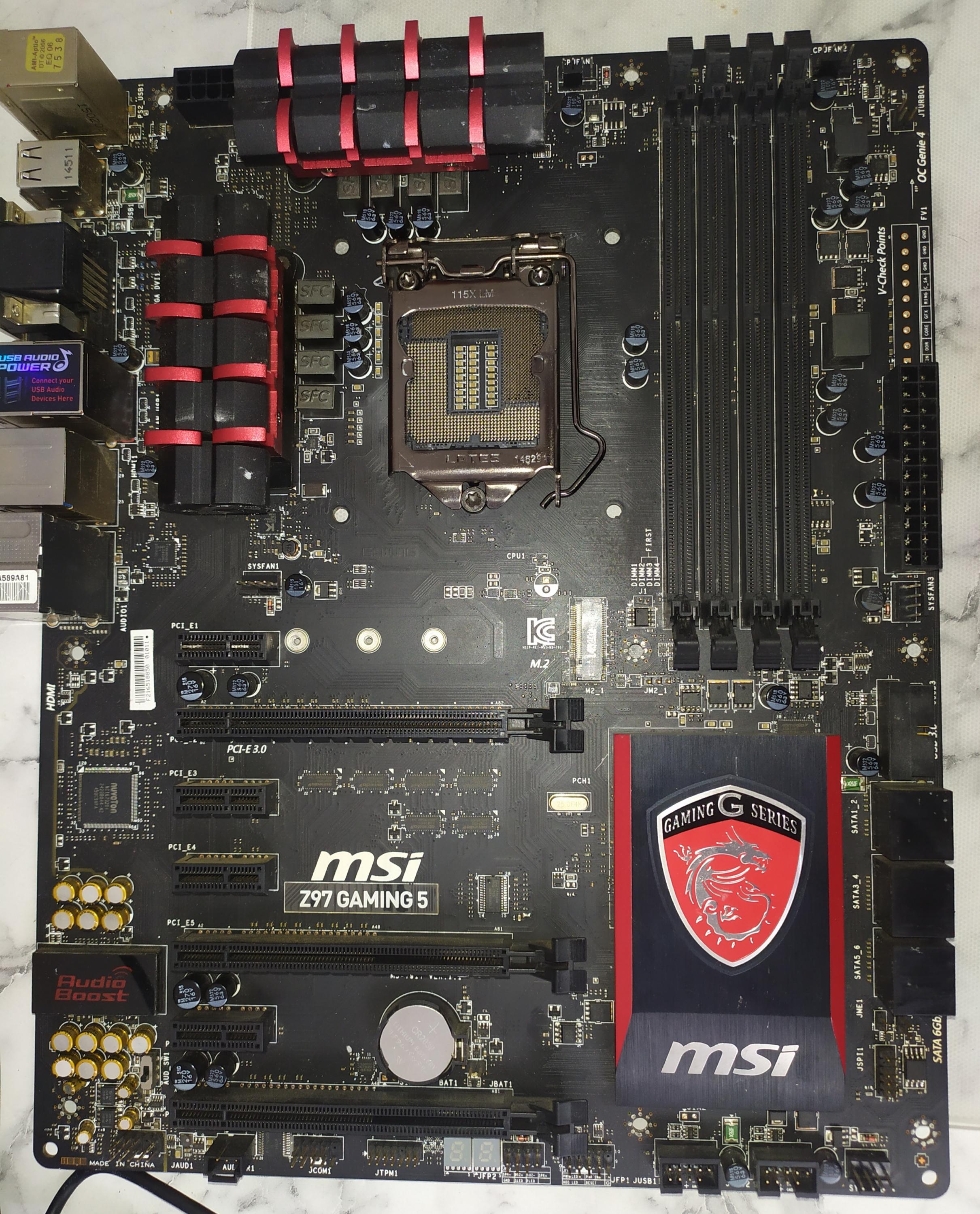

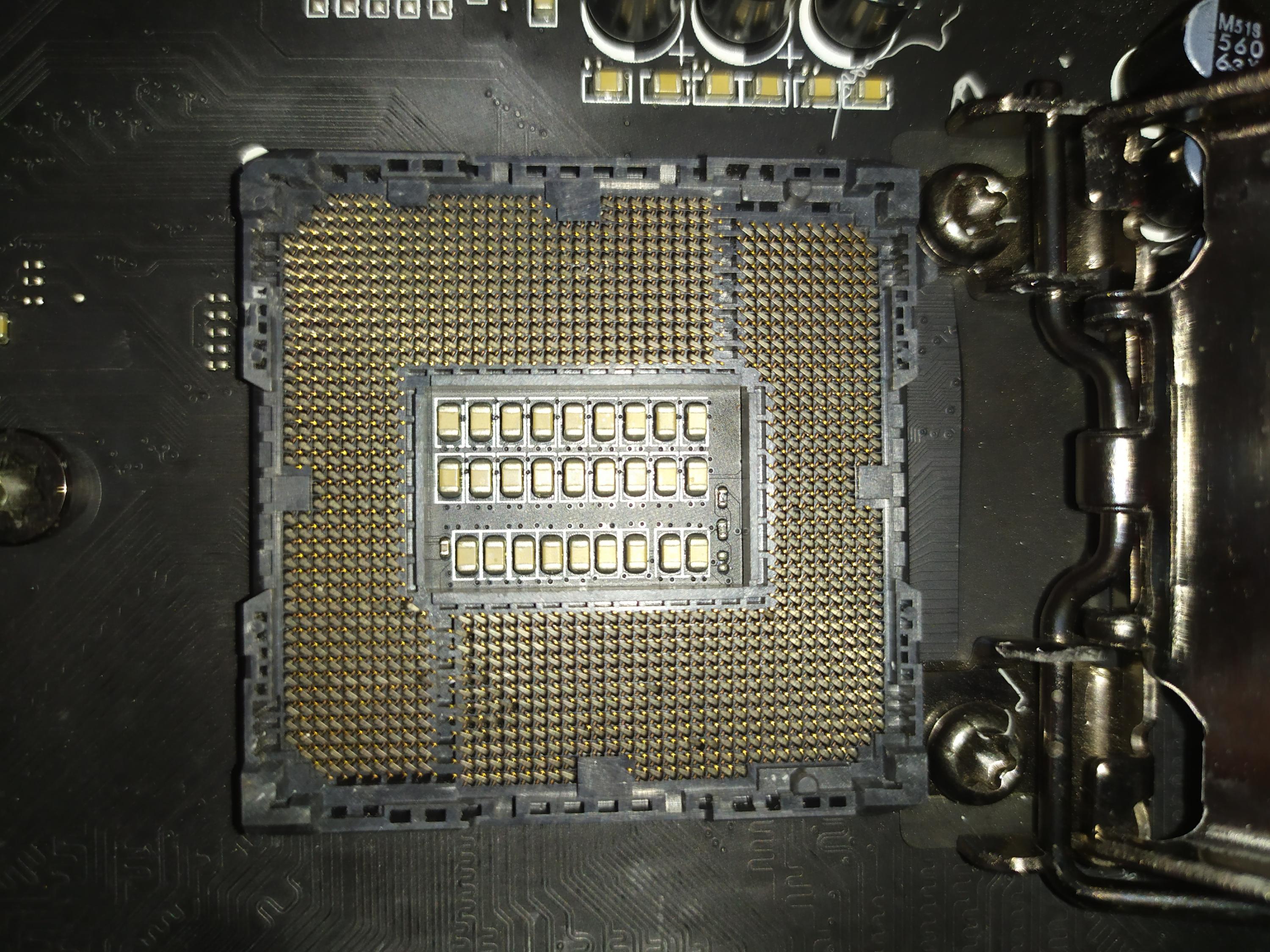

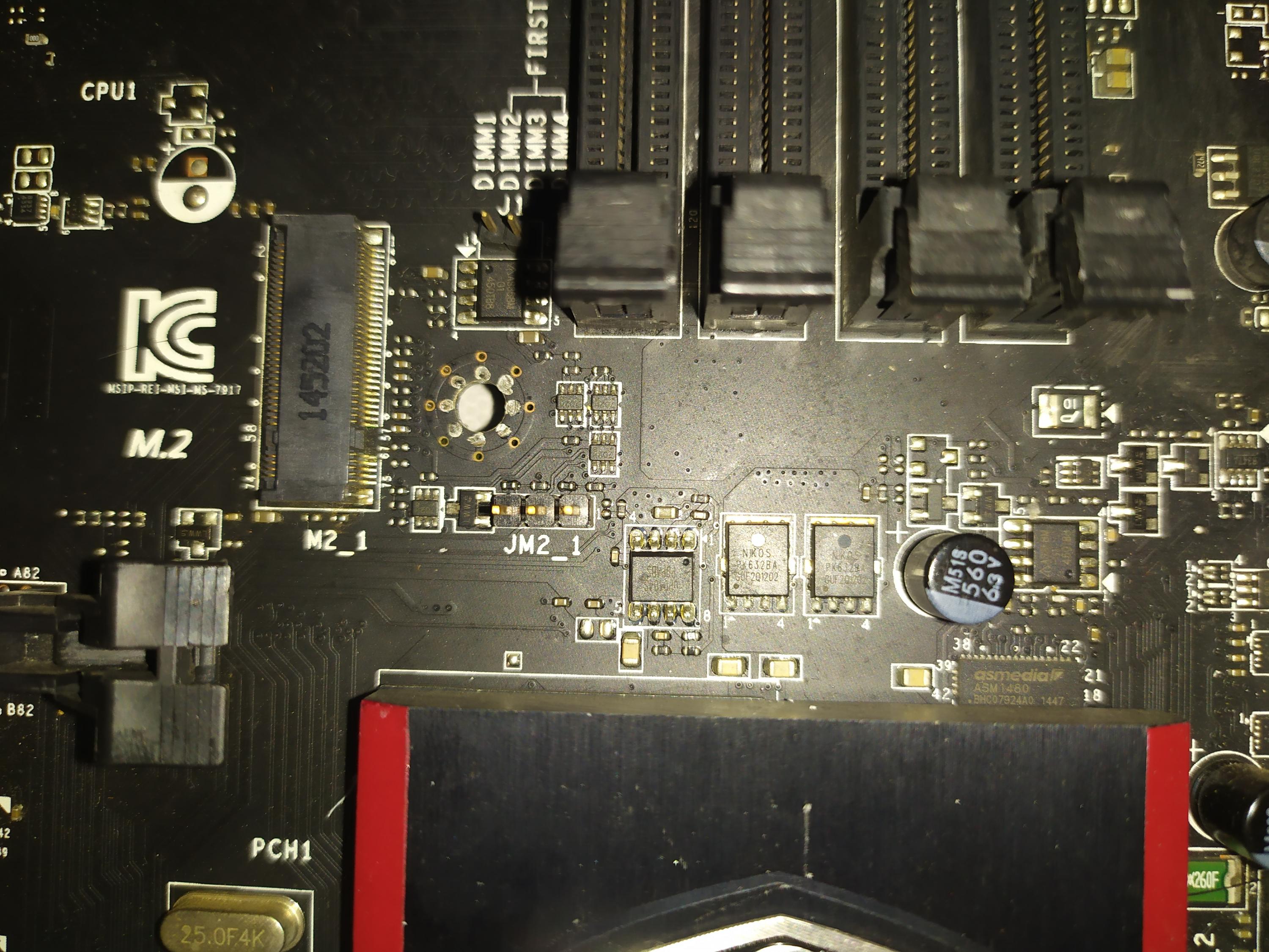

    hi everyone.i have Msi Z97 Gaming 5 Motherboard and only 1. ram slot works.
    i d mosfet measures and look any short but not a problem.looked in slots with microscope and there is clean.cpu pins normal.do you have any idea?

    Lot of the cpu pins are bent, it can be seen even on the picture you attached. Displacements even of 1/5 mm are enough to get no contact. You need to align them to the grid in all axes using a tiny watch screwdricer and 10x magnifier glass, exchange the bent pins, or exchange the socket. This is a Lotes socket, unfortunately it is much less resistant to heat than Foxconn, so exchanging single pins can be very difficult without some melting of the socket materiał, so try to realign the pins first. Disassemble the cpu fixing element before doing this, to have better access and visibility from all angles / sides. View always from a flat angle.
