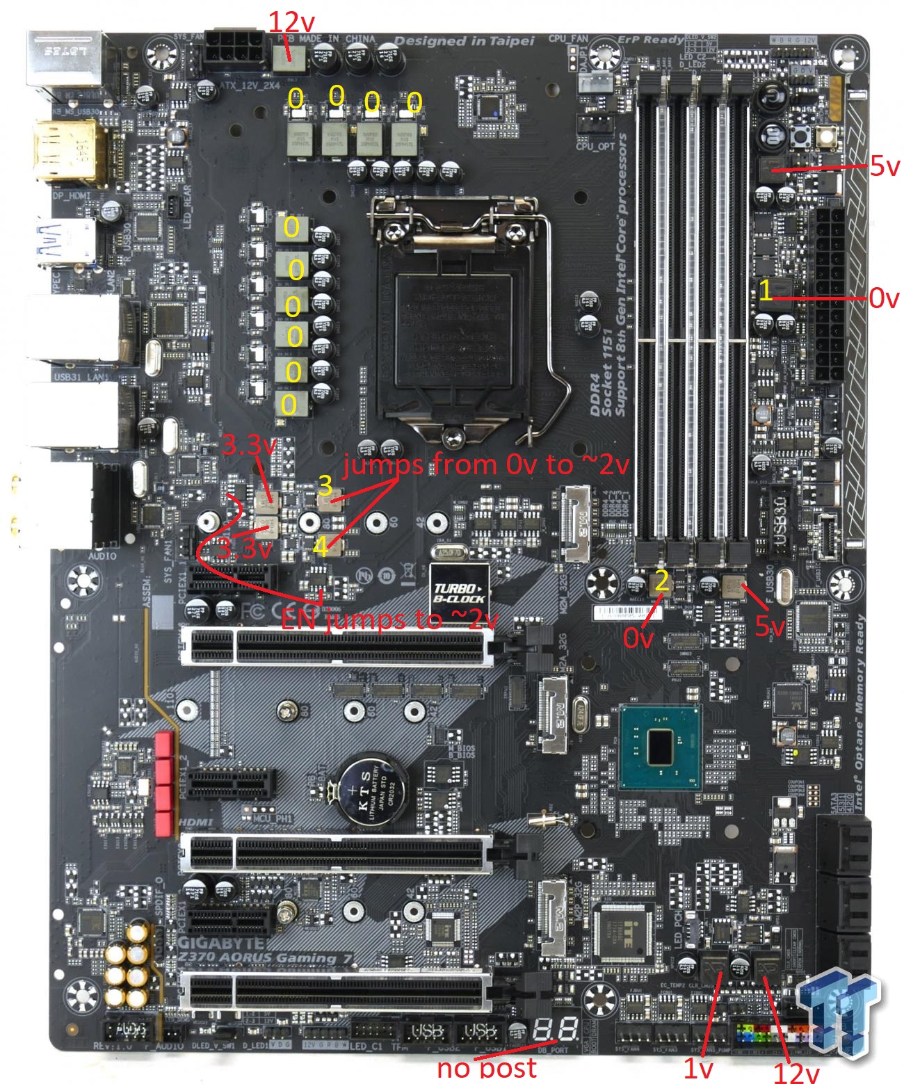

Z370 AORUS Gaming 7 VCCSA and VCCIO signals
  • skynet85
    • Jul 2015
    • 124
    • Georgia
    5v are present before pressing, and 3.3v on the bios. my measurements after pressing the button.
    Now I have an i5-9600k which I checked on another board, it works there, it can find a pentium or a celeron, because I noticed that the VCCSA and VCCIO signals do not come, who controls them ? Thx
