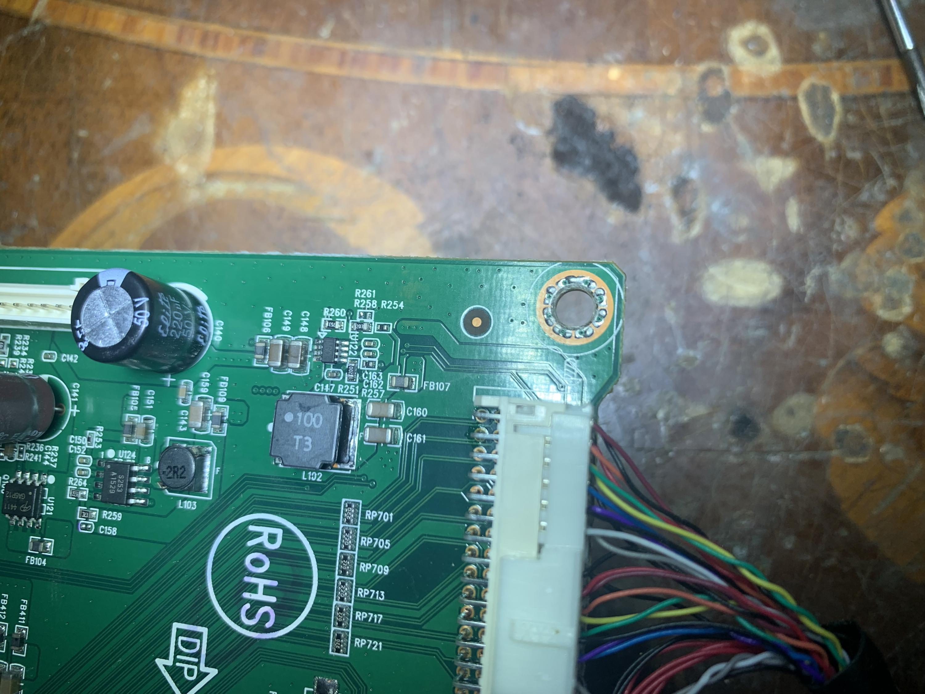

    Hi i have a problem with this monitor mainboard.
    I found a missing resistor on PCB; R261.
    Maybe a wrong board manipulation and R261 was torn from pcb.
    Can you kindly tell me the value of this component?

    R261 = 10k
      Re: Asus mg279q
      Thank you so much!!!!
      Monitor is up 'n running again.
