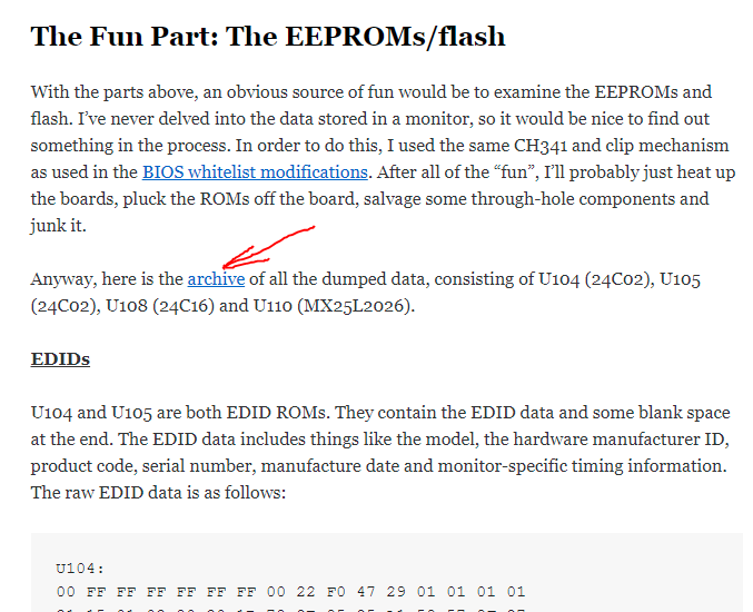

    hello eveeryone
    i need dump file of hp compaq la2206x monitor
    thanks for your response
  • lotas
    • Jan 2016
    • 4577
    • Russia
    Re: hp compaq la2206x
    https://goughlui.com/2016/09/11/salv...ler-usb-ports/
