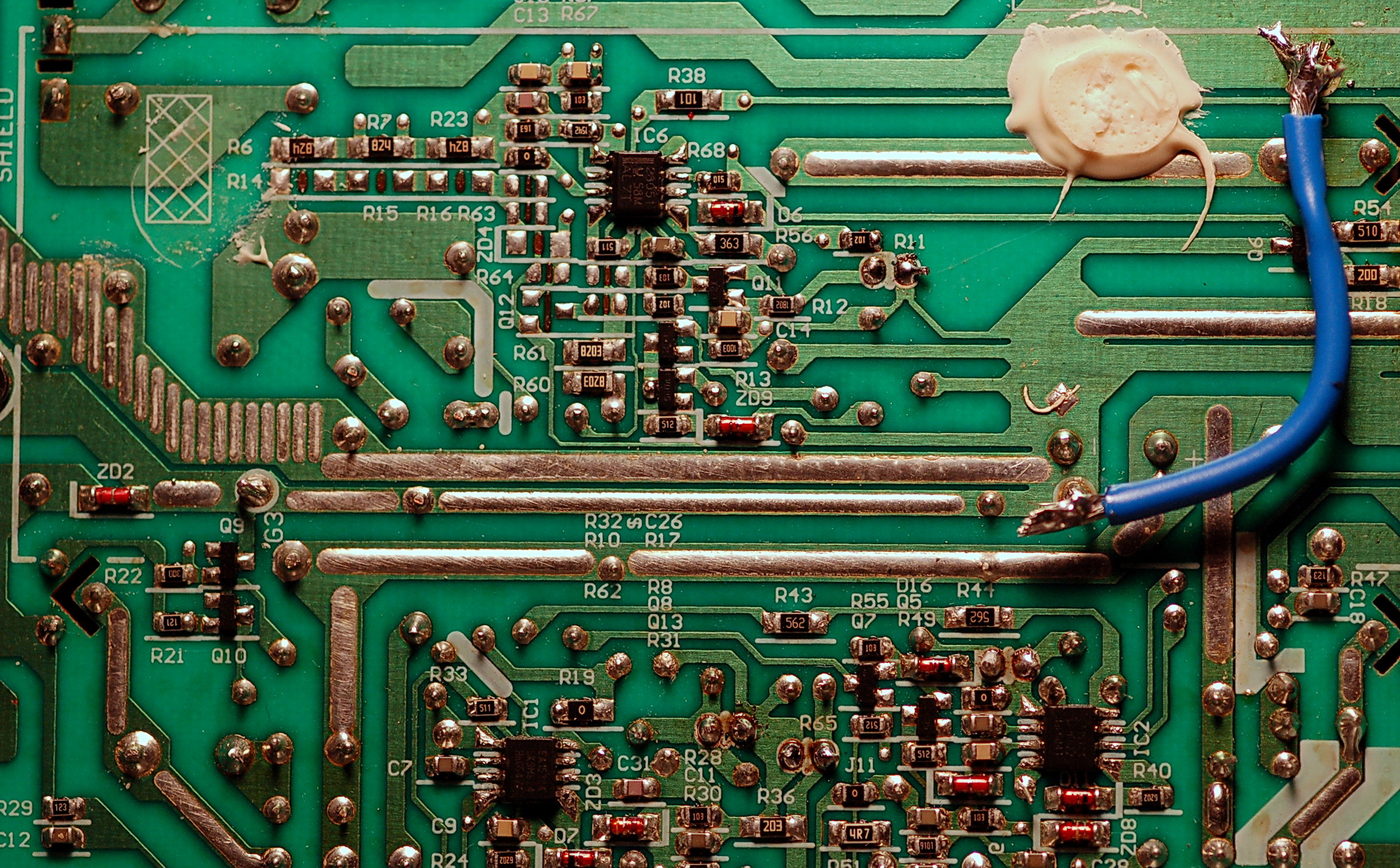

    Here are the pics.
    And please disregard the absolute DISASTER that is the ground jumper Quick and dirty.

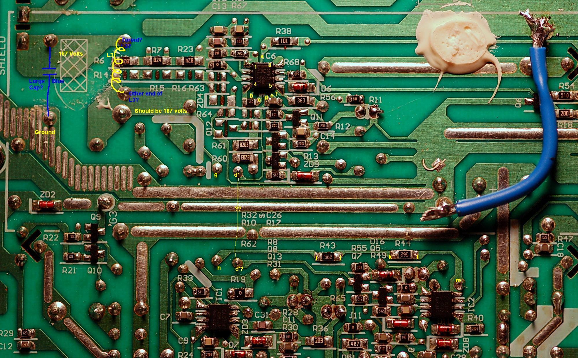

      OK, this is driving me nuts. According to the datasheet, pin 8 is supposed to be the power pin on this IC. But for the life of me, I can't see where it is hooked up.
      Your mission, should you decide to accept it, is to identify which of the possible candidates (cleverly marked a thru f) connects to pin 8.
      Good luck.

        Point D is the only point which shows continuity to pin 8 at .1 ohms. So that's the point you're after.
        The last cap came in today. Swapped it, still nothing.

          OK, I/ve been playing with Paint again. I'd like to say I've been having a ball, but....
          Yellow markings: Is that the continuation of the lead from pin 8? If so, it appears to go to Q7; am I right?
          Blue markings. I've tentatively identified one of the large blue caps near the bridge rectifier. Did I get it right? Also, there is a toroidal coil, possibly L3 shown on the first picture you posted. Are those the connections for that torroid? If not, is connected to those feed-throughs?

            You got it right on all counts.
            Your yellow line is Jumper J10 and does lead to Q7.
            Your blue line is C5, the cap just west of (and 90 degrees to) C4 (as viewed from the top side).
            Your L3 location is spot on.

              Are there any other leads out of L3? Because if L3 is good, the following points should be at 167 volts (see picture).
              Better check the solder joints.
              PlainBill

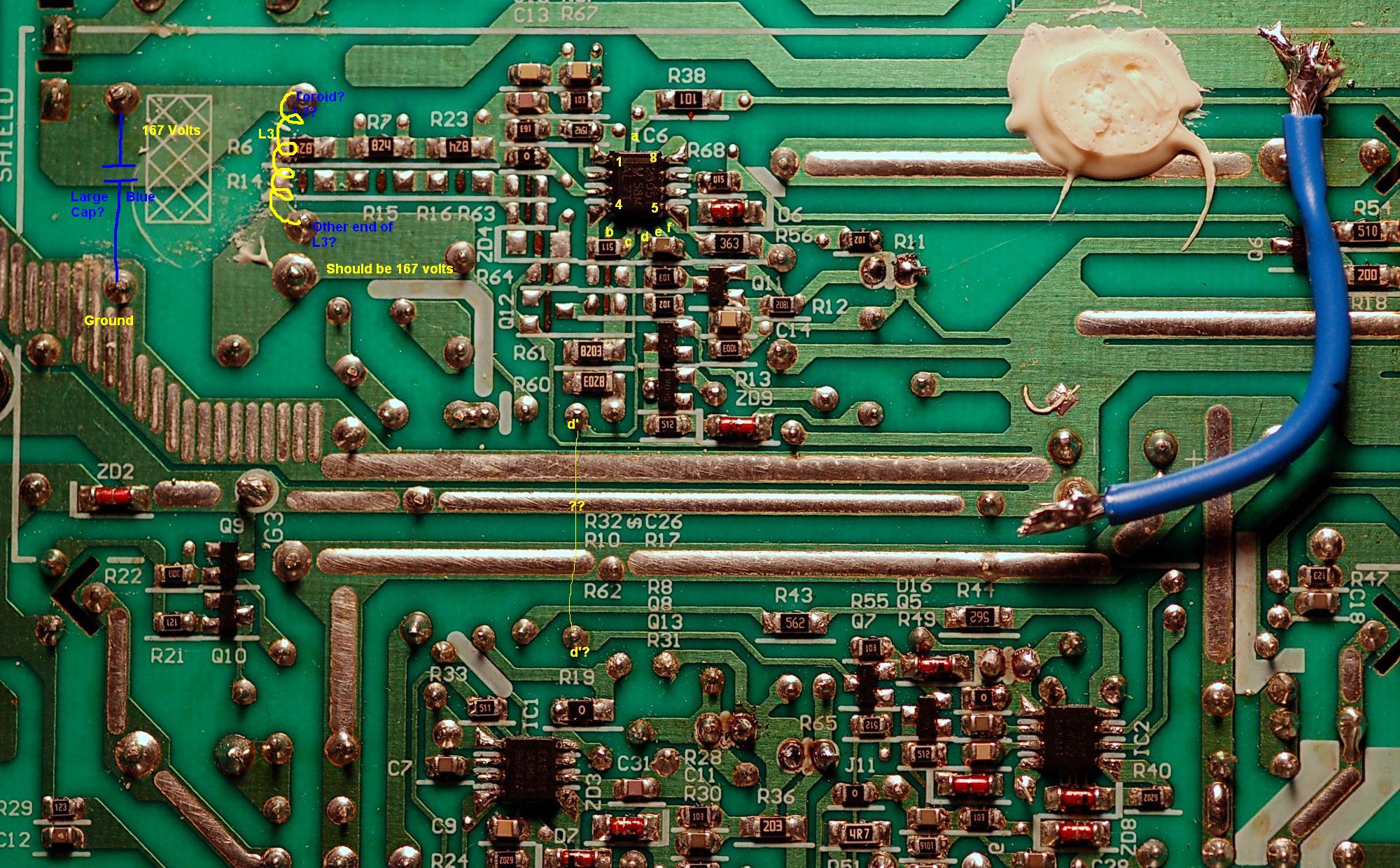

                          Not me. Note the new, updated picture. What are the voltages at points g, h, i, j, k, l, and m?

                                  Re: Acer AL2423W: Recapped, Still Dead!
                                  PB:
                                  Unfortunately the readings seem as you would expect. No smoking gun here.
                                  G thru I: 150v
                                  J thru K: 143v
                                  L thru M: 136v
                                  Where to next?
                                  I will assume I need to recheck the voltages at IC2's pins?
                                  For the record, I alligator clipped my meter's ground lead at my nasty temp ground jumper. I assume that should be fine for voltage testing in this area.

                                    Right, check the voltages at the pins of IC2. SOMETHING isn't working right.

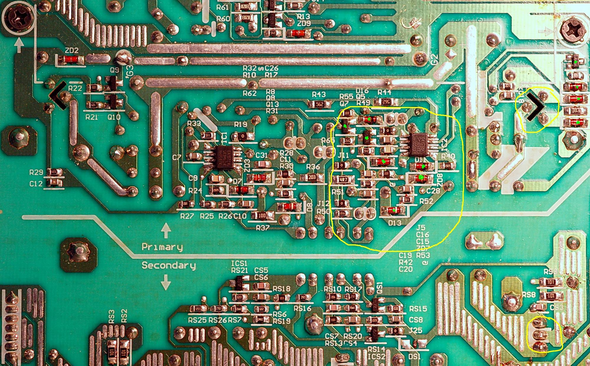

                                        Gentlemen, we have power!! Well, at least to the SMPS controller. But it doesn't appear to be doing anything.
                                        There are two approaches. Odds are the TEA1532A has died, but that isn't an absolute. One approach is to purchase one or two TEA1532ATs from Digikey (at about $1.56 each), install it, and see if it works.
                                        The other is to 'look before you leap' and perform rudimentary tests on the adjacent components. If they check out, you can be reasonably confident replacing the IC is the way to go.
                                        To that end, I have marked up a picture for you. I've circled some areas of interest.
                                        IC2: Measure the resistance from pin 2 if IC2 to each of the other pins of IC2. Report the readings.
                                        IC1: Measure the resistance from pin 2 if IC1 to each of the other pins of IC1. Report the readings.
                                        Area around IC2: I have marked 5 diodes and 2 transistors with a green dot. Check resistance across each of these. Report any that read less than 50 ohms.
                                        To the right of IC2 Measure the resistance across all three legs of the FET, also measure the resistance of the three diodes and the transistor (not circled, but have green dots)
                                        Output diode (lower right corner, circled). Measure the resistance from the center lead to either side lead.
                                        PlainBill

                                          Okay, I checked everything and before I throw a hundred numbers at you, diode ZD6 measures .8 ohms.
                                          ZD6 is the second diode from the top next to FET Q3 that you circled in yellow. It connects to the top leg of the FET.
                                          Let me know if you still want the results from the IC's. They both gave nearly identical results.
