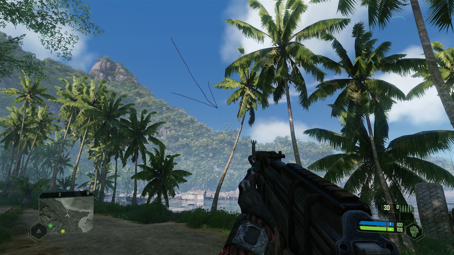

    Hello.
    First my pc.I have Gigabyte Rtx 3090 OC ( stock ) and 10850K stock ,32gb ram.
    Issue is only on 1920x1080P with 165hz. On 1440P with 165mhz is fine. On 1920x1080P with 144hz is fine. On 1920x1080P with 165mhz i can see on screen small black dots flickering vertical.
    If i wanna catch screen its not visible or clip. So i post screen and i added from paint. Just very small flickering black dots on vertical position. Screens not working. Happens only in 1080P with 165HZ. Visible on desktop too when i am very close.
    Just found on reddit somebody had the same issue with monitor:
    https://www.reddit.com/r/Monitors/co...h_new_monitor/

    When i am using in nvidia panel. I made perform scaling from monitor on [gpu] and it dissapeared ,that dots dissapearing. It must be monitor? not hardware/?
      • 21669
      Re: Please help, I have an issue with new monitor Aorus FI27Q (black dots dropping do
      Try to flash the firmware - https://www.gigabyte.com/uk/Monitor/...rt-dl-firmware
      Note : It needs to install OSD sidekick first to update firmware.
