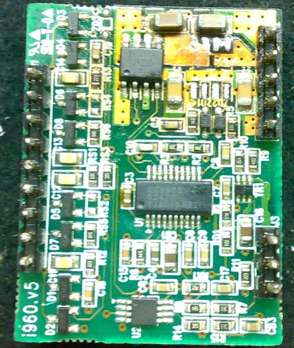

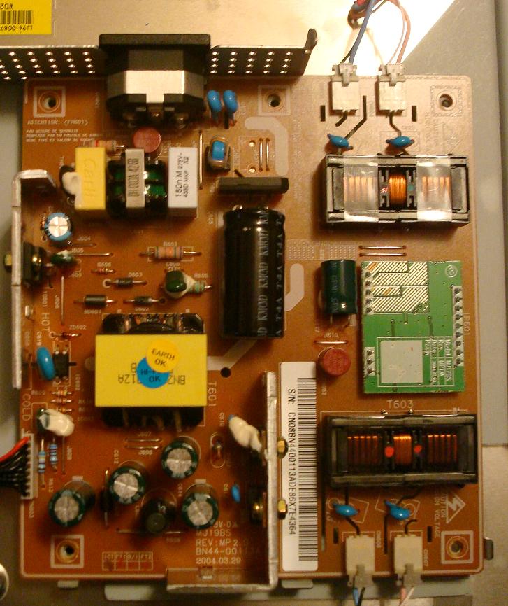

    I was given a dead samsung 920N LCD to play with and put it aside because the faulty electronics did not appear to be due to bad caps.
    There ware no mounded caps.
    All the caps passed the scope, oscillator, resistor: ESR test.

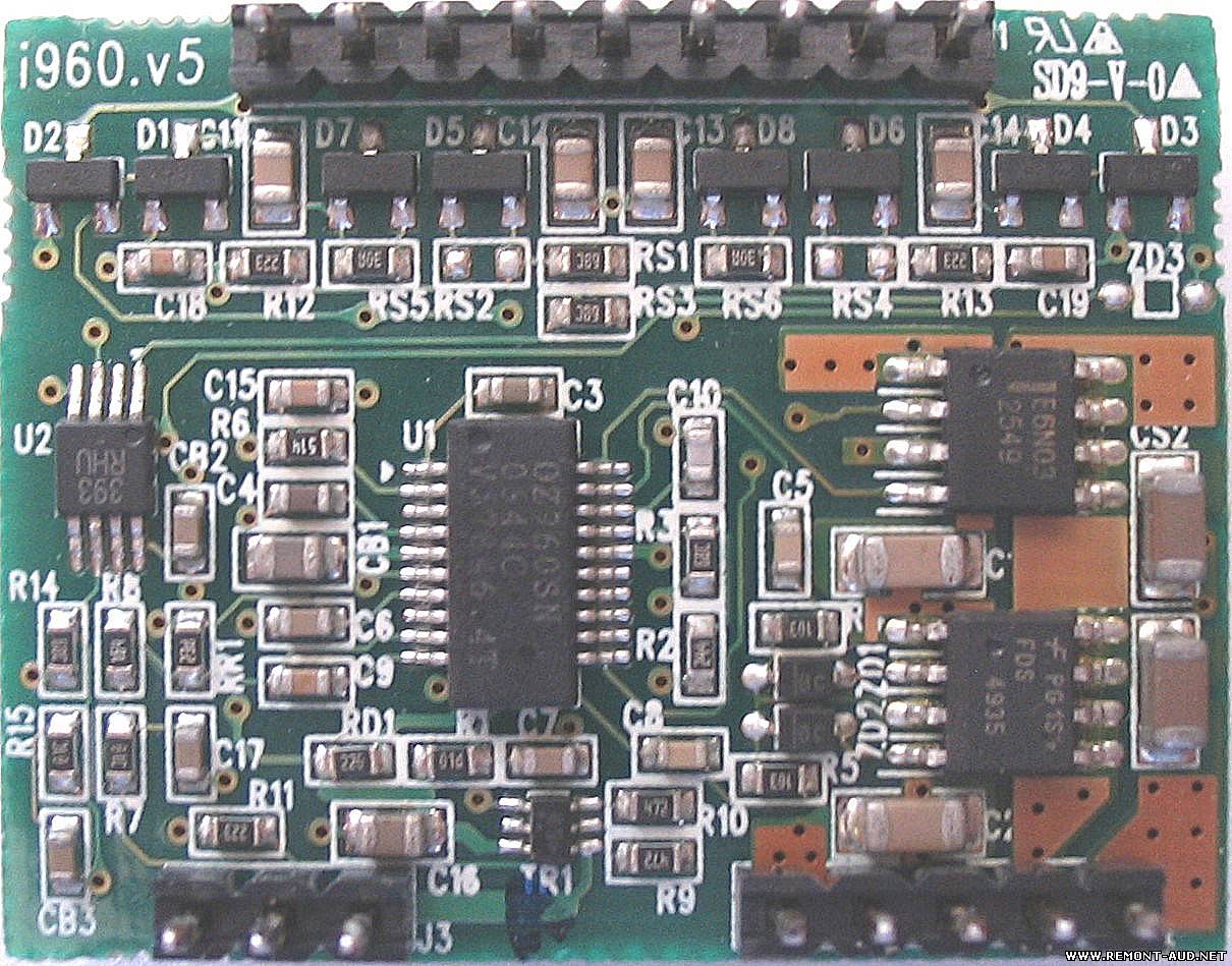

    There were 3 broken foils on the MJ19BS inverter/power board to the MJ17BS hybrid assembly pins 15,16 & 17 which were easy to repair.
    Still, no backlighting.
    I isolated the fault to the MJ17BS hybrid pulling down the 13v (hybrid pin 12) by removing the hybrid. It was starting to look like an expensive repair so I set the LCD aside.
    Then I came across a Russian site that appeared to show a repair to the E6N03, dual FET chip on the MJ17BS hybrid. Which is likely to be at fault in my case as the FETS sink most of the current.
    The E6N03 is the missing 8 pin, surface mounted device in the upper right on the photo of the MJ17BS hybrid.
    This fix is a bit outside of my confort zone.
    Has anyone tried to repair a surface mounted component on a hybrid?
    What should I be careful of?
    Where can the E6N03 be sourced when I am only buying one or two (in case I screw-up the soldering).

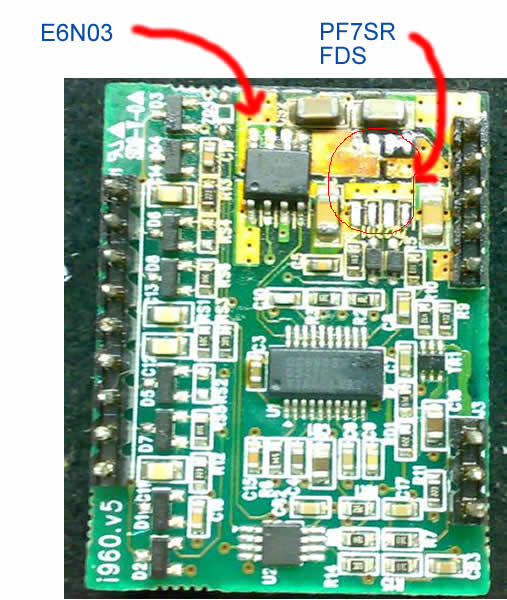

    The E6N03 part location in the previous post was not correct.
    I'll try again.
    The E6N03 is a dual FET. Data Sheet attached pdf document: https://www.badcaps.net/forum/attach...id=12870&stc=1
    The missing 8 pin surface mounted device in the photo is labeled PF7SR, FDS on the hybrid that I am looking at.
    I cannot locate any info. on PF7SR but I may also have misread the device label. These tiny parts are not so easy to see; anymore.

      I am still trying to piece this hybrid fix together.
      The 8-pin device that was removed from the hybrid photo below appeared to be: PF7SR, FDS.
      Another Russian blog post about the samsung 913N suggested that the "PF7SR FDS" is an FDS4935A.
      pdf data sheet attached: https://www.badcaps.net/forum/attach...id=12871&stc=1
      What is the best method to remove these surface mounted devices from the hybrid?
      Am I way "out there" on this one?

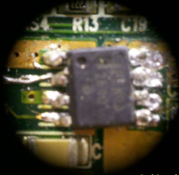

          The method I resorted to involved an exacto-knife and a fine tipped iron.
          The IC leads were severed from the main part of the chip as close to the IC as possible using the exacto-knife and downward pressure. Care had to be taken not to cut foil traces on the hybrid substrate that were in the path of the knife blade.
          When all the IC leads were severed, the IC was removed and discarded. The remaining part of the IC leads that were soldered to the solder pads on the hybrid substrate were removed using a fine tip iron and copper braid.
          Worked well this time but the 'Chip Quik' is likely to be the prefered method for the future.

              Repaired the hybrid (see the attached png.s)
              ...improved on the second try.
              The component moves around as it is soldered.
              A dot of crazy glue helps hold the part in place.
              Works good, now.
