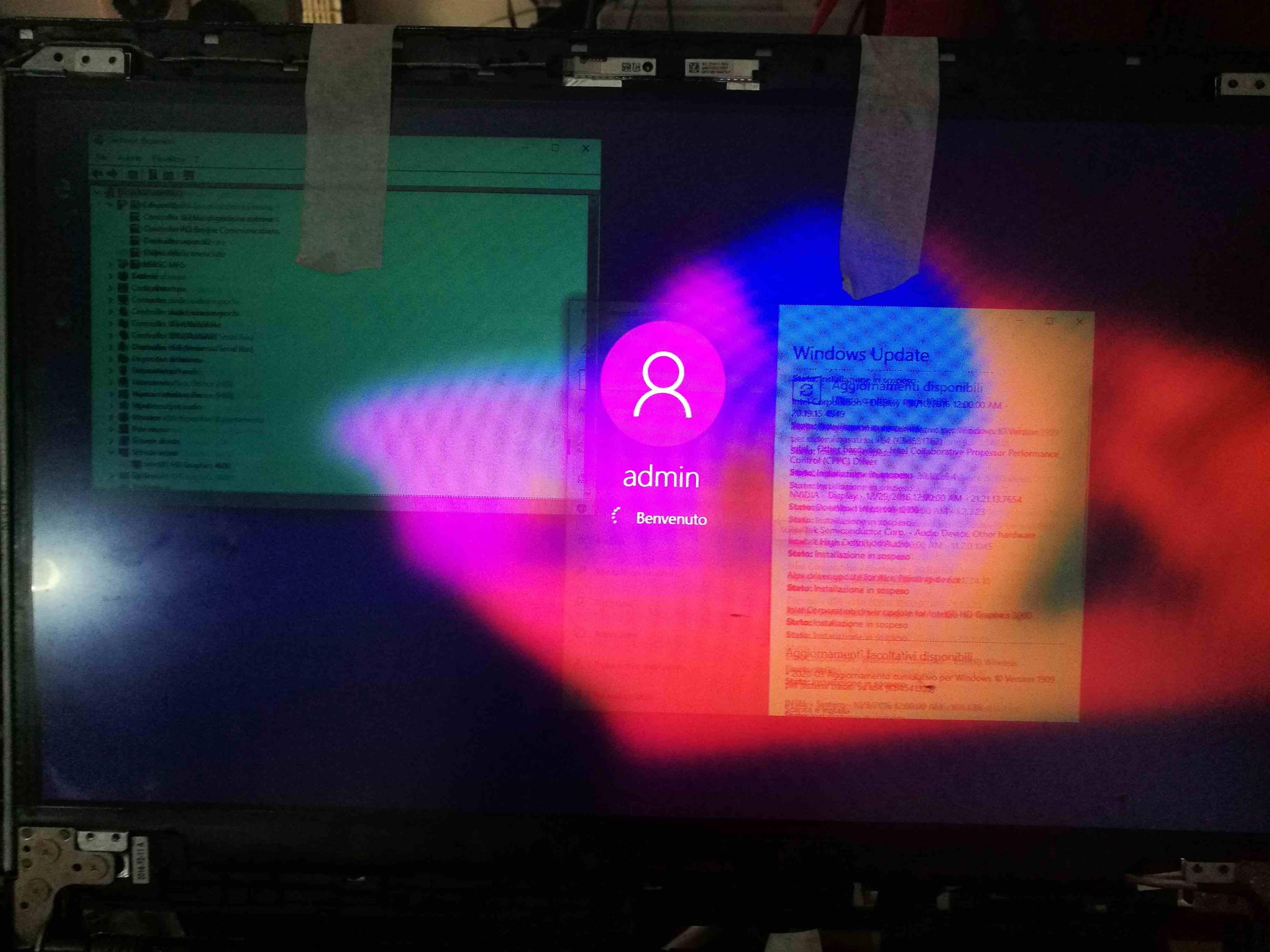

LCD edp predominant color
  • jasko_jacker
    • Oct 2014
    • 1140
    • italy
    LCD Edp LP173WF4-SPD1
    http://www.panelook.com/LP173WF4-SPD...iew_24463.html
    On the bios the characters have a violet color instead white same thing whit the image on the OS. The screen visualize a good image no artefact no bad pixel no broken area. Whit another LCD the problem disappears so the issue not involve fat cable and motherboard. Any solution (I don't have a chip replacement for the lcd board) ? thanks

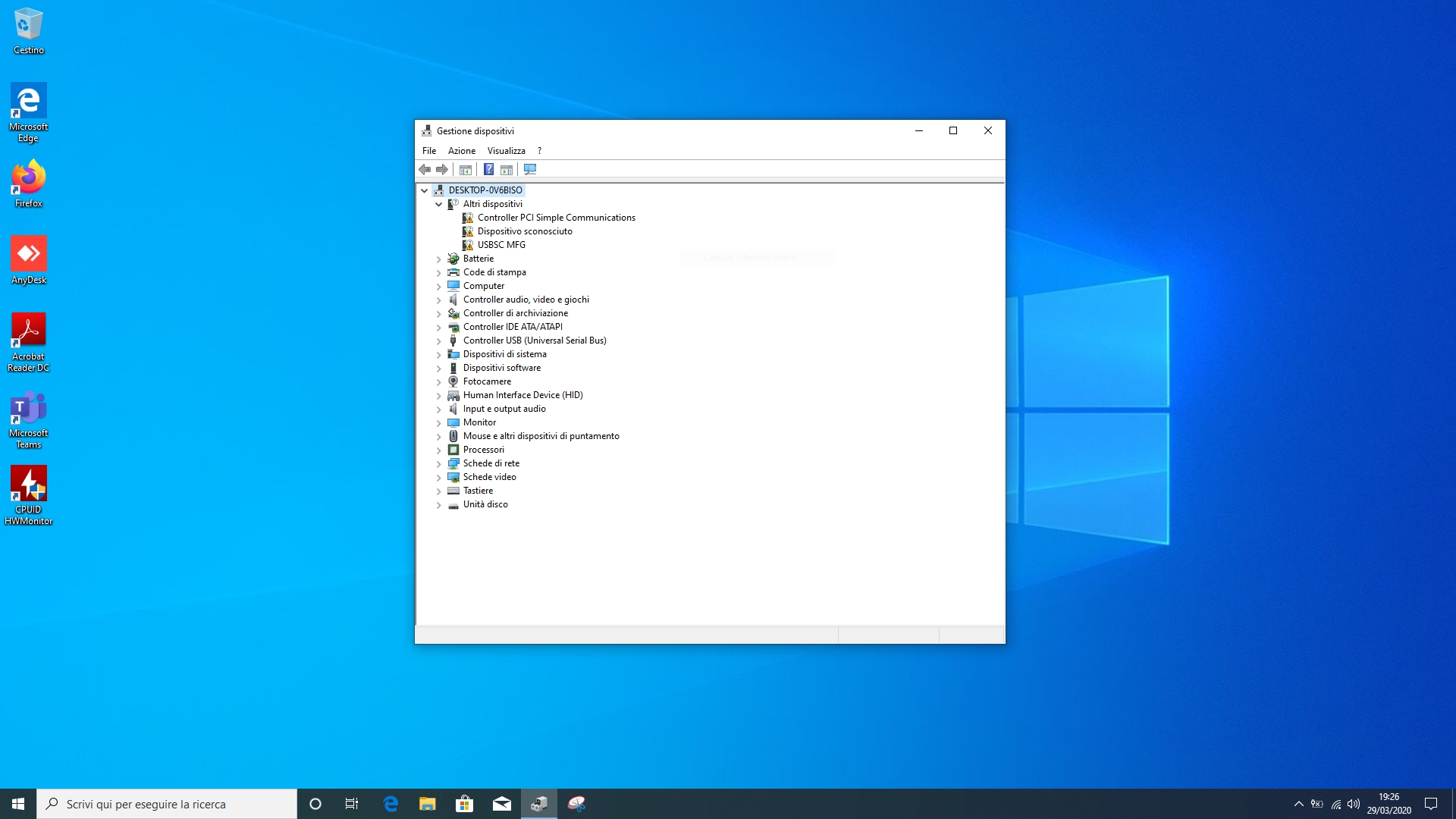

    Can you run this software and post an image of your panel info. Monitor Asset Manager 2.9 https://www.entechtaiwan.com/util/moninfo.shtm
    • jasko_jacker
      • Oct 2014
      • 1140
      • italy
      Re: LCD edp predominant color
      I don't have the dedicated sata cable, I had used linux on a usb stick and I was trying to install windows 10 with a hard disk in the dvd slot.

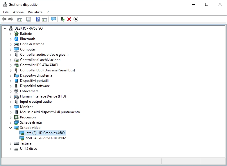

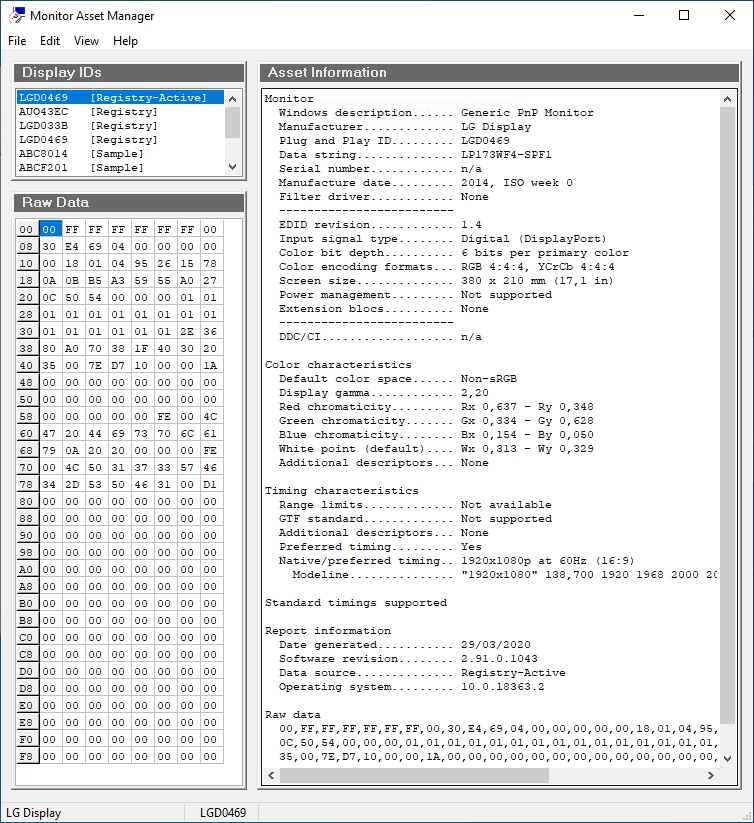

        I installed the program and I attach the results screen.I noticed that open programs remain in the background even after restarting, however both video drivers (intel and nvidia) have been successfully installed.
        in the photos (copied from the desktop) that I have attached, the wrong colors are not shown except in one that I did with the phone

              Can you check the part number on the label. At post #1 you said its a LP173WF4-SPD1, Monitor Asset Manager sees the panel as a LP173WF4-SPF1 (F1 not D) . Atached are some EDID dumps from a thread on notebookreview.
              "With hdmi no problems all works fine" ,it will you`re using the external monitors EDID

                It's my mistake, confirm LP173WF4-SPF1
                thanks
                  • 21679
                  I think you do indeed have a corrupt EDID, i would check if the EDID dump you found on github match the one from notebookreview.

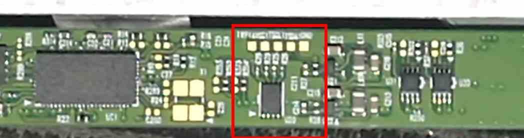

                    I have used an old lvds board with vertianov and after I have soldered the edp eprom chip fortunately it's readable and programmable, so I will try to put on it the correct edid file.

                      Partial success, this type of screen have two version with the same ID number, one works at 60Hz the second at 75Hz.
                      On github there are three files one match the 60Hz another match the 75Hz both taken from your rar, the third has the last two hex as the 75Hz file but it has some differences .
                      I read on the moninfo report that my monitor is 60Hz so I have reprogrammed the memory with 60Hz file that I taken from your rar but after the acer logo appears correctly the screen goes black and nothing change. I don't want to do to too many solders because the screen board is very delicate, do I program the file at 75Hz? I read that there is a utility to manually recreate the memory with the datasheet, do you know it?
                        • 21679
                        I didn`t know there was a third version. The 75Hz ones are G-sync enabled.
                        "I read that there is a utility to manually recreate the memory with the datasheet, do you know it"
                        There is some EDID editing software but you don`t need it,usually you can just type the EDID info from the datasheet into a new hex file.The EDID info is missing in the datasheet you posted(#5) so you`ll have to use one of the dumps. You can check the dumps here: http://www.edidreader.com/ make sure the header and checksum is ok.

                          Solved, the edid chip it's partially defective.
                          After replace it and programmed with a correct firmware the monitor
                          works correctly (for now)
