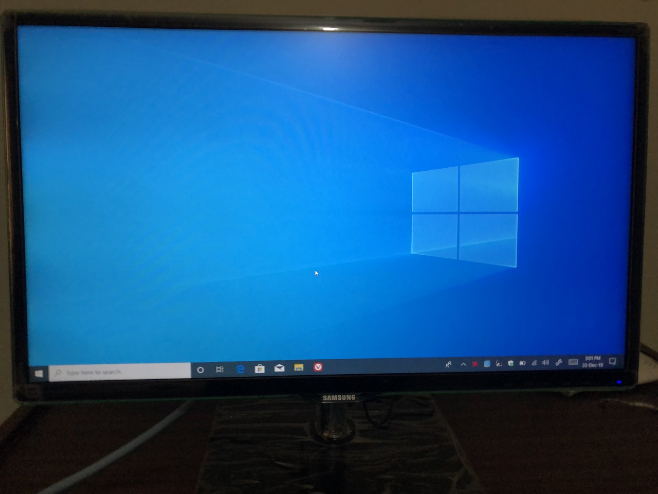

Samsung S24D390HL Disassembly
  • christianm
    • Feb 2020
    • 2
    Samsung S24D390HL Disassembly
    Hi I'm new here and need some help.
    can anyone guide me how can I remove back cover/disassemble Samsung S24D390HL monitor? I'm having some backlight issue with my monitor and b'cuz it's in great condition I don't wanna damage the body and it's not under warranty
  • KAVIGULA
    • Jun 2014
    • 2
    • tunis
    Re: Samsung S24D390HL Disassembly
    Hello, any flat plastic material would be a geat tool for the job .
    A bank card or any other type of plastic card would be helpful .
    • rampe2001
      • Dec 2021
      Re: Samsung S24D390HL Disassembly
      I laso have this monitor but I cant remover the cover. This is not the first monitor i am taking apart but the cover is way too tight. How did you manage to take it off?
      • lotas
        • Jan 2016
        • 4698
        • Russia
        Re: Samsung S24D390HL Disassembly
        Originally posted by rampe2001
        I laso have this monitor but I cant remover the cover. This is not the first monitor i am taking apart but the cover is way too tight. How did you manage to take it off?
        https://www.youtube.com/watch?v=FdqbBBGla6I
          09-07-2024, 05:50 AM
          09-06-2024, 11:40 PM
          09-06-2024, 11:40 PM
          09-06-2024, 08:40 PM
          Samsung Galaxy Book Flex NP950QCG-X01DE Notebook Specification for Upgrade or Repair
          This specification for the Samsung Galaxy Book Flex NP950QCG-X01DE Notebook can be useful for upgrading or repairing a laptop that is not working. As a community we are working through our specifications to add valuable data like the NP950QCG-X01DE boardview and NP950QCG-X01DE schematic. Our users have donated over 1 million documents which are being added to the site. This page will be updated soon with additional information. Alternatively you can request additional help from our users directly on the relevant badcaps forum. Please note that we offer no warranties that any specification, datasheet,...
          09-06-2024, 06:20 PM
