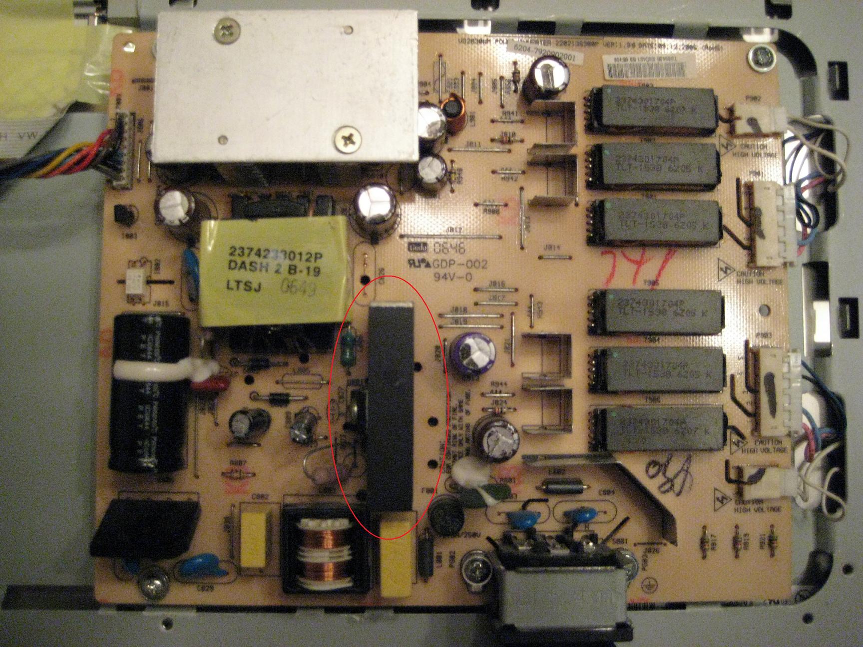

      It wasn't easy to get at the circuit board of the panel so I stopped there. Here is a question though: I didn't have my head screwed on straight and ended up touching the heat sink on the power board while it was powered up and was surprised to get a shock. I measured 70V AC on that heat sink...does that make sense?

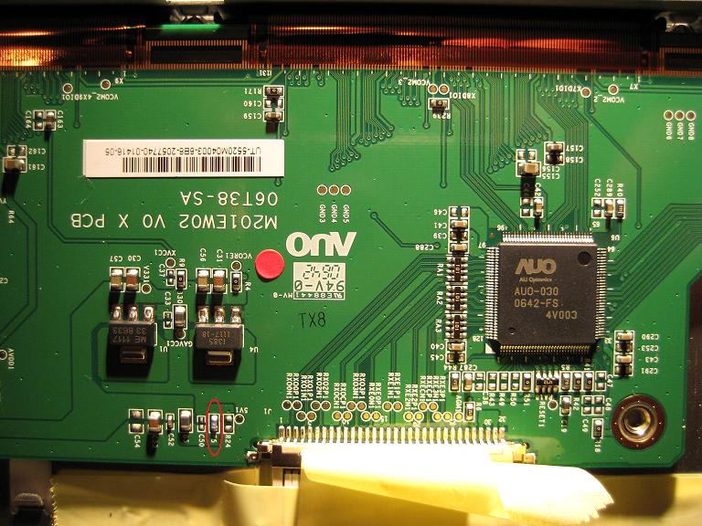

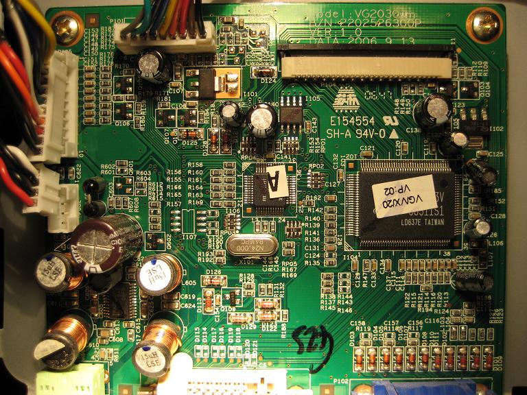

        I checked the only SMD fuse labelled F5 on the circuit board of the panel itself and it shows continuity so I don't think that it is blown.
        I have included a close up of the circuit board on the panel with F5 circled in red.
        I have also included a shot of the video board for suggestions of where to look next.
        Can I assume that the cables are the same for all panels so that I could try this panel with the video and power board from a different LCD?
          There are usually two or more heat sinks on the power supply board. One of them will has a potentially lethal voltage on it. Metaphysically, there is some debate over the implications of your surviving. If the optimists are correct, you are very lucky and should buy a lottery ticket. If the pessimists are correct, you used up a large portion of your luck and should be careful getting out of bed.
            There are great differences between LCD panels. There is a good chance the panels are interchangeable within the same model number.
