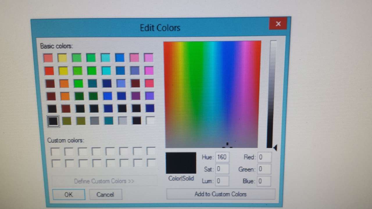

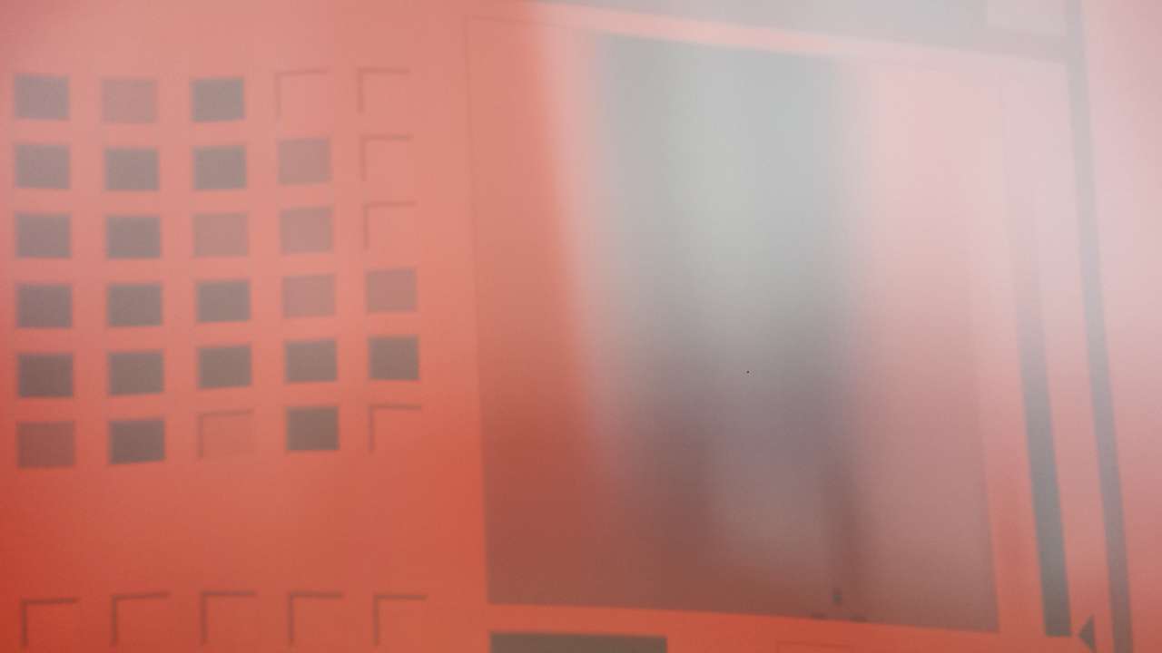

    I have on hand one Benq Projector with a RED image.
    This situation only happens with image from RGB sources and the RGB pass through output (to monitor) is good.
    When I see a color pallet, the red appear as white, Green and blue appear black.
    If I connect something to the Composite Video port the image appears correct.

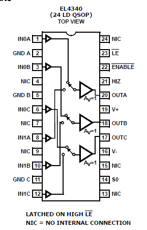

      I discovered what was the problem.
      It is the EL4340 that has two bad buffers.
      At the beginning I did't thought of this "switcher", but when I noticed that the projector don't switch the RGB output (for a monitor) it became evident. The RGB output only outputs the RGB1 input.
      I'm waiting now for a replacement.
      Cheers.

        Just to update this.
        This chip (I mentioned on the previous post) was replaced and the projector is working like a charm.
        In fact another projector arrived after this one with two malfunctions and one was this same chip with all the three bad buffers (if I can remember correctly).
