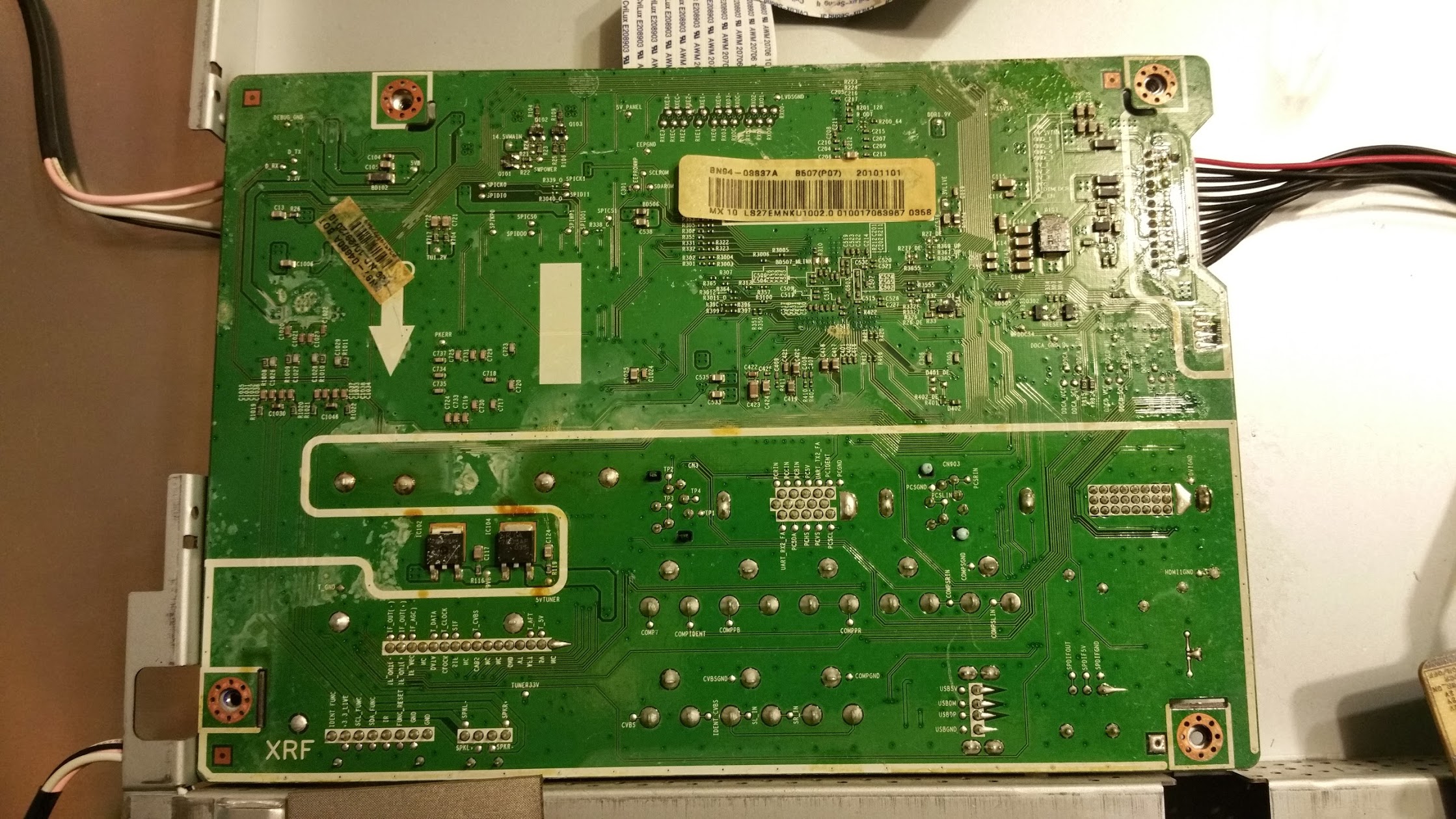

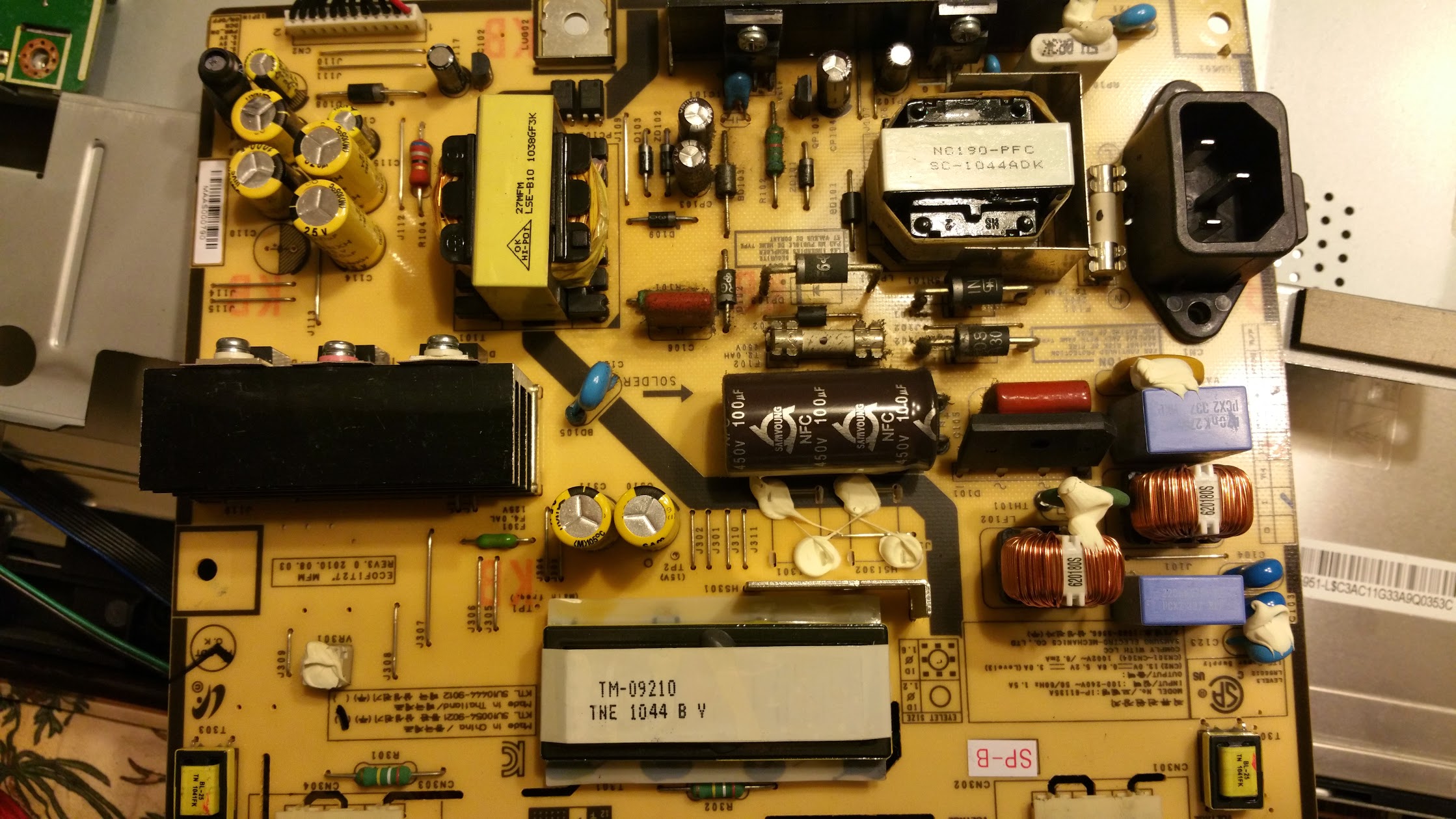

    My son's Samsung p2770hd seems to have died. It turns on for a few seconds. It shows the input in the upper left corner of the screen and then goes black. If I switch to the ota tuner it will show snow for a coupla secs before it goes black. I tried holding a bright flashlight up to the screen but was unable to see an image as some posts on this site have suggested.
    I've disassembled it and took some images. The middle of the bn44 piece looks like it has "dark fur". Also not easy to see, one of the voltage regulators looks like it got real hot (dark around board).
    Any help welcomed.

    try with other lamps, if not working, thange the TM-09210

      I have same TV with similar problem, but the boards look brand new, no "fur". All caps look good, and the fuses check OK. The HV output transformers show continuity. Screen and high voltage turn on for a second, then the high voltage goes away (tested with Fluke voltage detector). Sound and front LED work fine.
      Originally posted by angel-boy
      try with other lamps, if not working, change the TM-09210
      Did changing the TM-09210 inverter transformer work?
