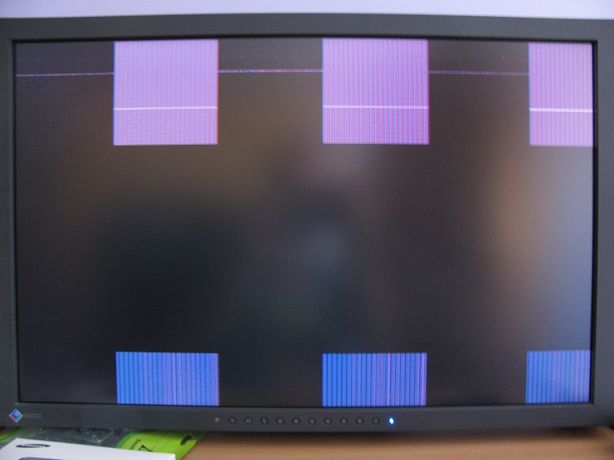

    I got Eizo S2431W with artifacts. It has Samsung 24'' LTM240M2-L01 S-PVA panel. I have couple of 24'' TN here so I tried it with one of them, image is OK.
    Now the question is if the problem is on the TCon or display itself? I have tried swapping TCon boards but they are not compatible, different signalling for TN and S-PVA.

    Re: Samsung LTM240M2-L01 artifacts: T-con or display?
    It was bad TCon, I got HP LP2465 with the same display (and bad signal board), after replacing it the display is OK.

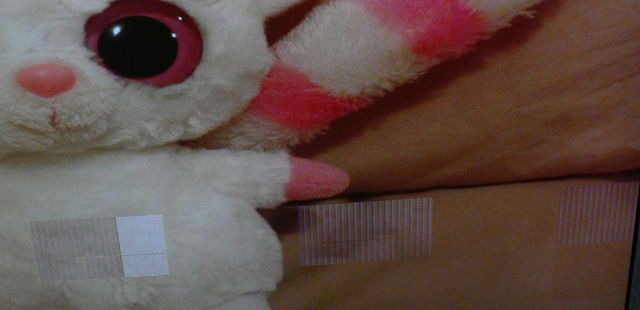

      Have you repaired that Eizo? My monitor started to show similar artifacts... if it's caused by bad t-con, it'll be very good news for me. It's much cheaper that bad LCD panel
          Actually I got also a second one, that one had bad display. The first one only had bad TCon. So you can start with the TCon…other than that I can provide a TN panel or buy the remains and install the panel in it. Still better Eizo with good TN than Eizo with bad S-PVA
          That image seems more like bad display, but you can try, TCons are quite cheap from Aliexpress now.
                My problem starts as three horizontal lines artifacts, then after few days it started to show six of them, yesterday it surprises me with artifacts I just post here. It gets worse rapidly...
                        I've just replaced the TCon board I bought on AliExpress and it was a success... monitor is as good as new
