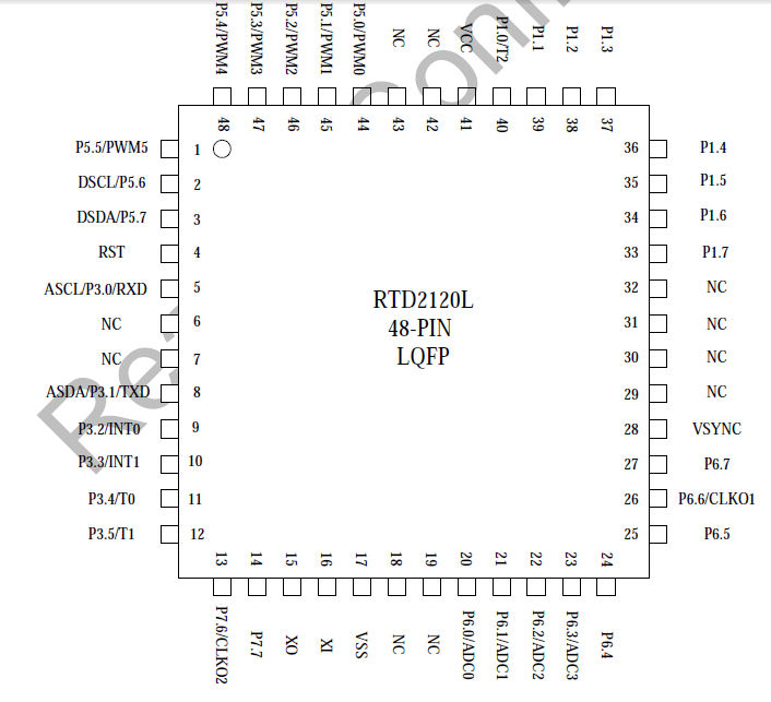

Acer X223W is black without led
  • fred69
    • Jan 2013
    • 18
    • france
    Re: Acer X223W is black without led
    The "service manual" available online until now detail the components TSUMU58BWHL or TSUMU58WHJ. However, my card uses a RTD2553VH.
    I managed to find the datasheet for RTD2553V. I do not know the difference with RTD2553VH.
    I do not know much in the study of digital chips.
    People would be able to identify the inputs and outputs to test please?
    • fred69
      • Jan 2013
      • 18
      • france
      Re: Acer X223W is black without led
      I tracked on the map scaler, the voltage from the ON/OFF button from the connector CN101 to RTD2120L component. The ON/OFF signal reaches pin 9 (INTO P3.2) of the component.
      I expected to see out on another pin but no other reacts to pressing the button.
      I made a list of the tensions on all pins of the component RTD2120L to see if my device was faulty.
      Here is the statement
      pin | V read | Observations
      1 | 3.2V | P5.5 PWM5
      2 | 0V | P5.6 DSCL
      3 | 0V | P5.7 DSPA
      4 | 0V | RST
      5 | 3.2V | ASCL/P3.0/RDX
      6 | 0V | NC
      7 | 0V | NC
      8 | 3.2V | ASDA/P3.1/TXD
      9 | 3.2V --> 0V | button "ON/OFF" INT0 P3.2 (0V to the pressing button)
      10 | 3.2V | INT1 P3.3
      11 | 3.2V | P3.4/T0
      12 | 3.2V | P3.5/T1
      13 | 3.2V | P7.6/CLK02
      14 | 3.2V --> 0V | button "MENU" P7.7 (0V to the pressing button)
      15 | 1.68V| XO crystal OUT
      16 | 1.68V| XI crystal IN
      17 | 0V | VSS (ground)
      18 | 3V | NC
      19 | 0V | NC
      20 | 3.2V|P6.0/ADC0
      21 | 3.2V --> 1.8V | button "+" P6.1 ADC1 (1.8V to the pressing button)
      22 | 3.2V --> 0V | button "AUTO" P6.2 ADC2 (0V to the pressing button)
      23 | 3V | P6.3/ADC3
      24 | 3.2V | P6.4
      25 | 3.24V | P6.5
      26 | 1.7V | P6.6/CLK01
      27 | 1.8V | P6.7
      28 | 0V | VSYNC
      29 | 0V | NC
      30 | 0V | NC
      31 | 0V | NC
      32 | 0V | NC
      33 | 3.2V | P1.7
      34 | 3.2V | P1.6
      35 | 3.2V | P1.5
      36 | 3.2V | P1.4
      37 | 3.2V | P1.3
      38 | 3.2V | P1.2
      39 | 3V | P1.1
      40 | 3.2V | P1.0/T2
      41 | 3.2V | VCC
      42 | 0V | NC
      43 | 0V | NC
      44 | 3.2V | P5.0/PWM0
      45 | 3.2V | P5.1/PWM1
      46 | 0V | P5.2/PWM2
      47 | 1.8V | P5.3/PWM3
      48 | 3.2V | P5.4/PWM4
      My signal ON/OFF should be out by what component RTD2120L pin?
      Tension seems suspicious to you?
        09-06-2024, 05:27 AM
        Acer Swift Acer Swift 3 Ultraschlankes Notebook Notebook 3 Specification for Upgrade or Repair
        This specification for the Acer Swift Acer Swift 3 Ultraschlankes Notebook Notebook can be useful for upgrading or repairing a laptop that is not working. As a community we are working through our specifications to add valuable data like the Acer Swift 3 Ultraschlankes Notebook boardview and Acer Swift 3 Ultraschlankes Notebook schematic. Our users have donated over 1 million documents which are being added to the site. This page will be updated soon with additional information. Alternatively you can request additional help from our users directly on the relevant badcaps forum. Please note that...
        09-07-2024, 05:00 AM
        Acer Aspire Acer Aspire 7 Charcoal Black Notebook 7 Specification for Upgrade or Repair
        This specification for the Acer Aspire Acer Aspire 7 Charcoal Black Notebook can be useful for upgrading or repairing a laptop that is not working. As a community we are working through our specifications to add valuable data like the Acer Aspire 7 Charcoal Black boardview and Acer Aspire 7 Charcoal Black schematic. Our users have donated over 1 million documents which are being added to the site. This page will be updated soon with additional information. Alternatively you can request additional help from our users directly on the relevant badcaps forum. Please note that we offer no warranties...
        09-07-2024, 05:00 AM
        Acer Nitro Acer Nitro 5 Black Notebook 5 Specification for Upgrade or Repair
        This specification for the Acer Nitro Acer Nitro 5 Black Notebook can be useful for upgrading or repairing a laptop that is not working. As a community we are working through our specifications to add valuable data like the Acer Nitro 5 Black boardview and Acer Nitro 5 Black schematic. Our users have donated over 1 million documents which are being added to the site. This page will be updated soon with additional information. Alternatively you can request additional help from our users directly on the relevant badcaps forum. Please note that we offer no warranties that any specification, datasheet,...
        09-07-2024, 04:10 AM
        Acer Aspire A317-53-32Z4 + Pack Gold Acer 17'' Notebook 3 Specification for Upgrade or Repair
        This specification for the Acer Aspire A317-53-32Z4 + Pack Gold Acer 17'' Notebook can be useful for upgrading or repairing a laptop that is not working. As a community we are working through our specifications to add valuable data like the A317-53-32Z4 + Pack Gold Acer 17'' boardview and A317-53-32Z4 + Pack Gold Acer 17'' schematic. Our users have donated over 1 million documents which are being added to the site. This page will be updated soon with additional information. Alternatively you can request additional help from our users directly on the relevant badcaps forum. Please note that we...
        09-07-2024, 03:10 AM
