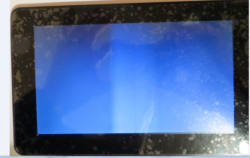

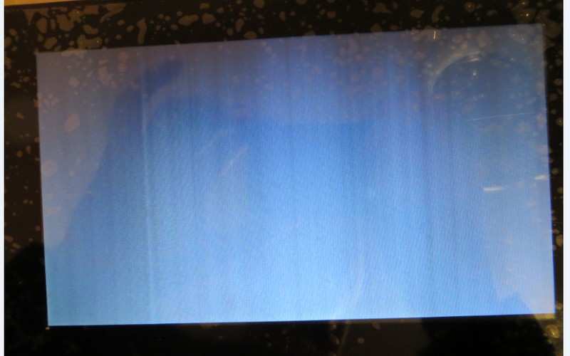

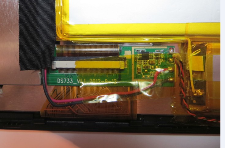

    Bought this tablet for $20. Seller say he had it for about a week and dropped it on it's face. The LCD now shows grey/white lines. Hoping it was a loose ribbon cable - no luck.

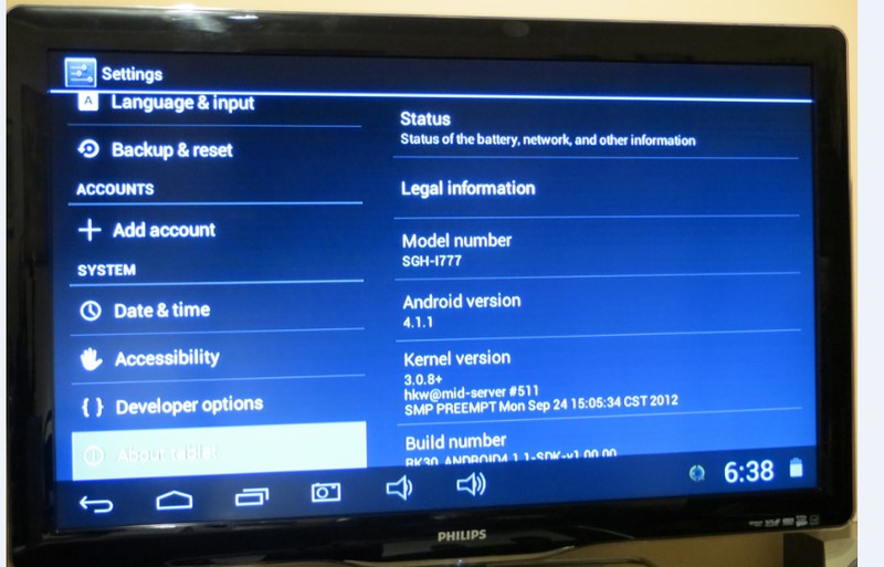

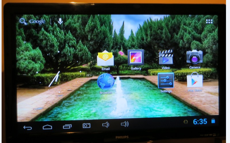

    It has HDMI out so I know everything work, including the touch screen. I updated the firmware but no change.

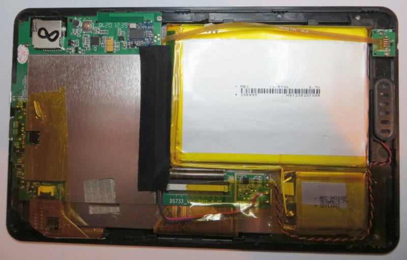

    I've reseated the LCD dispaly cable a number of times. I don't see any obvious damage to the boards or anything.

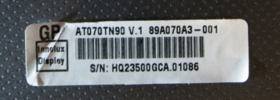

    Any ideas of things to try? Since the HDMI video out works, is it likely a damaged LCD itself? Is there a way to test it?
    I can buy a new LCD for $30 but I don't want to sink anymore $ if it may not work. I can live with the $20 - it was fun to work on and it works fine through HDMI.
    It is a nice little tablet, ironically the display is the weakest feature.
    Some pics and specs below.

    Features and Specifications:
    Rockchip RK3066, 1.6GHz, Cortex A9 dual core; GPU: Mali 400 MP4
    8GB Nand Flash memory, support TF card up to 32GB extended
    7" capacitive screen, 800 x 480px resolution
    Wi-Fi: 802.11 b/g/n
    Front 0.3MP camera
    HD 1080P video playback
    Software and Applications:
    Android 4.1 OS
