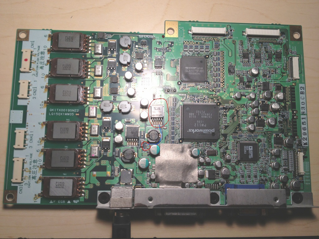

    I have an old Compaq TFT5030 LCD that won't turn on. Dead when hitting the button.
    Heres what I have found. You'll notice in the pic 2 red circles and a blue line between them. The lower red circle is a fuse - it's blown. The blue line follows a trace up to a regulator numbered SK 8033JD (data sheet http://pdf1.alldatasheet.com/datashe...SI-8033JD.html ).
    The 8033JD pins measure as follows 12.33V, 6.94V, 0, 6.88V, 2.428V
    According to the data sheet, the output should be 3.3V, not over 6V.
    Let me know if I'm correct on this, but it appears this regulator is double the output it should be and it blew the small fuse.
    If I'm right, where can I find this regulator? I can't find a cross at digikey. If I'm wrong, let me know where I went wrong! And what should I do next!
    Yes, when something outputs close to double the correct voltage there will be some collateral damage.
    Here is how I did the search in digikey.com
    1) From the SI-8000JD datasheet, I see the words "step down switching mode regulator".
    2) Then I click on "in stock".
    3) Then I narrow down the search by selecting output type = fixed.
    4) voltage-output = 3.3V
    5) supplier device package = to263-5 (from datasheet)
    6) click apply filters and I have 14 choices
    7) I choose this one (1A output current) and lowest price
    http://search.digikey.com/us/en/prod...NOPB-ND/363645
    because that part number is sort of fresh in my mind from 2 days due to this thread ...
    https://www.badcaps.net/forum/showthread.php?p=220909
    8) Double check the original and replacement datasheet to make sure the parameters are correct.
    9) You might be able to find this IC on an old junk motherboard as 3.3V is commonly used.

      UPDATE: I replaced 8033JD with LM2575S-3.3/NOPB from DigiKey, and also the blown fuse. It powers up and it works great! Thanks for the help!
