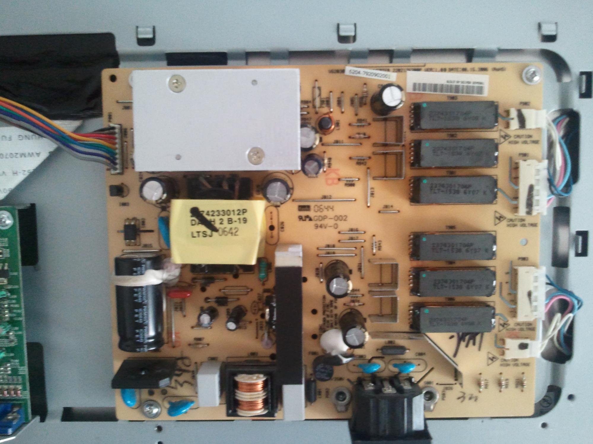

    The capacitors I removed I could see that there were five that were bad.
    However the repair did not fix my problem, before I repaired the monitor it had a dark screen and the blue lite on the front of the monitor would flash. After the repair I got the message on the screen that the analog signal was missing and the blue lite stayed lit. When I installed the monitor cable the same problem with dark screen and flashing blue lite. I am unable to bring up the menu options also. The capacitors did correct some problems because I never got the no signal message before. There is still a problem in the signal circuit that feeds the video card, would you know what it could be. Without an electrical drawing I have no way of reading correct voltages.
  • retiredcaps
    • Apr 2010
    • 9271
    Re: view sonic vx2035wm flashing blue power lite dark svreen
    config term

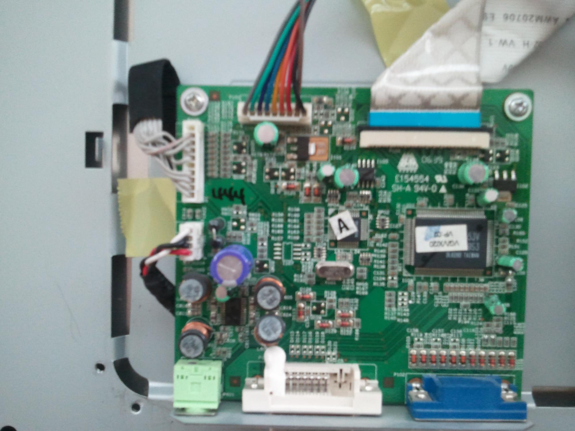

    1) Post top down view pictures of your all boards so we can suggest test points. (i.e. show tech-support)
    2) Follow the instructions in my sig file below exactly. Please do not post inline.
    3) What brand and series did you use for replacement capacitors?

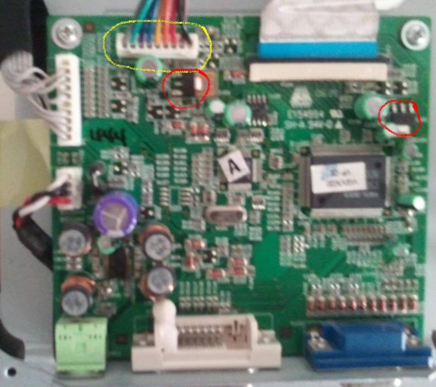

        The main board picture is a total blur, I can see enough.
        1) If you have a multimeter, measure the connector (circled in yellow). All the pins will be DC voltage. Use a ground screw for your black probe. Report all your voltages.
        2) Circled in red are two voltage regulators. Measure all 3 pins (ignore the fat tab). List the part number as well for each regulator. Report it like
        U1
        AL1117-33
        pin 1 = 0.0V DC
        pin 2 = 3.29V DC
        pin 3 = 5.01V DC
        edit: Pic should now be uploaded.

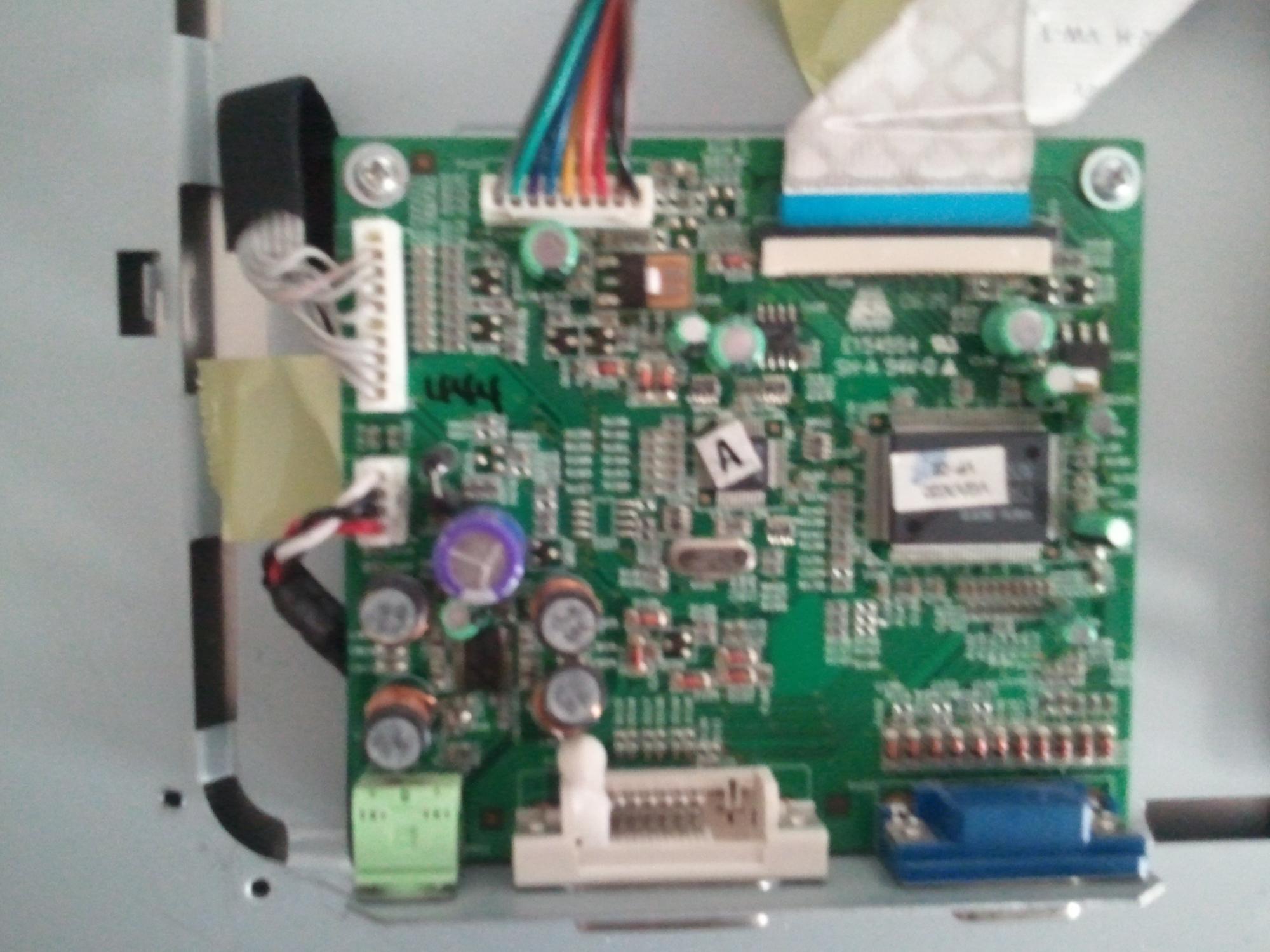

          I got a little better pic ov the video card

            I assume on the voltage regulators the pins go left to right for pin 1 to 3
            • retiredcaps
              • Apr 2010
              • 9271
              Yes. Again, use a ground screw for black probe (ground).

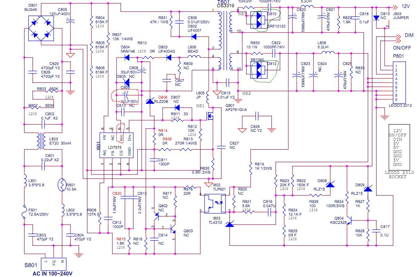

                Searching "vx2035wm schematic" brings up
                Page 47 has a schematic of the power supply and the voltages for P801

                    Page 39 has the DC to DC schematic for the 2 voltage regulators that I asked about.
                    One is 3.3V and the other is 1.8V output. Your readings should be +/- 1% of those output voltages.

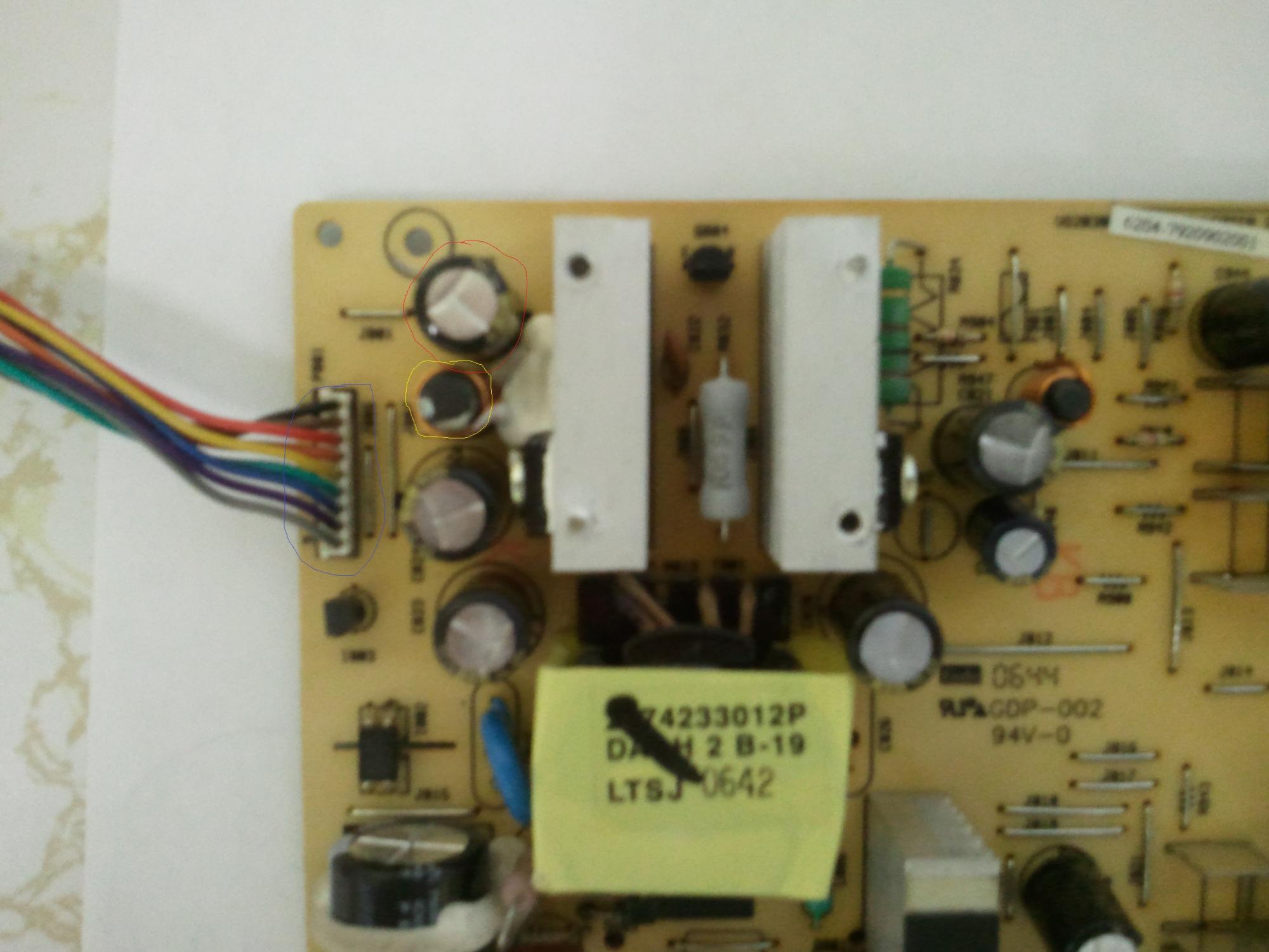

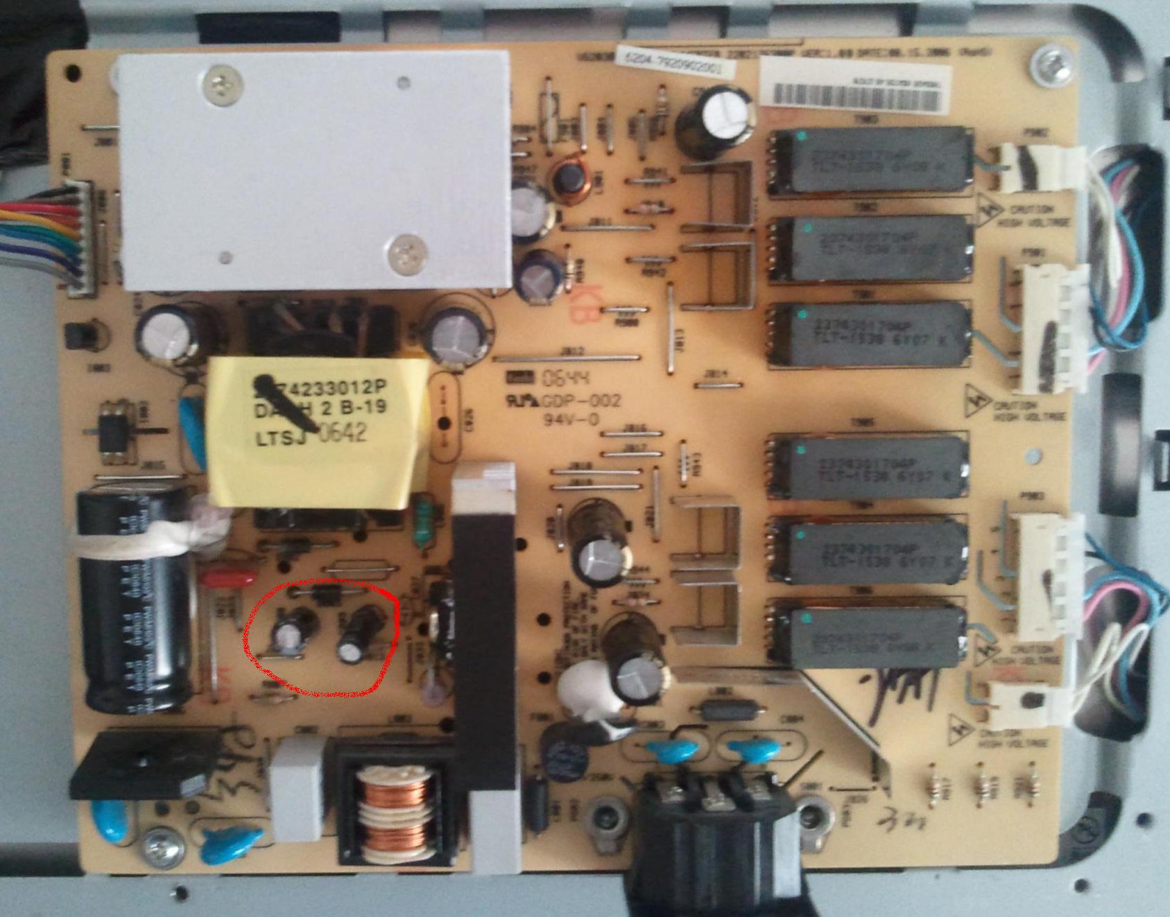

                                I found a bad conection at the soder joint of c825 + side and the soder trace to L808. The circuit board trace came loose on the positive side. By moving the cap and using an ohm meter I can make the connection come and go. That positave lead connects to pins 4,5, and 6 of P801. I'm thinking this is my source of fluxuating voltage. Cap 825 is one I replaced and I either messed up the connection on taking the old cap out or installing a new one. I'll repair the trace and I may as well replace the two caps you wanted me to replace.
                                • Jwh8000
                                  • Feb 2012
                                  • 20
                                  I circiled c825 P801 and l808on the attachmment
                                  • retiredcaps
                                    • Apr 2010
                                    • 9271
                                    It could be, but all your voltages are fluctuating expect pin 9.

                                      I replaced the two caps and fixed the loose connection on c825 and I still have the same problem. Any ideas
                                      • retiredcaps
                                        • Apr 2010
                                        • 9271
                                        Refer to the schematic.
                                        1) With power off and lcd unplugged, test diodes D810 and D812 using the diode test function on your multimeter. Report your diode measurements. You should have 4 readings per diode.
                                        2) With power off and lcd unplugged, measure the resistance between pin 6 (Vcc) and pin 4 (GND) on I801. Report your ohm measurement.
                                        3) With power on and lcd turned on, measure the DC voltage across C809 (10uF 50V). Report measurement.
                                        4) With power on and lcd turned on, measure the DC voltage on pin 6 (Vcc) using pin 4 (GND) as ground on I801. Report measurement.
                                        5) Check all your soldering work for solder bridges and gently tugging on all caps to see if they are held in solid.
