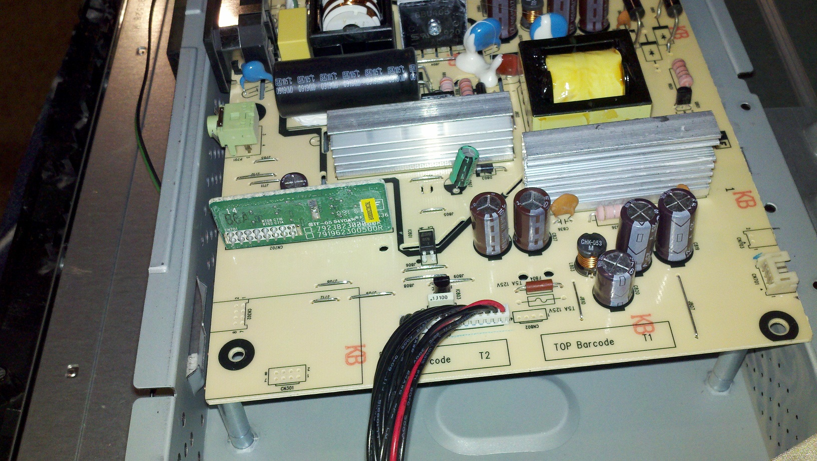

    My wife's 23" Acer P235H monitor went out several months ago and I thought all was lost. That is until I started browsing the Internet and saw that this issue may be easily fixable!
    She has the issue I see most common where the screen goes black after a few seconds and you can still see the image using a flashlight. So I was exicted to see that there were lots of boards you could buy on ebay, etc...and they were cheap! I took some time last night and opened the monitor up (took awhile, stupid plastic would NOT come apart) and was shocked to see this huge board in there...not like the small cheap inverter boards I was seeing online. So to replace the board is going to be around $50...so I figure I would try to fix it myself first.
    I just read the "2 Second Black" thread and got some good pointers. None of my capacitors seem to be blown...but by reading that thread, they may not show any signs of damage.
    I have posted some pictures here as I have NO CLUE what I am doing. Can someone point me to which capacitors I shold focus on replacing first? I would like to do these one step at a time in case I make a mistake. Any other hints, suggestions, would be welcome. Guess I need to buy a soldering iron tonight.

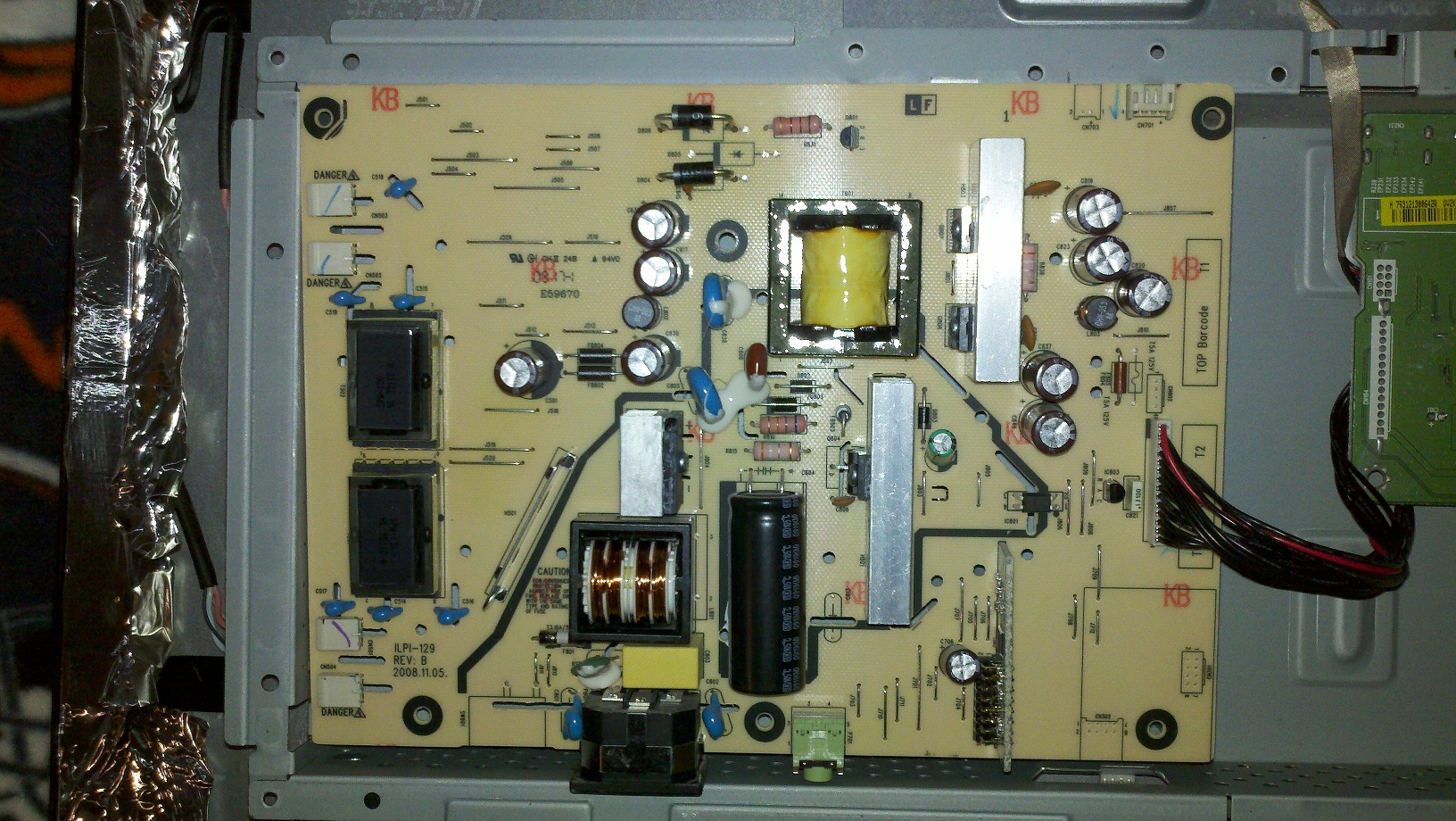

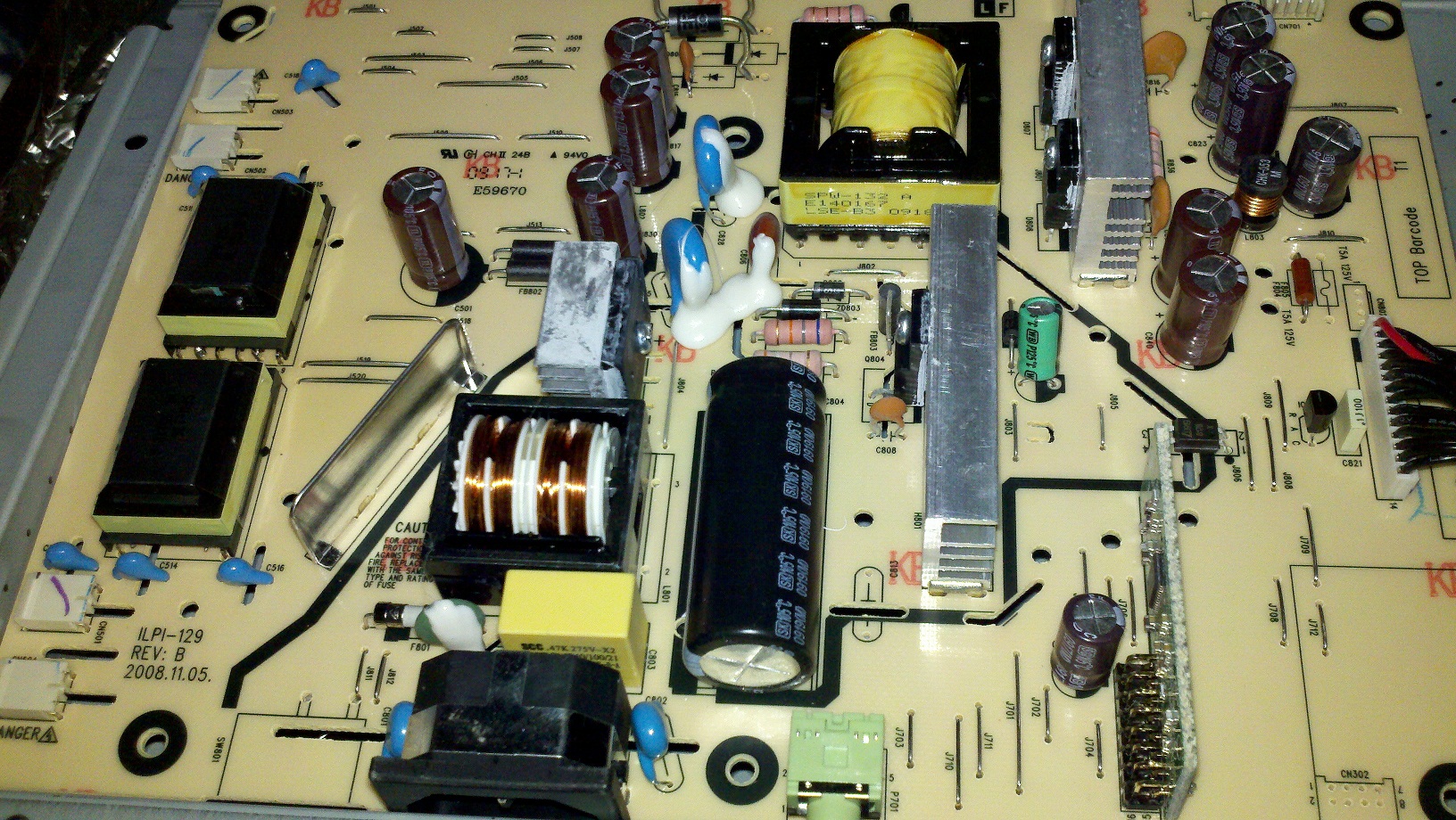

    I think this MUST be the correct board as well. There is a smaller square board in the monitor as well that holds all the "connections"...HDMI, VGA, etc.

      1) BEFORE doing anything, read through troubleshooting 2 seconds to black at
      https://www.badcaps.net/forum/showthread.php?t=10419
      starting with post #19.
      2) 2 seconds to black can be (in no particular order)
      a) bad caps
      b) bad ccfls
      c) bad ccfl wiring (return wiring)
      d) bad inverter transformer
      3) If you have a multimeter, check for a bad transformer. Your secondary pins might be pin 7 and 8.
      4) Check the ccfls next.

        Thanks for the reply. Getting back to my original question...if I do need to replace the caps on this board, do any of you know which ones I should focus on? Being a newbie, I would rather not have to replace every single one if I can avoid it.
          Re: Acer P235H Black Issue
          As I explained in my guide, IF the problem are caps, you can't tell which caps are bad by looking at them. Picking out one or two is impossible.
          There are at least 4 possible things that can be your problem and you should at least look at the other 3 if don't want to solder.

            Okay...thanks. I don't have a voltage meter...so my options are limited. I could buy a new board for $50 which would be cheaper than buying a soldering iron and a meter.
            I will try to replace all the caps first and see what happens. That seems to be the cheapest option right now. I was only asking about the caps because I thought that only certain ones would cause this issue...thanks for the advice...much appreciated.
