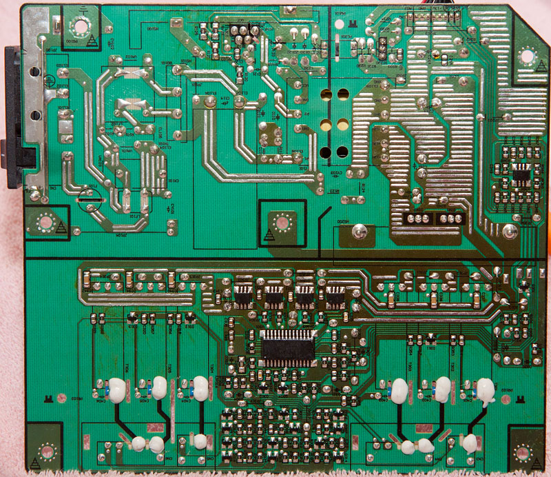

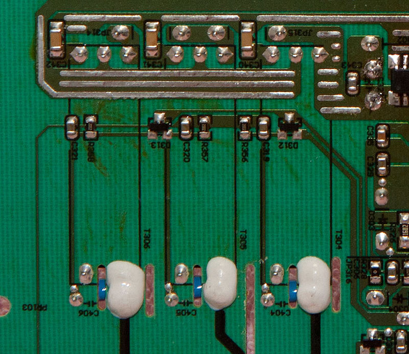

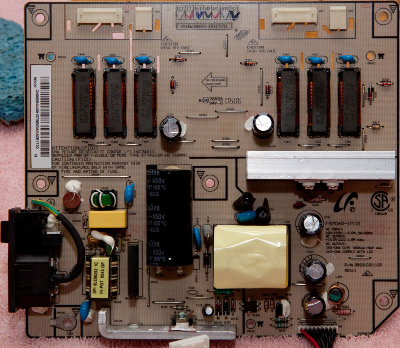

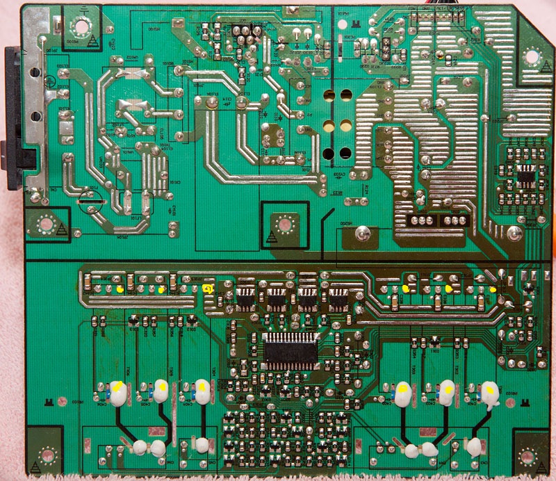

      Attached are pics of a duplicate board that hums. Also note the caps in between the transformers are supposed to be 13mm in Dia but the supplier sent me 10mm. Problem?
      Also a closeup shot of some discoloration on the boards bottom.
      I did not post the actual board because its still assembled but it is the same part number.
      The purpose here is hopes for you to help me with the test pins locations, and to show you a second board and ask about the 10mm vs. 13mm.
      Let me know if if the pics are ok and if you need to look at the actual board. Thanks!

        I've placed a yellow dot on each end of the secondary. It appears that all six transformers have one end of the secondary tied to the same point, probably ground. The other end is covered in insulation. I'd suggest just probing the pin in the connector.
        The critical parameters on replacement caps include capacity - exact match is important, voltage - don't go lower, ESR (impedance at 100Khz) - don't go higher - and physical size - you must be able to get the covers on. A smaller diameter should not be a problem provided the other parameters are met.
        PlainBill
