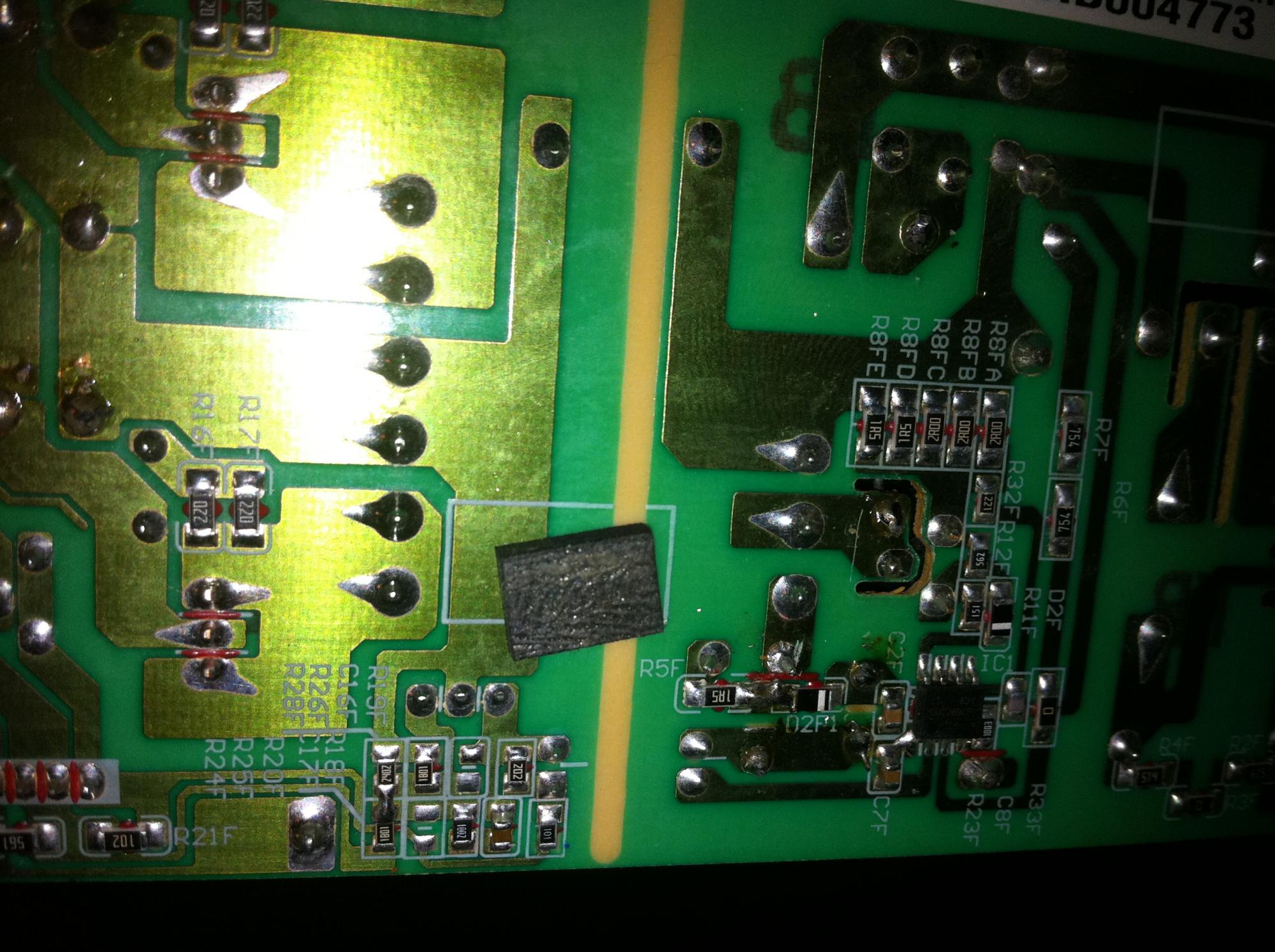

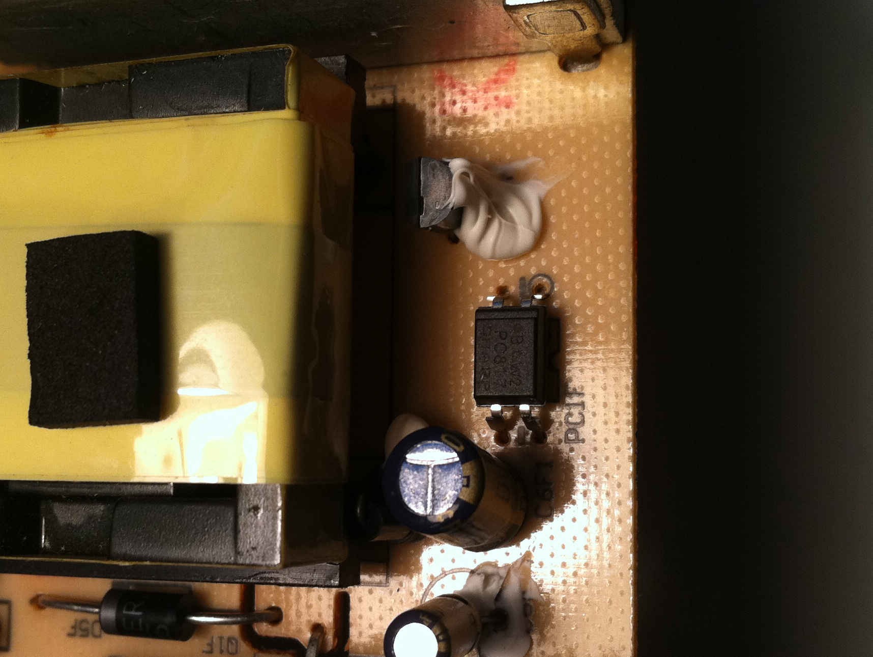

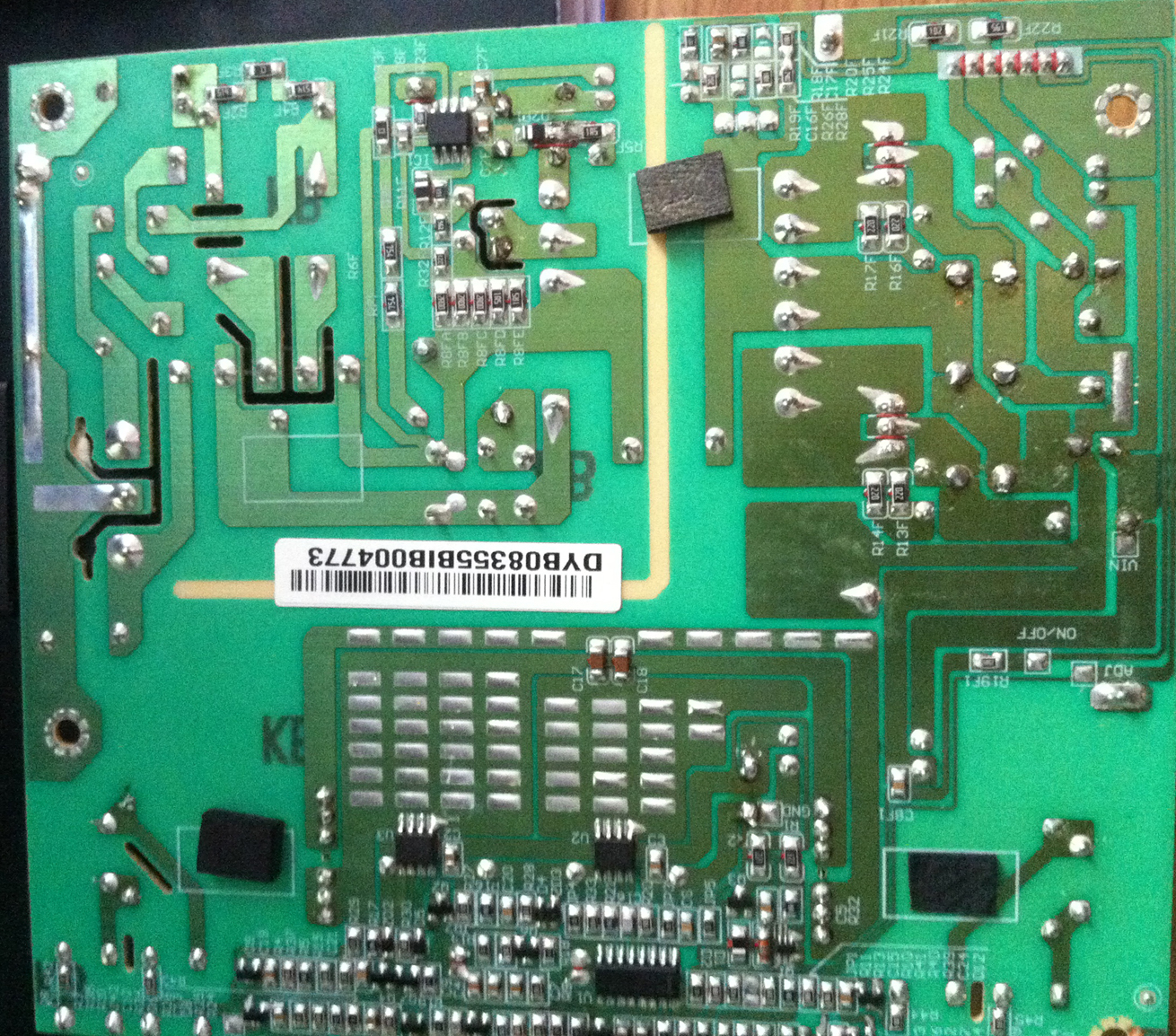

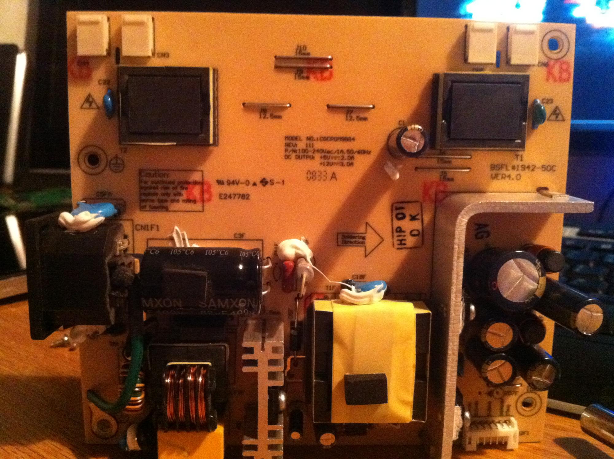

    Basically, my girlfriends sister's monitor decided to die on her a while back. At the time I wasn't feeling up to the task of looking at it properly so I asked her what had happened. She said it just cut out and she smelt smoke. No problem I thought to myself. If there is smoke then I can find the source of the damage... However, When I opened the monitor up I found no damage at all, apart from the shockingly crap caps that the manufacturers had used. I replaced all of the caps on the inverter, apart from one (a large 82uf 400v samxon one which looked fine) and I put the monitor back together, pretty confident it would work. Alas, it wasnt that easy, so I gave up and she ended up buying a new monitor. Right, now on to the current situation. I saw the monitor laying by the bin ready to be trashed so I asked if i could take it anyway to have another go at it, which I was told was fine. Since then I've checked all 4 CCFL's and the solder connections on them - they are fine. I did this because while I was testing the tubes by plugging them in 1 by 1, one of them would make a hissing sound prior to shutting off - which I'm pretty sure was the transformer closest to the tube plugged in. I kept testing and this somehow decided to go away, which slightly baffles me actually. Anyways, when I'm back from work tomorrow and not so sleepy, I intend to re-solder the transformers and a few other areas of interest, but other than doing that I'm not too sure what to do from here. I feel bad everytime I post here as it must really seem like im not learning, but i promise i am! its just taking a while to sink in hehe ^^ anywho, here are some pictures, thanks guys - I just wanted to add, I keep getting a random smell of electronics/burning, but nothing is getting hot and I can't find the source. I read this could be leaking 'eco' from the CCFL's, but they seem okay. I would test them with a different inverter or I would try different CCFL's if I had any... I do have a CCFL case kit but the connectors are wrong, and I would rather not mess with my CCFL's in my case as ive already had to re-solder the wires once due to me tearing it out accidentally xD
    P.S I know the solder joints for the caps i replaced look terrible.. it's because I did it at my girlfriends house using her dads soldering iron... which has a pretty chunky horrible tip, plus I was rushing.. so I do intend to fix the mess i made and use a little pcb cleaner :P

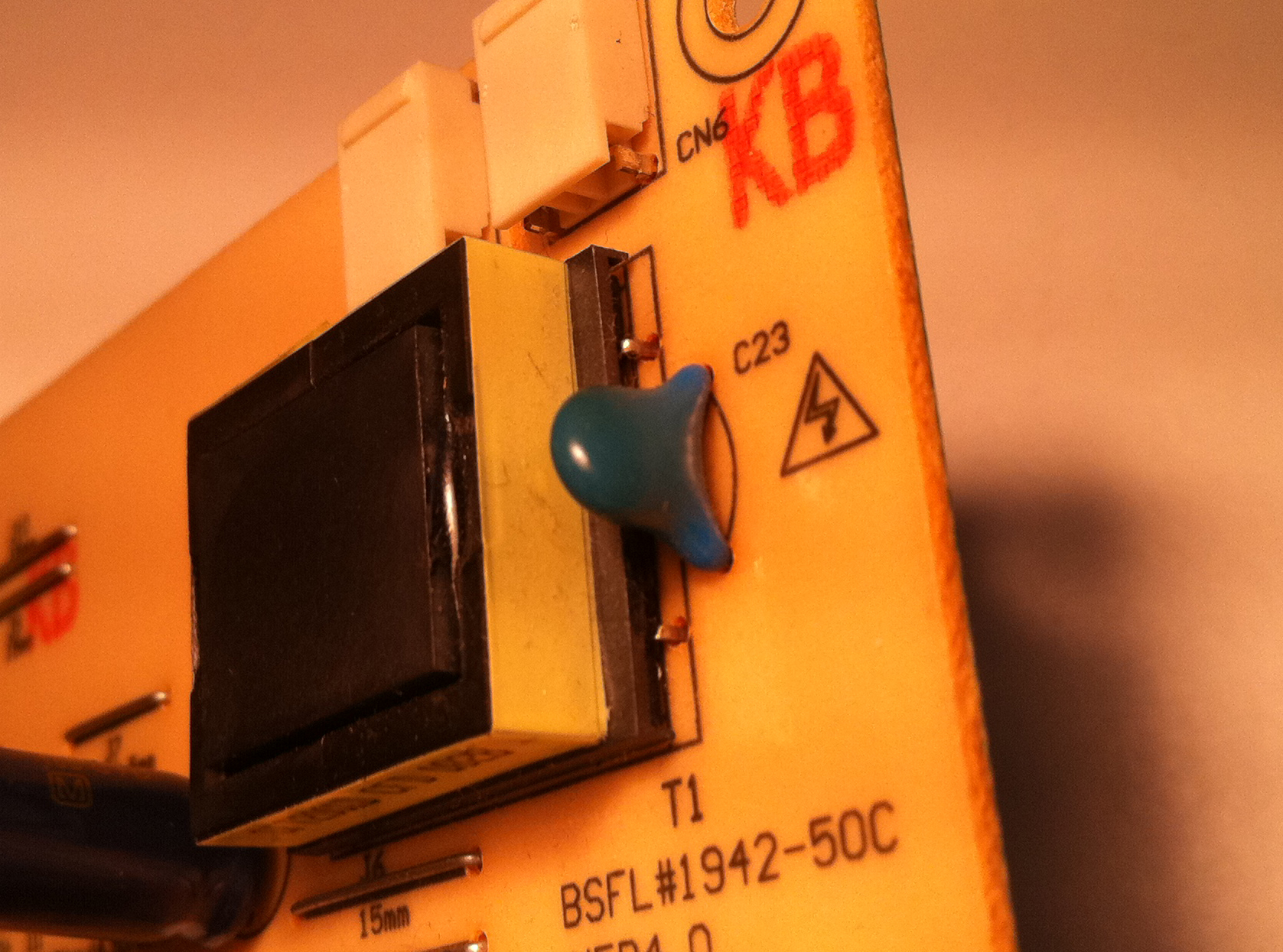

            edit 2: I have a bit more info on this board. I was just looking about and I think I may have found the fuse I've blown, plus there is something which stuck out that I didnt notice before, as as far as I know the component in question generally doesnt fail o.O its a small blue flat round cap (I think) labeled C23 - While comparing it to the other blue flat caps that look the same I noticed that this one seems almost blackened somehow. I will attach pictures of this plus the possible fuse I blew - (labeled F1F) Sorry for the trouble here. Also the component labeled PC1F smells a little toasty, so I thought I would mention that. It may not be anything related.

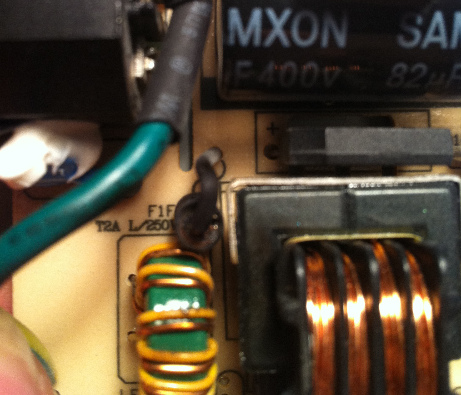

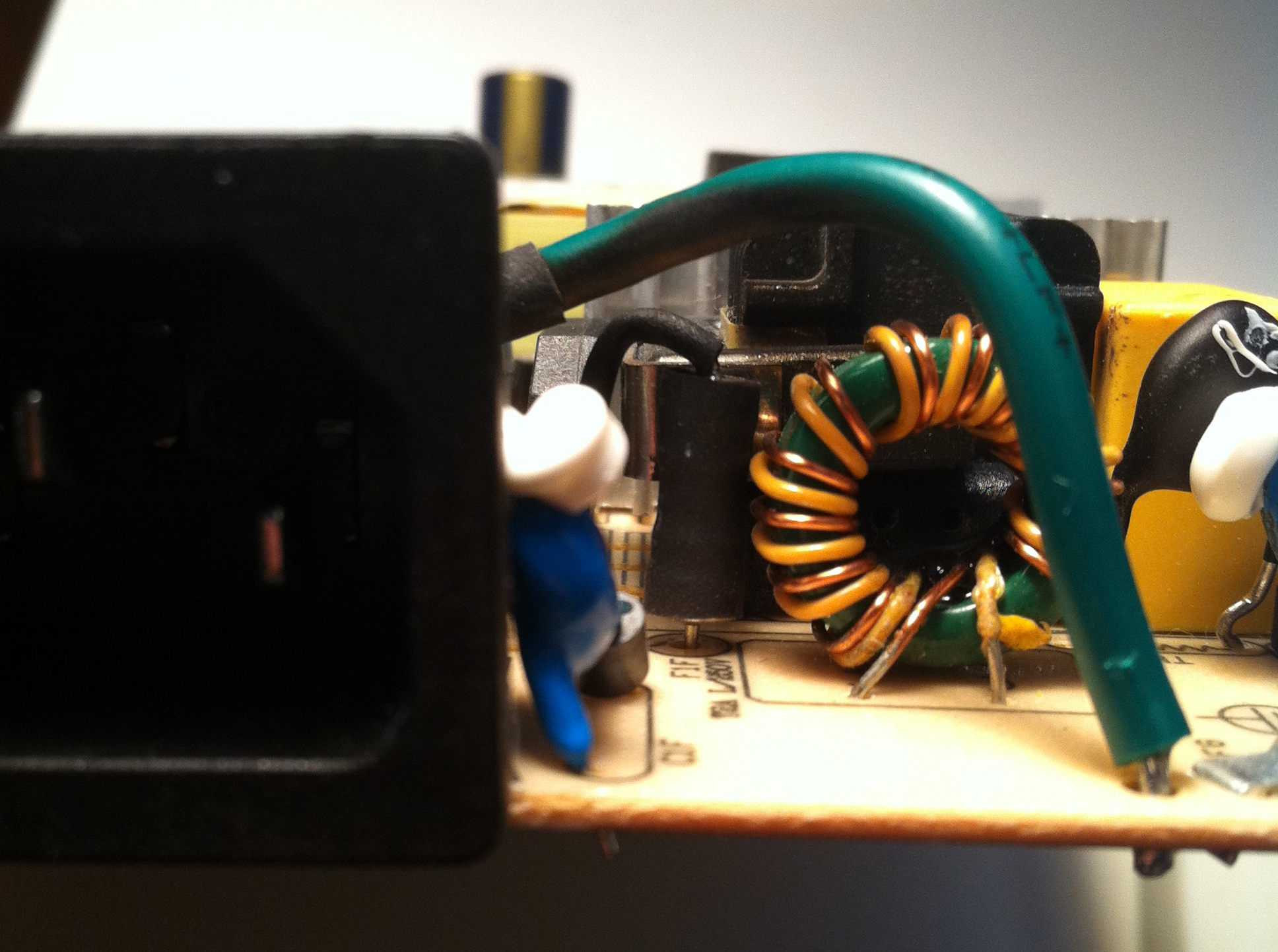

              I can confirm the thing I thought was a fuse, in fact was, and it was gone. At first I couldnt find any information on the fuse as it said "RSFR-H" on the side.. then I realised this was a type of shrink wrap ¬_¬ so I removed that to find the fuse underneath. On the fuse is "3N T2A 250V" So i will try and find a suitable replacement. Thanks again for the help, and hopefully I will figure this out soon hehe :P
              would this be a suitable replacement? -
              http://uk.rs-online.com/web/p/fuses-cartridge/7032629/

                Sooner or later most people do something really stupid when learning to repair electronics. Have you identified the location of the points that were shorted by contact with the metal plate? I see one spot that looks suspicious, if it occurred in the neighborhood of R5F and D201?, more than just the fuse might have been damaged.

                  I will be honest, that area is actually a result of shoddy solder work which I attempted to fix. I think I may have scorched the board a tiny bit with the soldering iron, but it was not the part which touched the metal casing. Im pretty sure that (i guess i can call it lucky) the part of the board that touched was around the fuse area that actually blew. I put the pcb back against the metal (obviously no power this time haha) and its the only part of the board that touches, as the rest has the little rubber pads intact and it keeps it just floating above the metal. Ive ordered a new fuse and im looking in to testing the transformers properly. I found a few good videos on youtube showing how =] I know I had to check the resistance and make sure it was within 3%, but im that much of a novice that I didnt know what setting to put the multi meter on. Also something I didnt mention, though it may not be all thats important. When the backlights went out after a few seconds, the solid blue power led just flashes for a while, as in the whole "No signal" style of flashing. - i have no input plugged into the monitor during this. Thanks again. I will test these transformers and wait for my fuse for the time being.

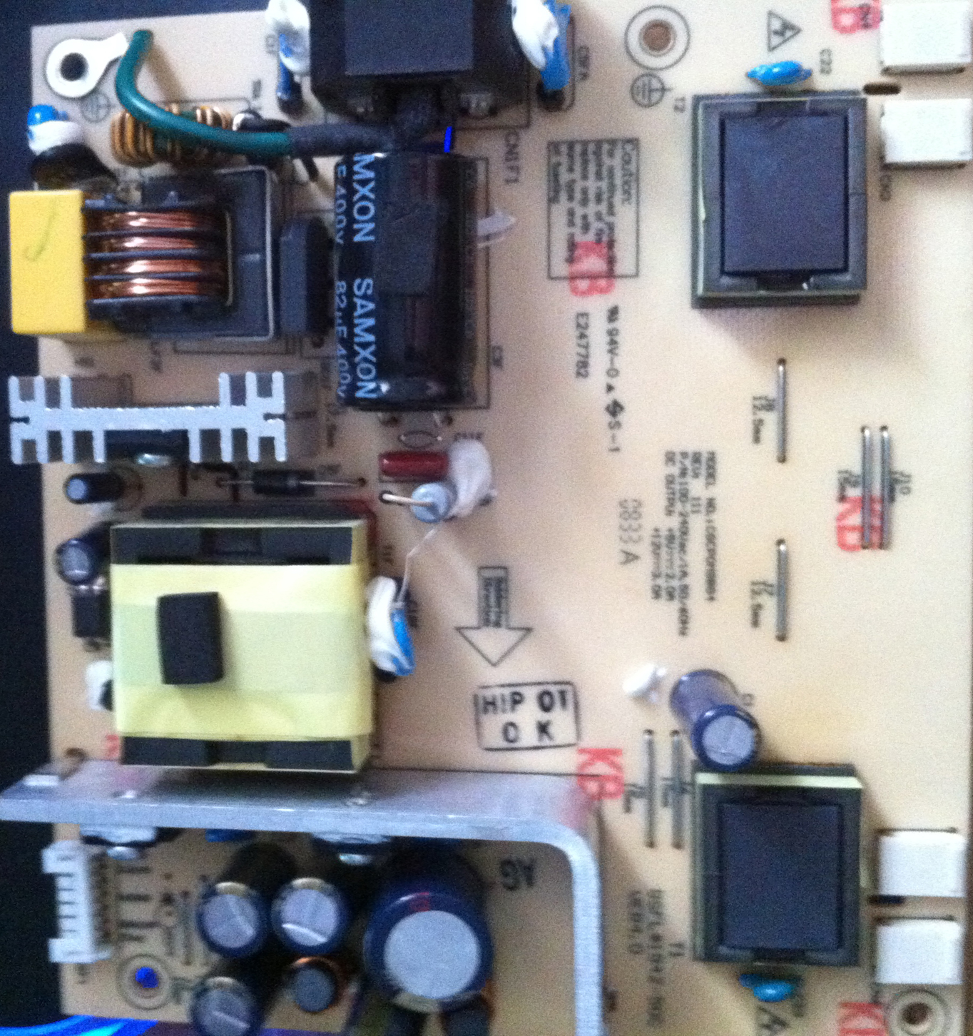

                    I really wish I could edit posts rather than having to make a new most. I feel like i'm spamming a lot. Anyway, I tested the transformers properly and after doing more research and reading (I read the comprehensive guide written by retiredcaps, which was extremely helpful). The transformers are as follows -
                    Using Multimeter set to 2k ohms
                    T2: | T1:
                    1 to 2 - .001 | 1 to 2 - .001
                    1 to 3 - .001 | 1 to 3 - .001
                    1 to 4 - 1 | 1 to 4 - 1 - earthed? (It's the pin which is not connected to anything, right in the middle)
                    1 to 5 - .001 | 1 to 5 - .001
                    1 to 6 - .001 | 1 to 6 - .001
                    1 to 7 - .001 | 1 to 7 - .001
                    Secondaries - .945 | Secondaries .944
                    as for pin 2 to 3, 3 to 4 etc, they are all .001 as well, on both T1 and T2
                    I decided to check D3F and D4F (The two MOSFET looking things along the heatsink
                    from them using the multimeter on 200 ohms setting I got this -
                    D3F
                    pin 1 to 2 - 1 (too high to read it? - it flashes up with a high number before going to 1)
                    pin 1 to 3 - 00.8
                    pin 2 to 3 - 76.1
                    D4F
                    pin 1 to 3 - 00.7
                    pin 2 to 3 - 95.4
                    I also checked the Diode - D5F as It could be a possiblity, but the results were :
                    nothing 1 way, and the other on 2k ohms was around 452.
