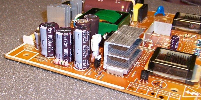

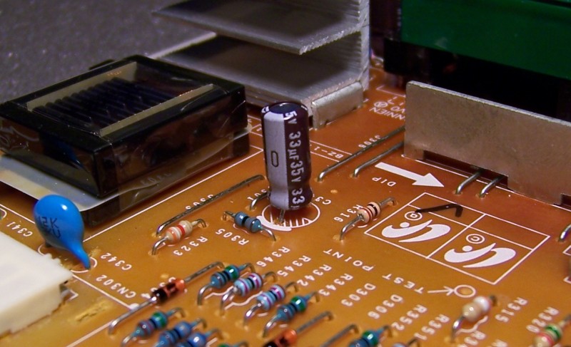

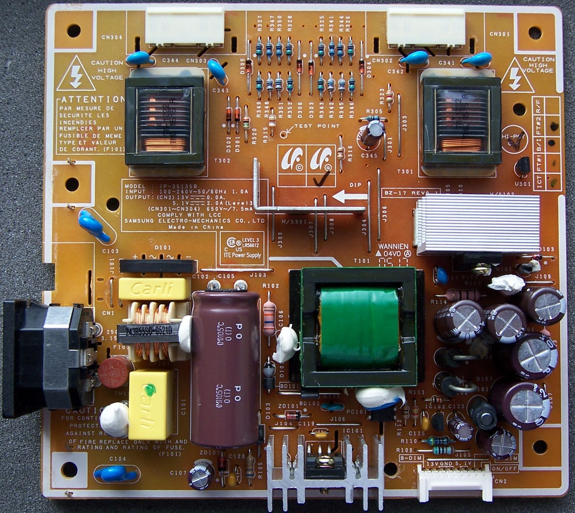

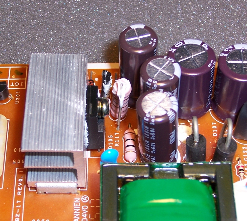

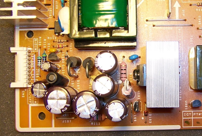

    A while ago I was given a dead Samsung 930B and made an attempt at fixing it by replacing the obviously damaged electrolytic caps. On my first attempt i replaced:
    cap# orig uf/v ---> new uf/v
    301 820/25 820/25 nichicon pw
    111 820/25 820/25 nichicon pw
    112 820/25 820/25 nichicon pw
    109 1000/10 1000/25 nichicon pw
    110 1000/10 1000/25 nichicon pw
    When I pressed the power button the green LED stayed on followed by a high pitched screeching noise coming from everywhere on the board. I replaced the rest of the electrolytics inluding the large one. Here's the rest of the list showing what I replaced:
    113 330/10 330/16 nichicon pw
    123 10/50 10/50 nichicon pw
    107 47/50 47/50 nichicon pw
    105 100/450 100/450 chemicon kxg
    345 33/25 33/35 nichicon pw
    Now the screeching is gone, it's all nice and quiet. When pressing the power button the LED is green and steady. It appears fine but there's no backlight whatsoever. I can faintly see a 'no input' message moving around the screen when I shine a light at it.

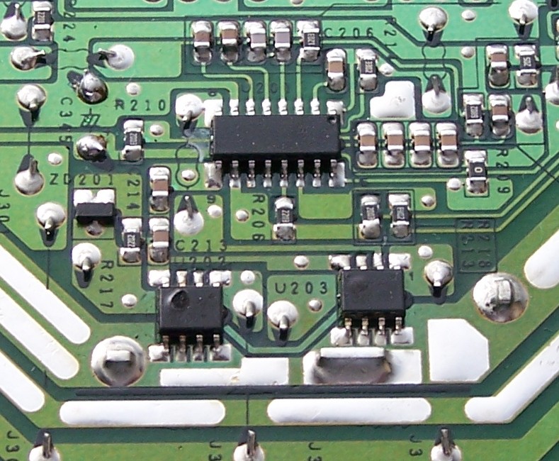

    Attached are some pics of the board. After reading other threads in here I've checked my work again and i can't find anything wrong. I've checked the high voltage transformers both primaries read 0K ohm (my $cheap meter only has a R * 1K setting so i can't tell something like 10 ohms from a true short) and the secondaries read 1.3K ohms. There is no continuity between the primaries and secondaries.
    I am unable to find any fuses (mentionned in another thread for a 930b) apart from F101 which is good. U202 and U203 look rather suspicious though. I can't read all the numbers on them and am not sure how to test them. Anyone?

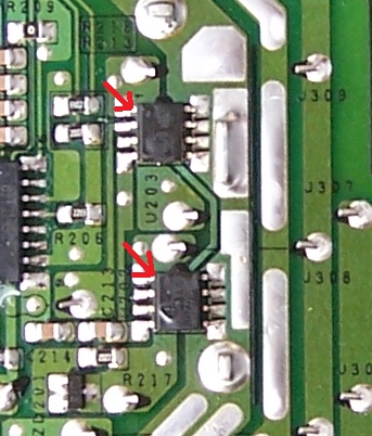

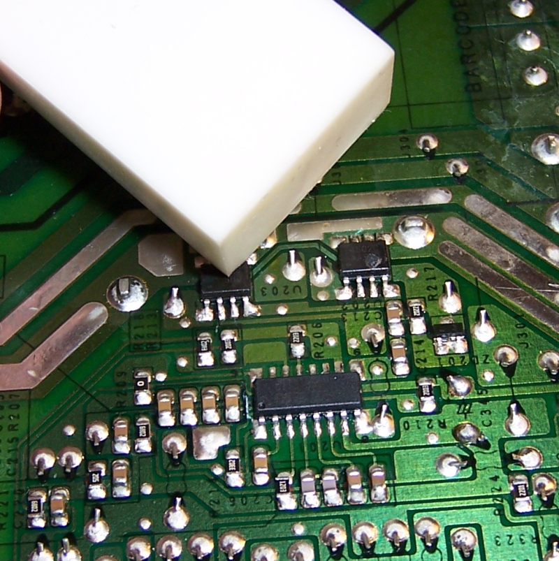

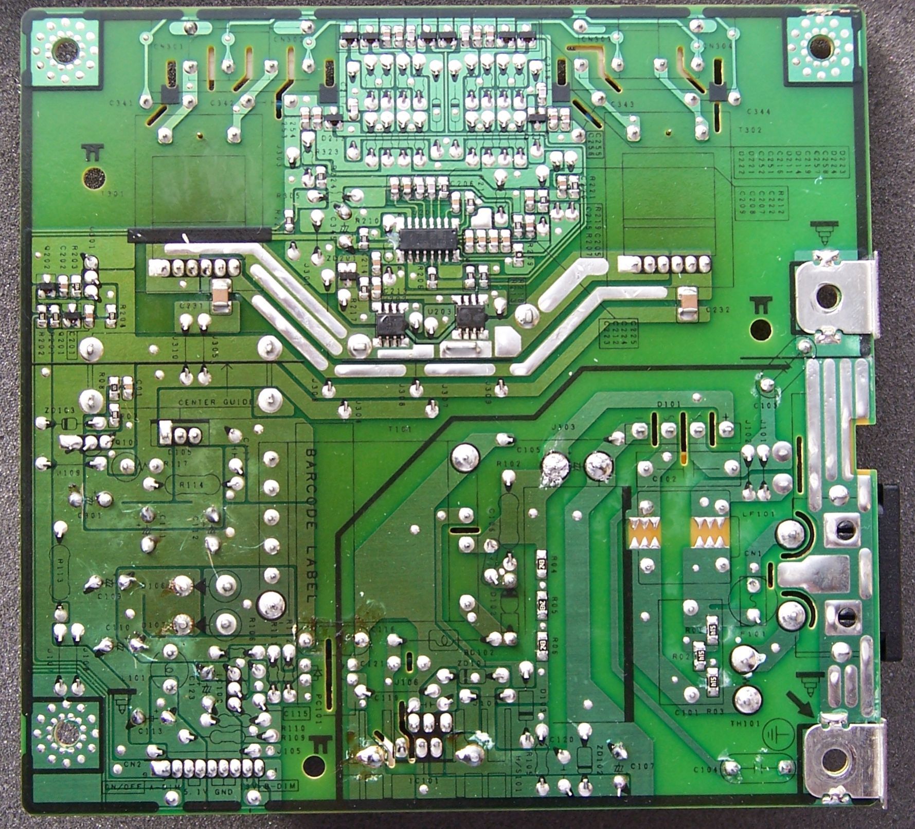

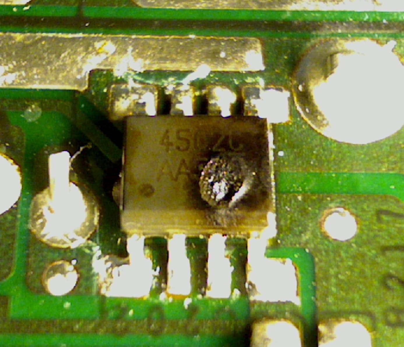

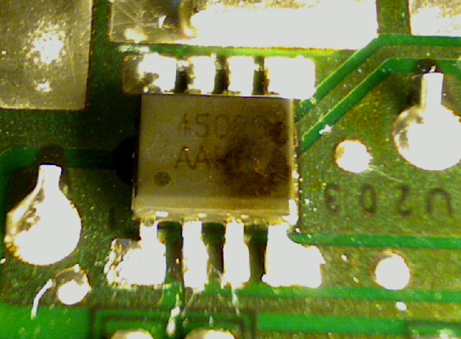

    U202 and U203 look in pretty bad shape and are probably burned out. They look to be AF4502C dual mosfets. Datasheet below:
    http://pdf1.alldatasheet.com/datashe...P/AF4502C.html
    With you meter set on resistance:
    Measure across the following for shorts:
    S1-G1
    G1-D1
    S1-D1
    Do the same test S2-G2, etc

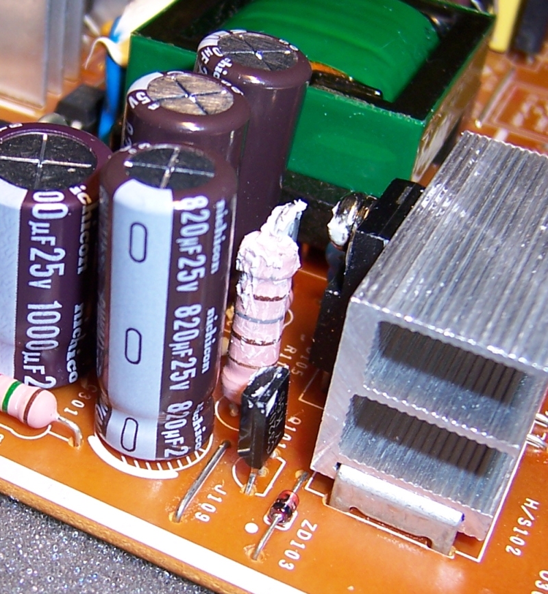

      I also forgot to mention the inverter fuse might be between the large cluster of caps and the heatsink. It might be underneath the white adhesive. It might be green and stands upright.
        S1-G1
        G1-D1
        S1-D1
        Thanks for the reply.
        I put the black lead on the first point mentionned and the red lead on the second i.e. black to S1 and red to G1, etc. It's hard to see so I've included a pic pointing to what I think is pin 1. Hupefully I've gotten it correctly
        I've checked both U202 and U203 and they read identical.
        S1 --> G1 = 2.5K ohms
        G1 --> D1 = 30K ohms
        S1 --> D1 = 700 ohms
        S2 --> G2 = 400 ohms
        G2 --> D2 = 100 ohms
        S2 --> D2 = 350 ohms
        No shorts or opens.
        I still can't find it. I've been looking where you said from before but this time I cleaned off the component and it appears to be a 1 watt(?) resistor. it's light pink. There's noting green in there. I've attached updated pics of the area.

        • retiredcaps
          • Apr 2010
          • 9271
          Re: Samsung 930B re-capped, no backlight
          See if U301 is shorted. You can measure it in circuit. Report readings.
          edit: Are you seeing 13V DC on the connector CN2?

            Hmmm, you did pick the correct location for pin 1. No shorts indicated from your readings. I'm wondering if what's on U202 is leftover residue from the soldering process. Try scratching the top of U202 with your fingernail to see if it will flake off. As for the fuse, Samsung usually puts a fuse at the 13V output, just before the inverter section. And I don't see a fuse either?! As a sanity check, try measuring for the 13V at the middle pin of heatsinked D105.

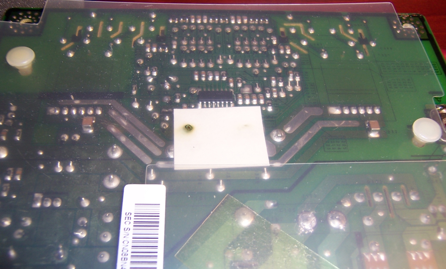

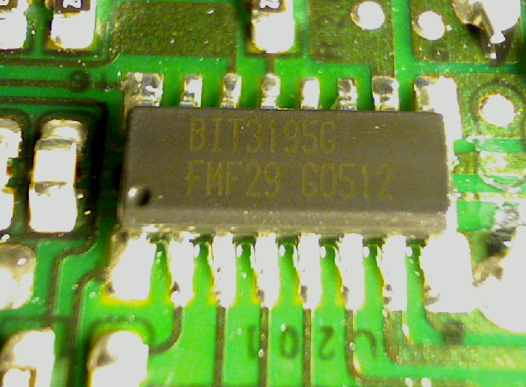

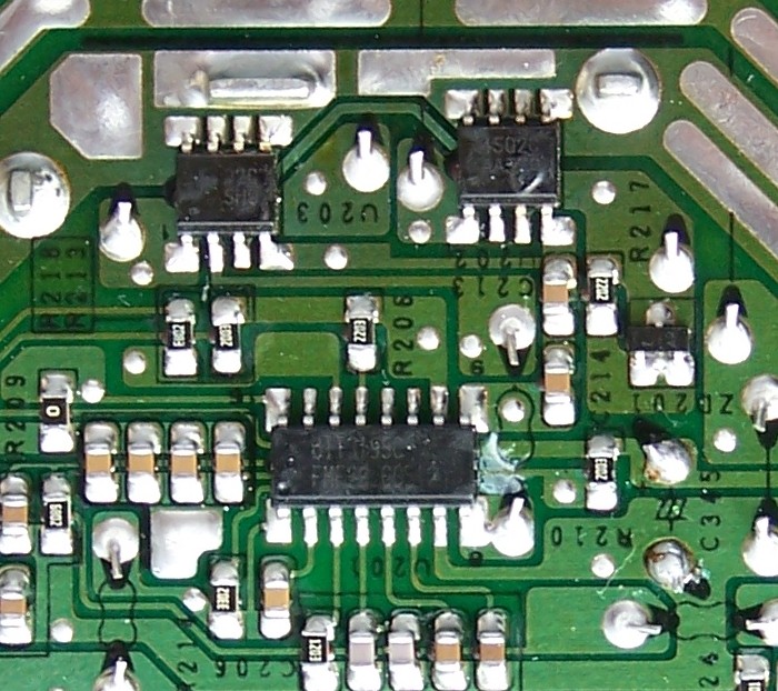

              There is also 13volts on the center of D105. I've tried to clean the chips, first with my fingernail, followed by a white eraser and rubbing alcohol but it didn't change anything. I took a webcam which can be made to focus really close up and wetted the tops of the chips with alcohol. The look burned alright. Also, the plastic sheet has marks where the chips are.

                I figured I'd kill some time and poke around on U201 and measure everything from anywhere to anywhere in both directions. There appears to be one short between pin 7 and 16. I'm not sure if this is normal or not. On the similar model (3193) sheet pin 7 is GND and pin 16 is MODSEL. C345 (33uF/35v, replaced) is connected by traces across pin 7 (GND) and 10 (VCC)
                  U301 is on the front side.
                  Even though the mosfets are not shorted, the one chip looks really bad and could be malfunctioning.

                    I agree with retiredcaps about the mosfets. Anything that heated up like that should be suspect. Also, they should always be replaced in pairs.
                    As for pin 16 connected to pin 7, since MODSEL sets the output polarity of the PWM controller, I'm assuming that connecting it to ground specifies a negative polarity.
                    Also, when you first power up the monitor, do you get any type of quick flash from the backlights?

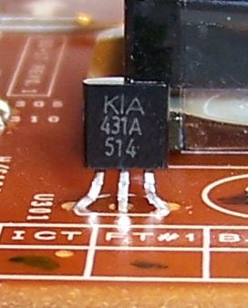

                      i'm going crosseyed. I can't find it. Can you point it out to me?
                      • jetadm123
                        • 2169
                        U301 is next to transformer T301. What's the part number?
                        • leperinc
                          • Jan 2011
                          • 18
                          Sorry about that, there are no opens or shorts no matter what pins/directions I measure.
                          here's the pic:
