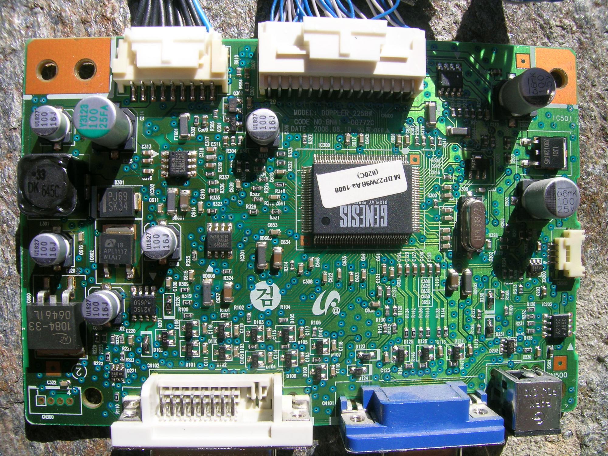

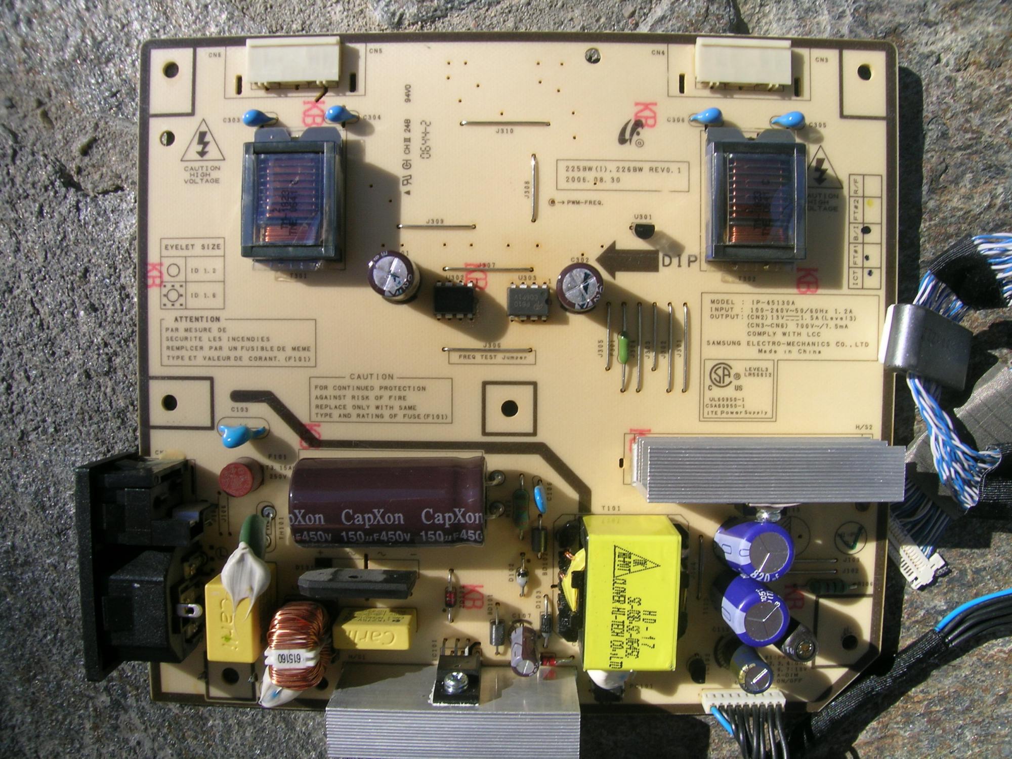

      • RickL
        • Oct 2010
        • 4
        Re: Samsung SyncMaster 225bw displaying oranges as blue
        here are a few of the front of the boards
        • retiredcaps
          • Apr 2010
          • 9271
          Originally posted by RickL
          Today I turned on my computer and noticed that all my colors are off. Oranges look blue. Something has went wrong and I am unsure if I can fix this problem.
          I can't think of anything other than some low probabilities things to try.
          1) Did you try both the VGA and DVI ports to see if the problem occurs on both?
          2) Check the solder joints on the VGA/DVI port.
          3) Did you try a different computer?
          PS. Good pics. I can't spot anything obviously wrong with the boards visually.
