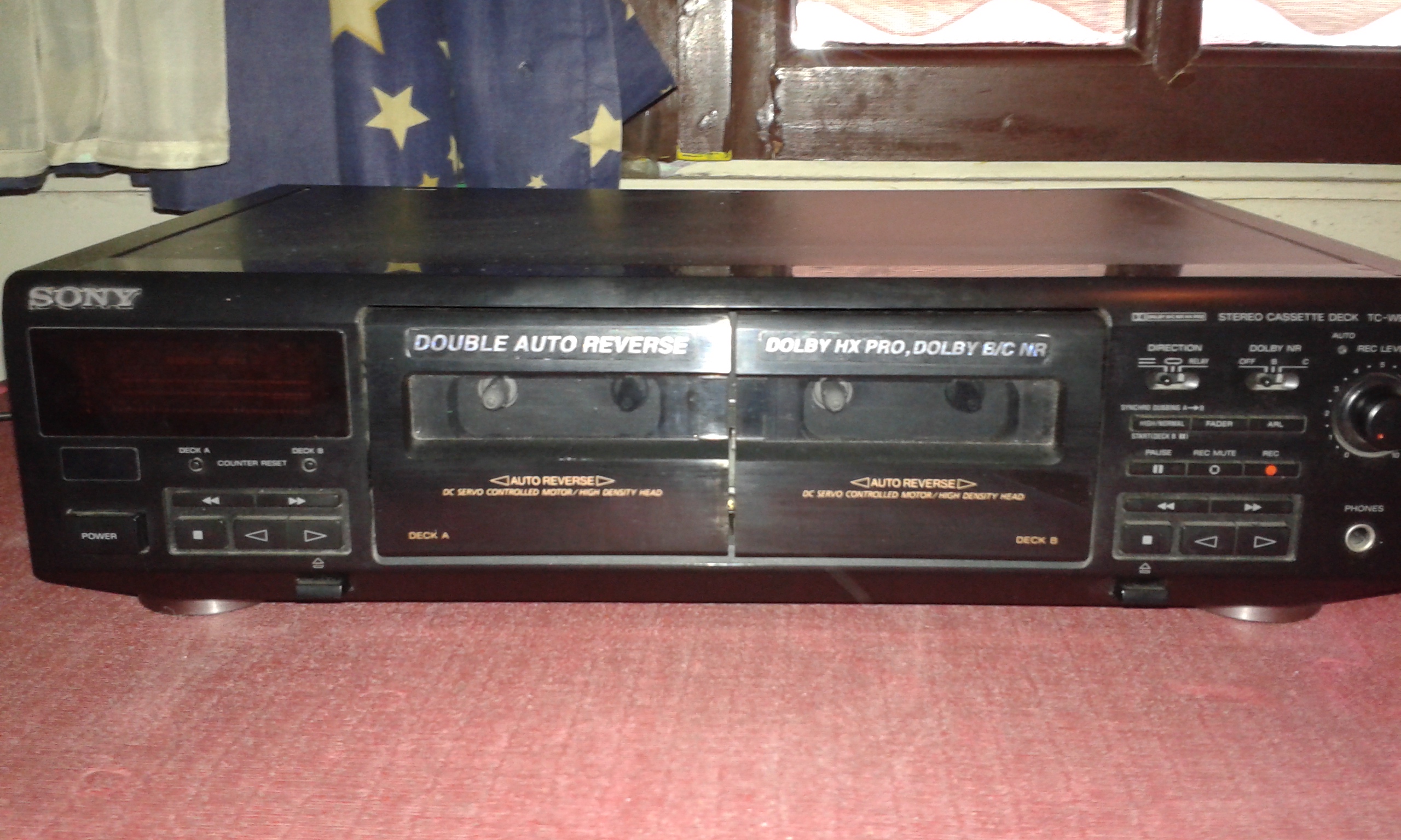

    Hi to all members on the forum.
    This is my first post.
    I wanna to talk about a common failure on sony TC-WE/WR series cassete deck.

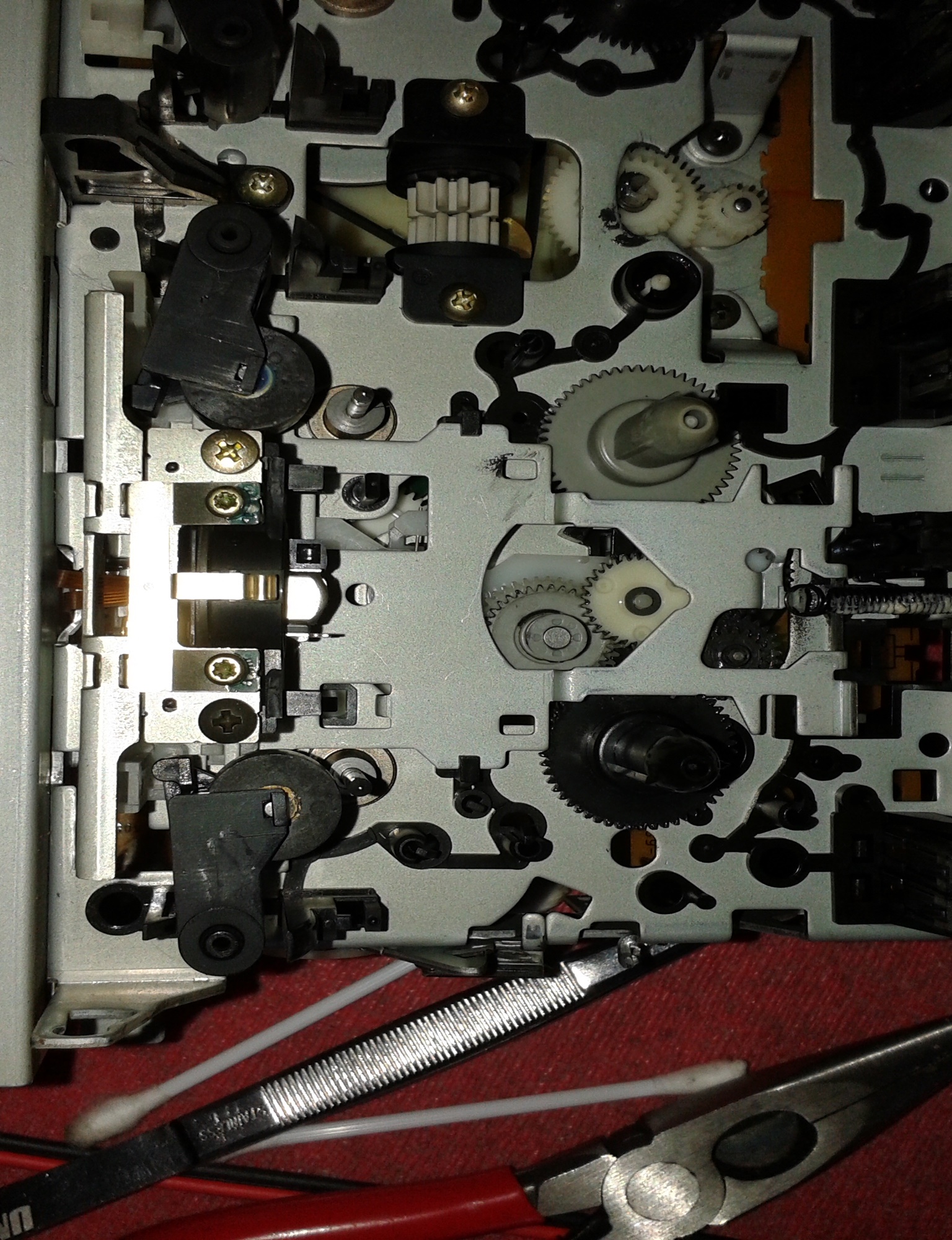

    The symptoms is that one deck dont always start play or is complete dead.Also a lot of clicking noise.Sometimes autoreverse stuck.
    The unit on photo is SONY TC-WE405.

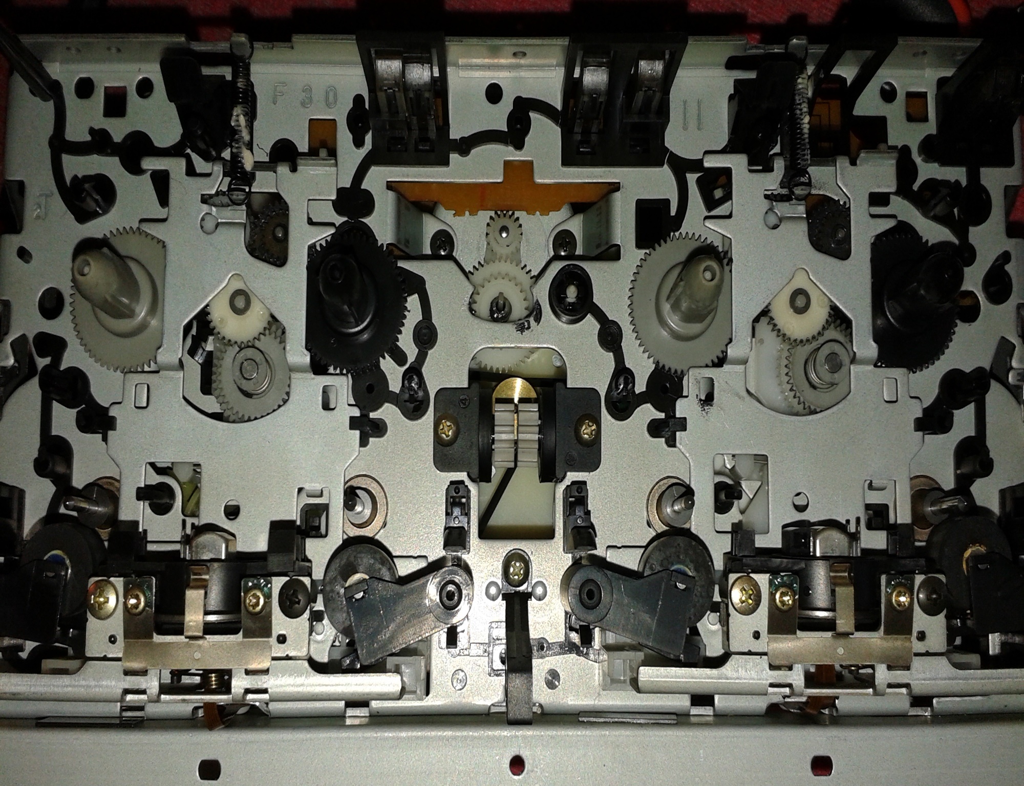

    The problem is at the trigger motor.Location at the center up on the deck mechanism.
    As you can see in the photo is 2 gears a big one and a small one.
    Usualy the small one develops a crack as you can see.If you dont have a spare one you can use epoxy glue to fix it and put a grease around him.
