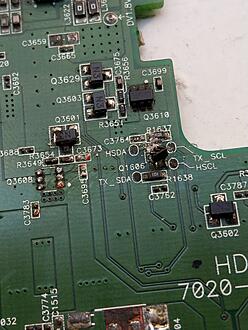

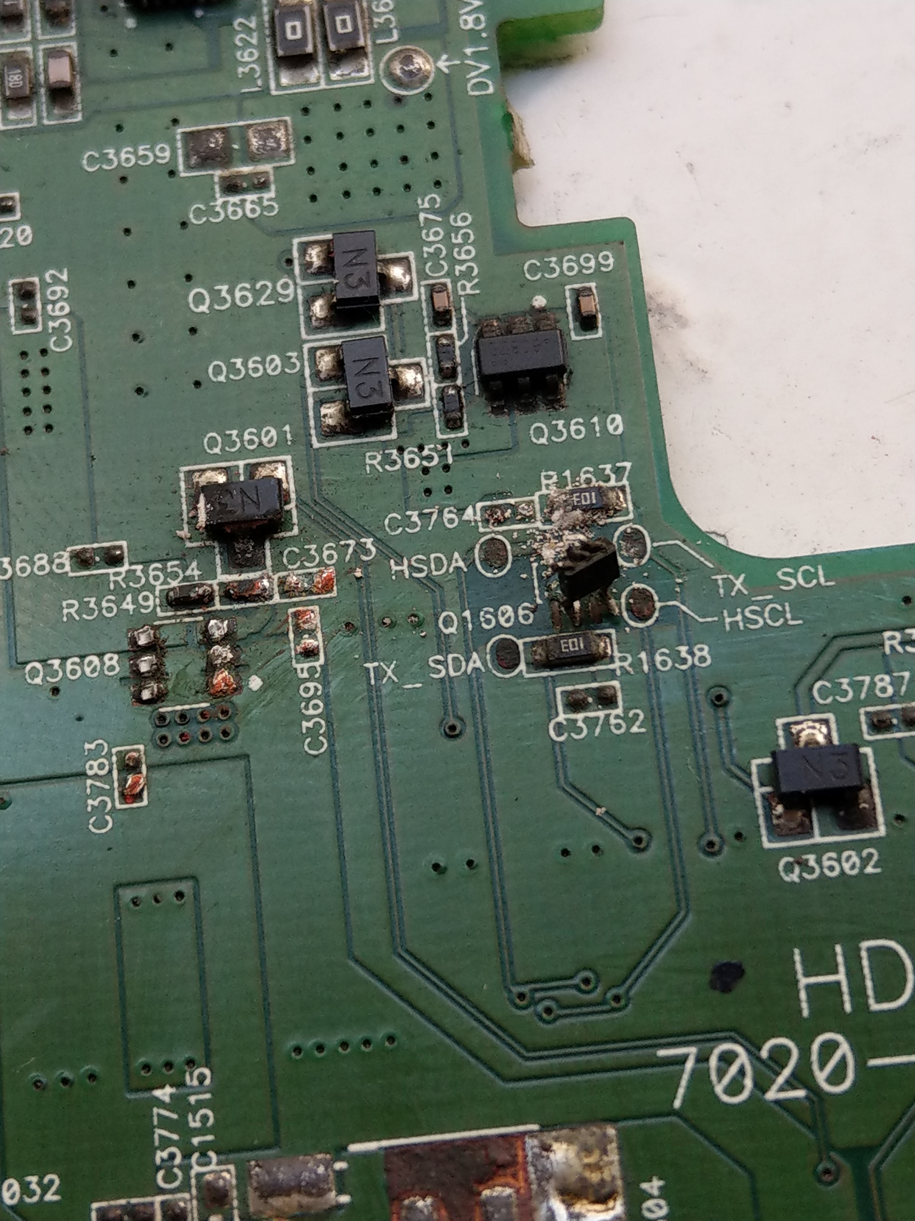

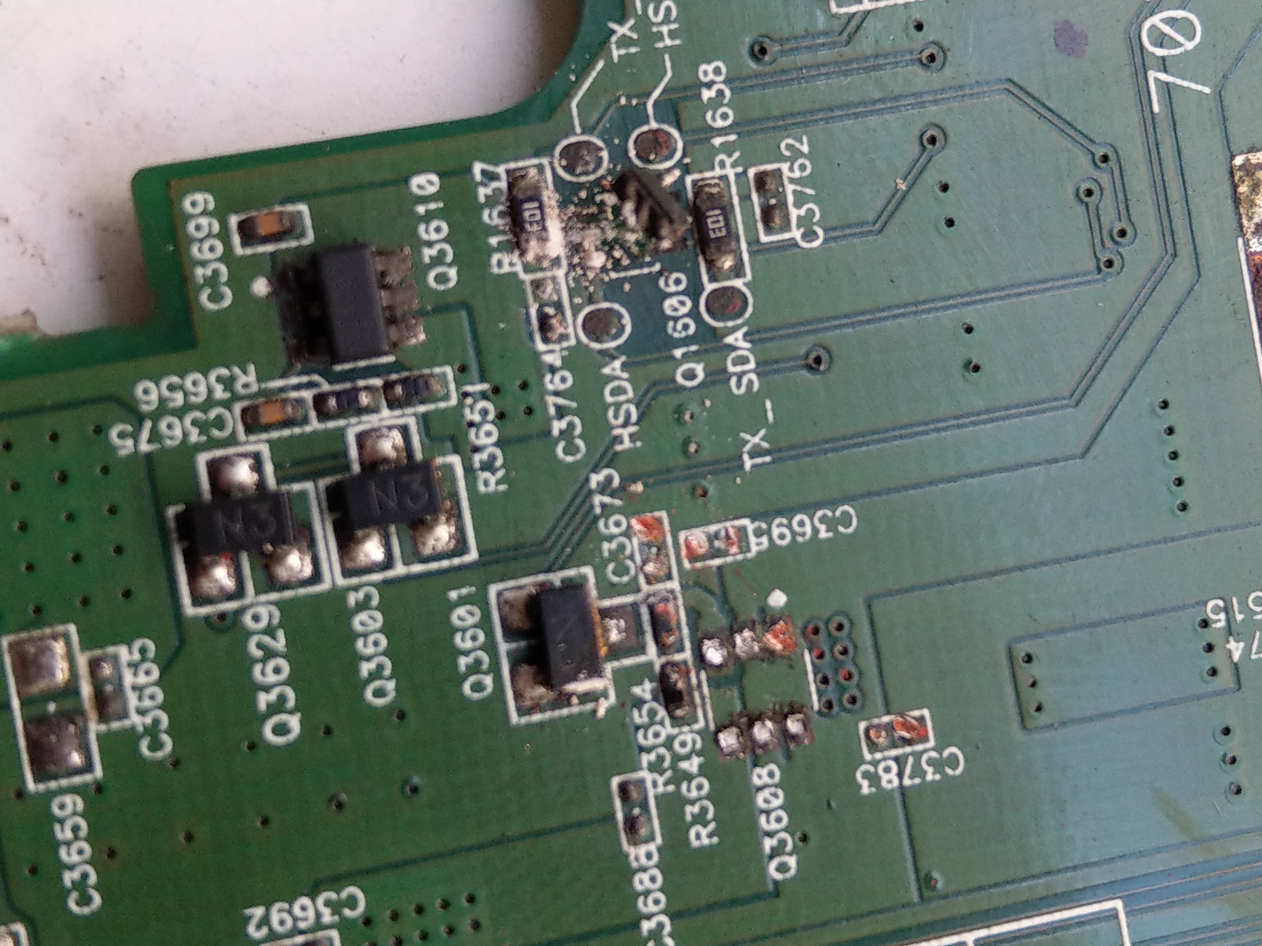

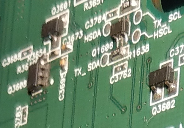

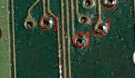

Opening it up revealed a LOT of dust so I carefully dismantled the entire unit and cleaned and visually inspected all the boards. I also verified that the fuse on the back of the display boards was ok.
On the main board, I ESR tested all the electrolytics and verified all the voltage regulators (by applying voltage) and bridge rectifier were working.
Looking closer, the main 3-wire (2 reds, 1 yellow) connector was noticeably loose on this board, so resoldered the three pins to solve that particular problem.
After finding the loose connector I was quietly confident that that might resolve the issue but no. What it did do was give the ability to switch the front LED from green to red and back again, but still no relay action, so no display.
Tried the factory reset I.E. holding the two furthermost left, front-panel buttons as switching it on, but again... No relay, no display.
Obviously, I'll have to look deeper into the manual however I'll probably still disassemble the main boards and verify that the relays are working first.
So... Do any bells ring with anyone? Does anyone know of any other 'reset' options?
If it is true that it had been working in the shop, then hopefully it will turn out to be something straightforward, like the loose connector causing the microprocessor to go into protection mode.
