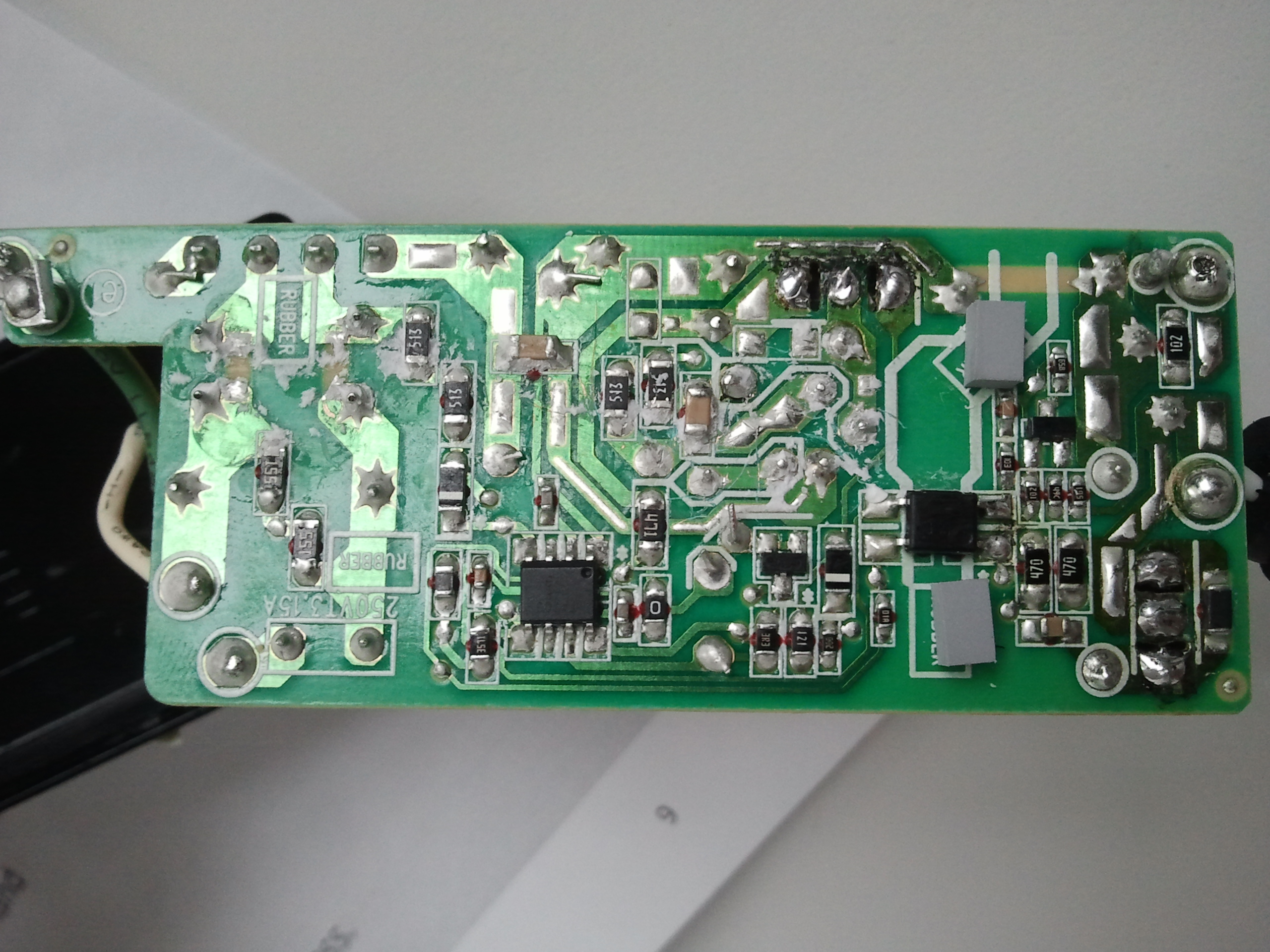

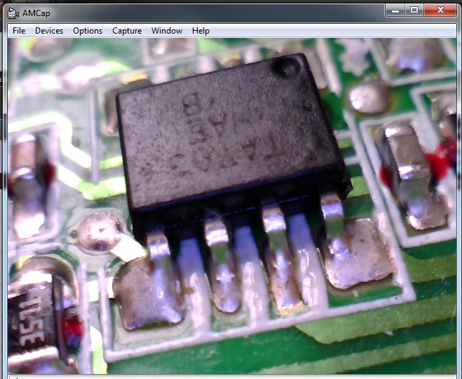

    Hi, i nedd to find the IC in the picture attached. Come from a Notebook powersupply (Lite on power supply). The PS is a classical Flyback converter. This IC i think is the controller.

    Re: Need help to find IC
    It´s hard to read the label on the photo. I bet you can read it at good lighting ...
      This is the best pictures i have. It's very difficult to capture a better pics. I thinks the code is like TA703S
        What is written in the second line?
        What is connected to which pin of the IC? Any other controller related devices on the board?
        I think you need to get some more information, in order to find out what that thing is and what it is supposed to do.
          The 2nd line is something like "NAE" and last line is "SYB".
          I will check the connection later. This is the only IC in the board.
          Like any other classic flyback there are an n-ch mosfet (tested and ok), output diode (tested ok), diode bridge (tested and ok), bulk capacitor (after the bridge) and an optocoupler (tested and ok).
            With good probability the ic is a TEA1733 from NXP. In the App note AN10868 the output diode and n-ch mosfet have the same part number of the my power supply.
            Unfortunately i can't find any reference on how this IC is marked on top side
              Checking the connection and searching on internet i found that the ic is probably an On-Bright electronics product. At the moment i know only that pin1 is GND
              http://www.on-bright.com/cn/english/index.htm
              On-bright produce many SMPS IC controller so it's not easy to find the right one
                Under different light i see this code:
                TA703S
                TKHAE
                SYB
                but nothing on internet correspond to this code
                  Show the full picture the power supply board and assign it a name - the model power supply
                    It looks like it has flux residue on it. Try cleaning it with some alcohol or such, then you may find it easier to read...

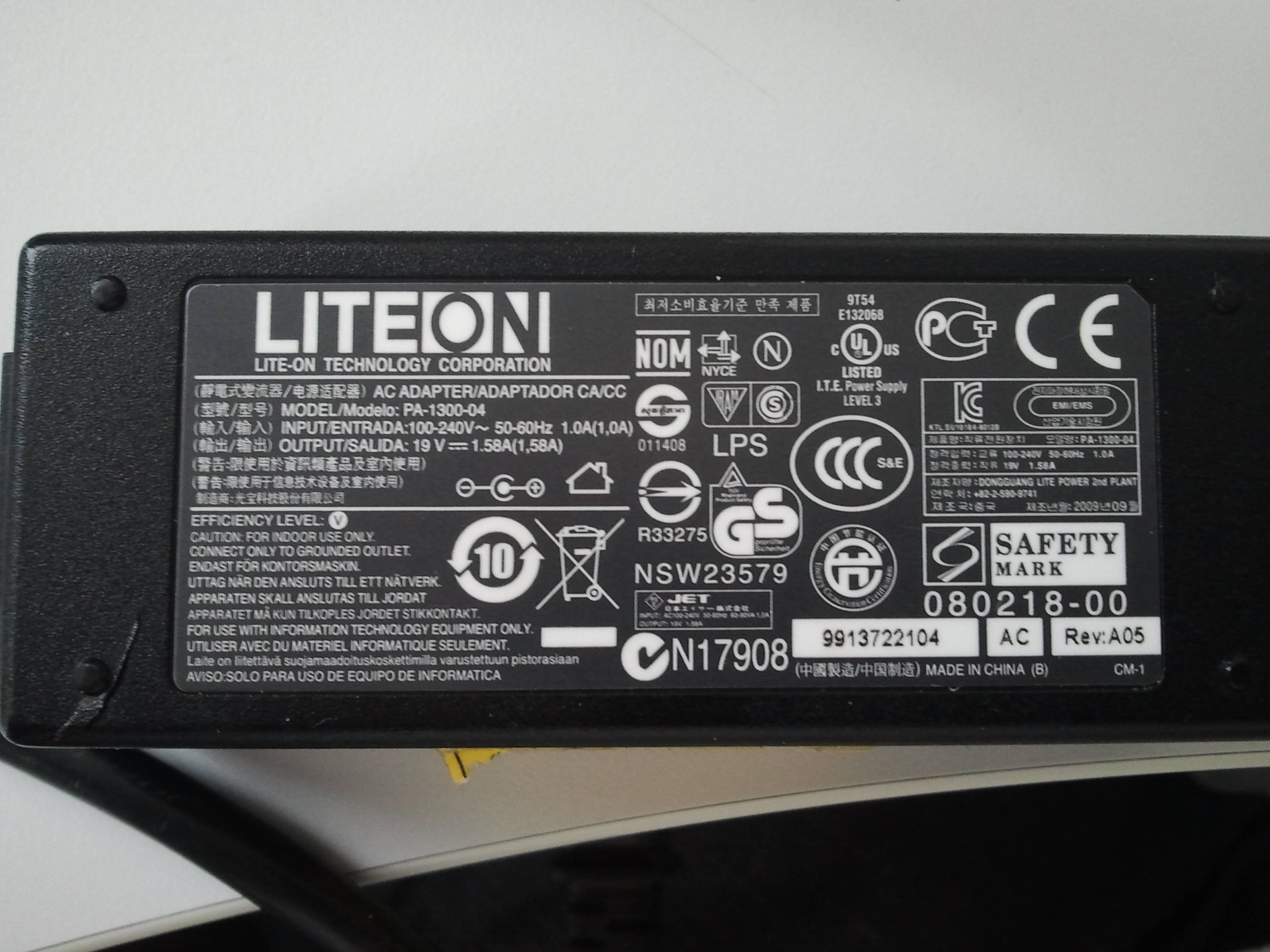

                      Thanks for your reply. Here is attached the PS model.
                        LTA703S Fairchild http://finance.yahoo.com/news/power-...123000979.html
                            Thanks very much for the reply.
                            I can't find a datasheet of LTA703S and where to buy.
                            Does exist an alternative?
                              Need a good photo and will have an alternative, check resistor 3R3
                                Please check the pics attached
                                  May be alternative SG5851
                                      The SG5851 is obsolete so is there another alternative?
                                        Look for the evening, and you checked the 3R3 ?
