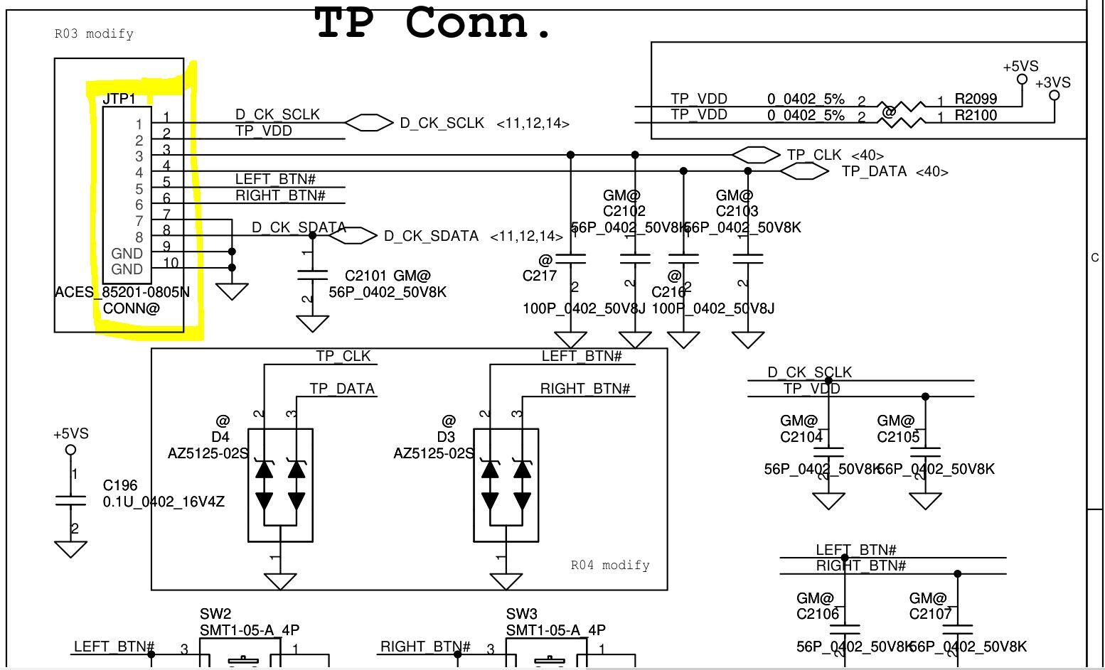

    Acer aspire v3 571g
    Mousepad not working, how do I fix it. I'm new to this platform

    Have you installed all the drivers? specially those like the IO and chipset stuff?
    Here's a part of the schematic for the touchpad on that model, you should start measuring for shorts and continuity, sometimes the flex is broken

      You can enable/disable it using the Fn+F7 keys, check if it is enabled in the BIOS.
