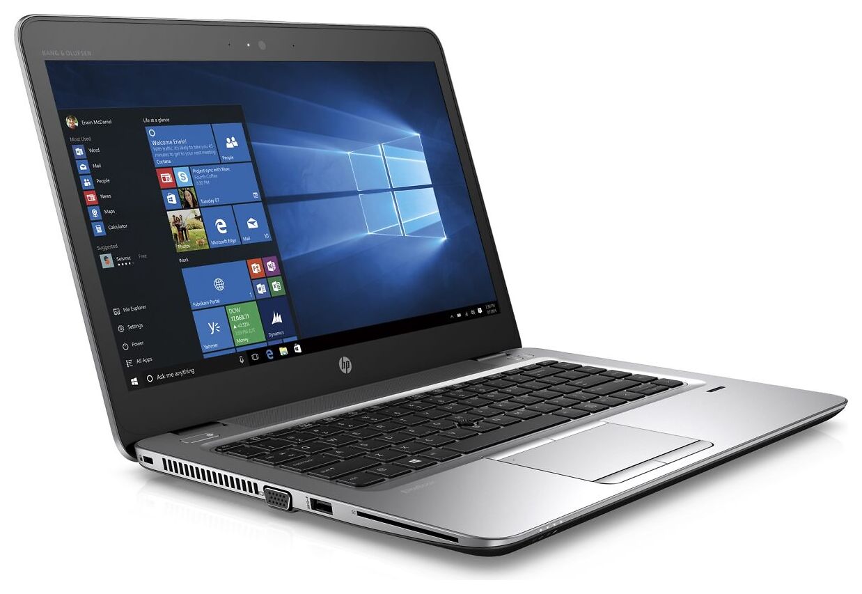

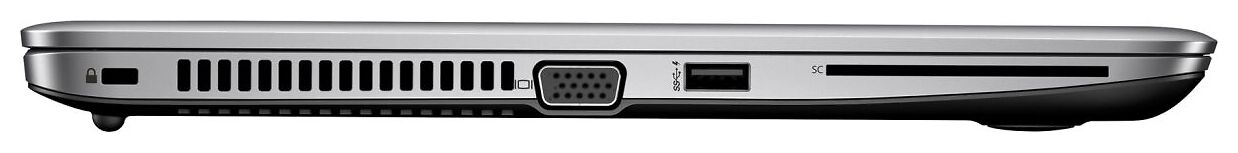

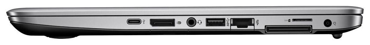

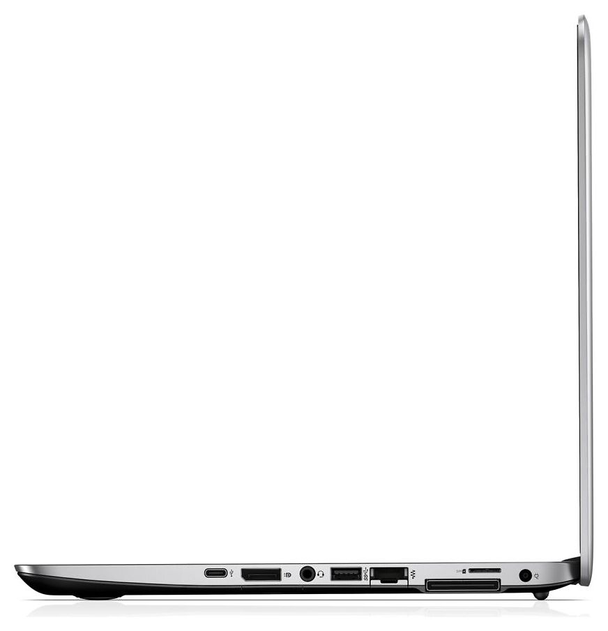

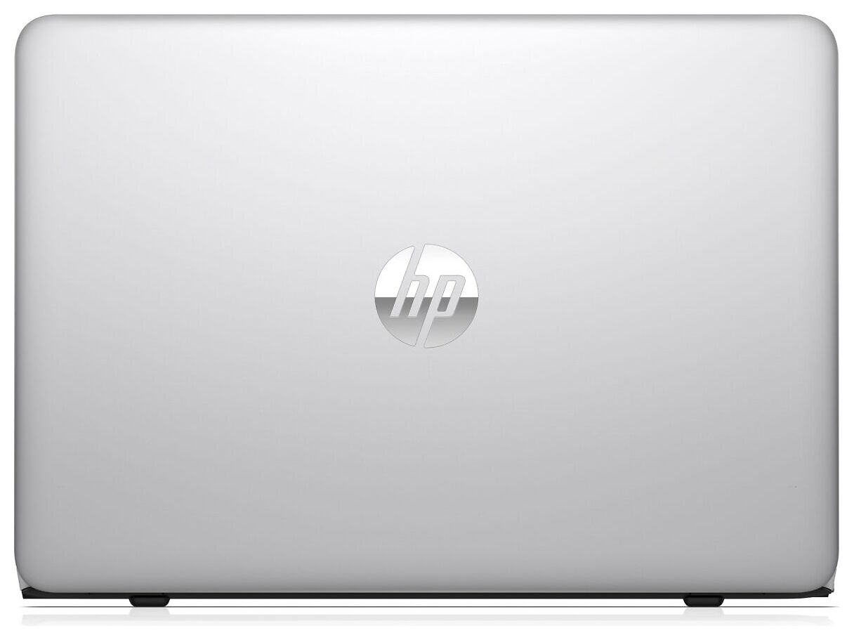

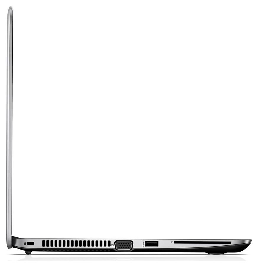

HP EliteBook 840 G4 Notebook 800 Specification for Upgrade or Repair
    • 115471
    HP EliteBook 840 G4 Notebook 800 Specification for Upgrade or Repair
    This specification for the HP EliteBook 840 G4 Notebook can be useful for upgrading or repairing a laptop that is not working. As a community we are working through our specifications to add valuable data like the 840 G4 boardview and 840 G4 schematic. Our users have donated over 1 million documents which are being added to the site. This page will be updated soon with additional information. Alternatively you can request additional help from our users directly on the relevant badcaps forum. Please note that we offer no warranties that any specification, datasheet, or download for HP EliteBook 840 G4 Notebook is accurate, safe, error free, or the fix you require.
    Design > Family: EliteBook
    Design > Model Name: 840 G4
    Design > Part Number: Z2V44EA-FR-RENEW
    Design > Release Date: 14/01/2018
    Design > Series: 800
    Display > Panel Type: SVA
    Specification > Battery: 15.3 hrs
    Memory > Internal Memory: 4GB
    Product Code: Z2V44EA-FR-RENEW
    Audio > Speakers Manufacturer: Bang & Olufsen
    Battery > Battery Life (max): 15.3 h
    Weight And Dimensions > Depth: 237mm
    Weight And Dimensions > Width: 338mm
    HP EliteBook 840 G4 Notebook 800 Specification for Upgrade or Repair
    HP EliteBook 840 G5 + 8GB 2400 MHz DDR4 Notebook 800 Specification for Upgrade or Repair
    This specification for the HP EliteBook 840 G5 + 8GB 2400 MHz DDR4 Notebook can be useful for upgrading or repairing a laptop that is not working. As a community we are working through our specifications to add valuable data like the 840 G5 + 8GB 2400 MHz DDR4 boardview and 840 G5 + 8GB 2400 MHz DDR4 schematic. Our users have donated over 1 million documents which are being added to the site. This page will be updated soon with additional information. Alternatively you can request additional help from our users directly on the relevant badcaps forum. Please note that we offer no warranties that...
    09-06-2024, 07:00 AM
    HP EliteBook 850 G5 Notebook 800 Specification for Upgrade or Repair
    This specification for the HP EliteBook 850 G5 Notebook can be useful for upgrading or repairing a laptop that is not working. As a community we are working through our specifications to add valuable data like the 850 G5 boardview and 850 G5 schematic. Our users have donated over 1 million documents which are being added to the site. This page will be updated soon with additional information. Alternatively you can request additional help from our users directly on the relevant badcaps forum. Please note that we offer no warranties that any specification, datasheet, or download for HP EliteBook...
    09-06-2024, 06:20 AM
    HP EliteBook 1050 G1 Notebook 1000 Specification for Upgrade or Repair
    This specification for the HP EliteBook 1050 G1 Notebook can be useful for upgrading or repairing a laptop that is not working. As a community we are working through our specifications to add valuable data like the 1050 G1 boardview and 1050 G1 schematic. Our users have donated over 1 million documents which are being added to the site. This page will be updated soon with additional information. Alternatively you can request additional help from our users directly on the relevant badcaps forum. Please note that we offer no warranties that any specification, datasheet, or download for HP EliteBook...
    09-06-2024, 07:02 AM
    HP EliteBook 1050 G1 Notebook 1000 Specification for Upgrade or Repair
    This specification for the HP EliteBook 1050 G1 Notebook can be useful for upgrading or repairing a laptop that is not working. As a community we are working through our specifications to add valuable data like the 1050 G1 boardview and 1050 G1 schematic. Our users have donated over 1 million documents which are being added to the site. This page will be updated soon with additional information. Alternatively you can request additional help from our users directly on the relevant badcaps forum. Please note that we offer no warranties that any specification, datasheet, or download for HP EliteBook...
    09-06-2024, 07:02 AM
    HP EliteBook 1050 G1 Notebook 1000 Specification for Upgrade or Repair
    This specification for the HP EliteBook 1050 G1 Notebook can be useful for upgrading or repairing a laptop that is not working. As a community we are working through our specifications to add valuable data like the 1050 G1 boardview and 1050 G1 schematic. Our users have donated over 1 million documents which are being added to the site. This page will be updated soon with additional information. Alternatively you can request additional help from our users directly on the relevant badcaps forum. Please note that we offer no warranties that any specification, datasheet, or download for HP EliteBook...
    09-06-2024, 07:02 AM
