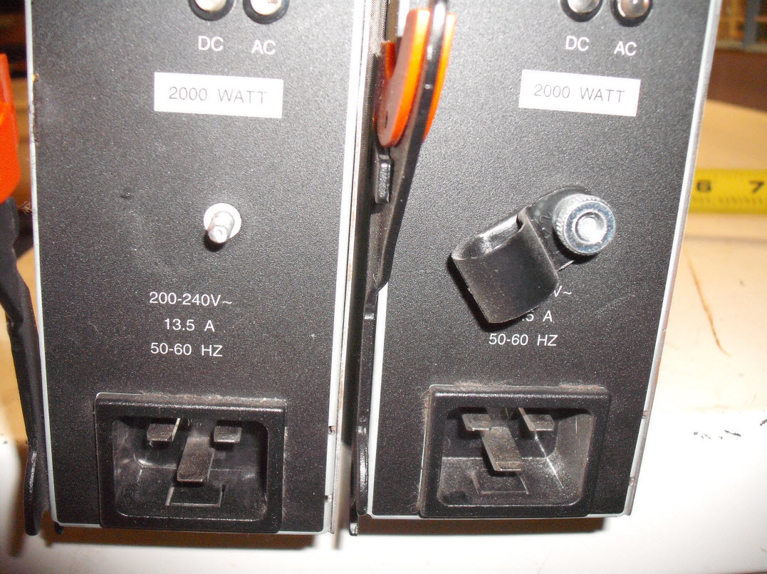

        Re: Suggestions for an HPE Intelligent PDU
        Originally posted by Spork Schivago
        I see with these PDUs, there's mostly C19 outlets and C13. I believe the C13's are simply used to be plugged into the PSU's on the equipment, but what the heck are the C19's used for? I don't see any C19 to C14 cords. I see C13 to C14, but that's it, and C19 to C18. But do power supplies come with C18 inlets?
        The "mate" to the C19 is the C20. (C18 is a 2-pin connector; seldom used)
        And, yes, I have a few machines with C20's. Often, PDU's have C20's and count on a C19-C20 cord to carry power from the PDU to the powered device.
        (Remember, the PDU will never have exposed pins with power on them. And, the connectors are typically chosen to ensure the attached cable/device can support the load that can be delivered)
          So the power supplies would need C20 inlets? The PSUs they're selling me, which run on 208 - 240VAC have C14 inlets.
          Even though all my PSUs support 120VAC - 240VAC, they all have the C14 inlets. This is what confuses me. I see with the metered and switch ones, stuff like 20 (C13), 4 (C19) or something along those lines, but with the intelligent ones, 6 (C19). Do I tear the PSUs apart and add a C19 inlet? That'd probably void warranty. What about adapter cables to go from C19 to C14? Thanks.
          Could you send me a pic of your devices that have the C20's?

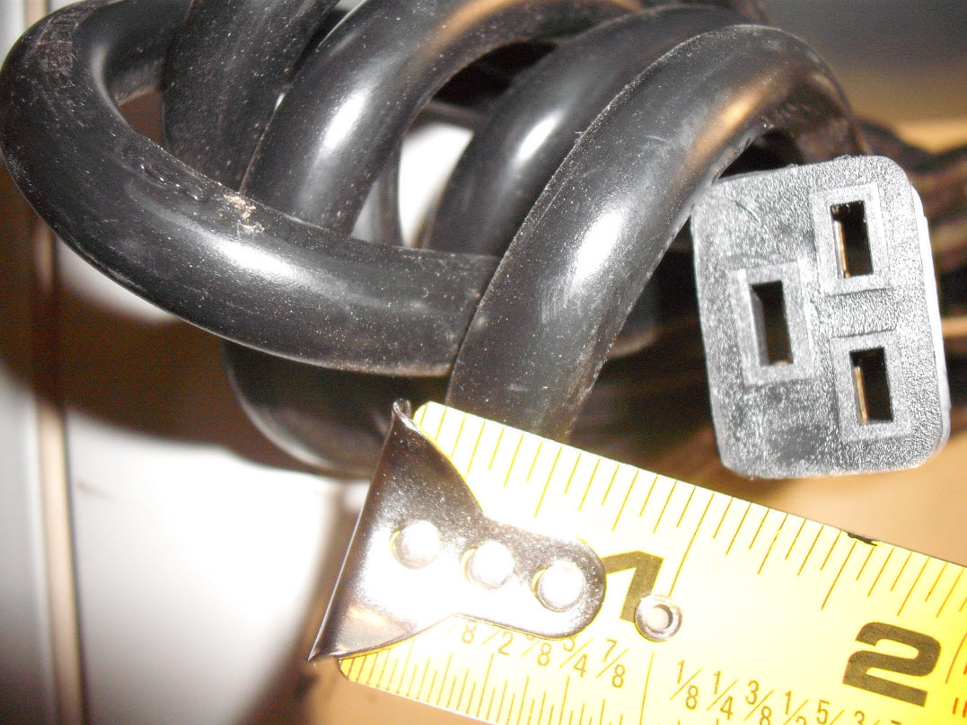

            I assume you wanted photos of the power inlets (not the equipment itself)?
            Also, the power cord(s) used -- ruler to show how beefy they are (20A).
              Okay, those are perfect.
                So, obviously, these C19's are not meant for PCs or my server with the 1400 watt PSUs.
                Inlet shapes try to crudely enforce a sort of "no-that-cord-isn't-big-enough-for-this-load" in much the same way that a 20A appliance can't physically be plugged into a 15A receptacle (even if the 15A receptacle is on a 20A branch circuit).
                There are no guarantees that reliance SOLELY on the connector shells will result in a "safe" configuration. E.g., the common C13/C14 connector pair could, theoretically, be used for a 10A load. This would suggest ~#14AWG to safely carry that current to the load (assuming a short run). Yet, you can find "modular C13 power cords" fabricated with all sorts of SMALLER wire gauges -- regardless of length!
                The use of the C19/C20 pair forces the IT droid to pause for a moment before grabbing "just any old power cord" (the cord shown uses #12AWG conductors) and using it to tether the machine to the mains; the 220 requirement just reinforces this.
                Likewise, I have some machines with C15/C16 pairs -- intended to similarly discourage the user from casually using a C13 power cord!
