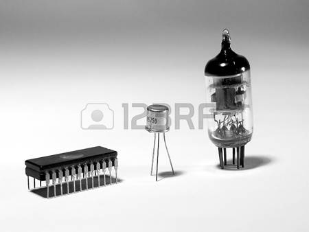

                        Re: CEC Capacitors
                        Here's a couple pictures. The triode was the tube equivalent of the transistor. Now it's all chips for the most part. In the triode you have a cathode which puts out the electron fog Behemot spoke of. It approaches the grid. If the grid is biased highly negative the electrons are repulsed and no currant flows. If the grid is not biased at all, sitting at 0 volts, a little currant will flow. If the grid is biased with a positive voltage, maximum currant flow will result. The grid will suck in electrons and then the positive plate will pull in the rest.
                        Solid state works very similarily. The N gives electrons, the P determines if they go on at all, a little, or like gangbusters. The second N sucks up all that comes through from the other N layer.
                        In the diagram, they use the heater filament as a cathode which is usually not the same in later tubes. The cathode is actually a separate plate.

                          Re: CEC Capacitors
                          Okay, I'm almost understanding now. But I still don't understand something. Let's take the NPN transistor. So, we have
