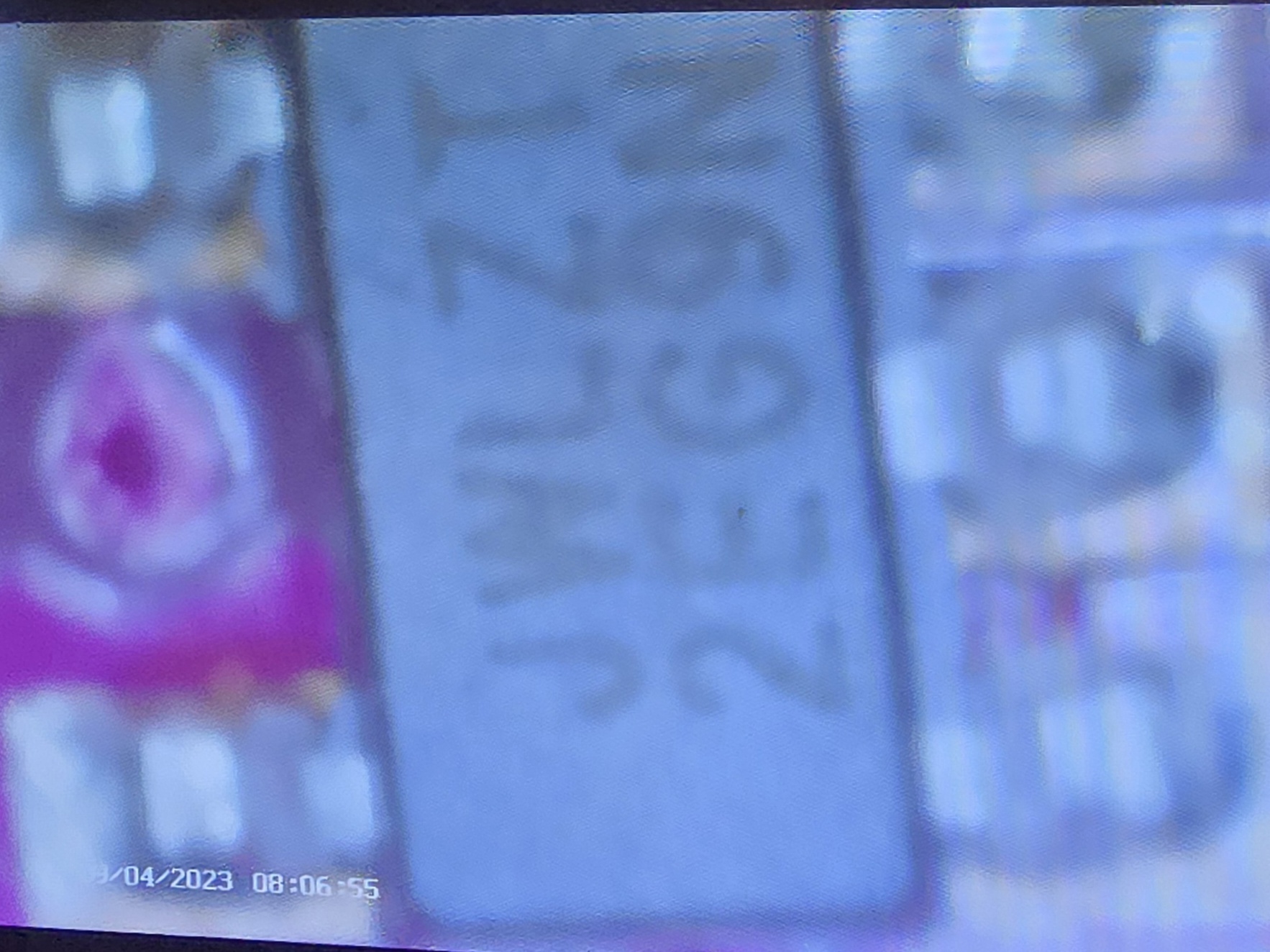

Help to locate a sot 23 5 marking JWLZT 2EG9N
  • blze999
    • Apr 2025
    • 8

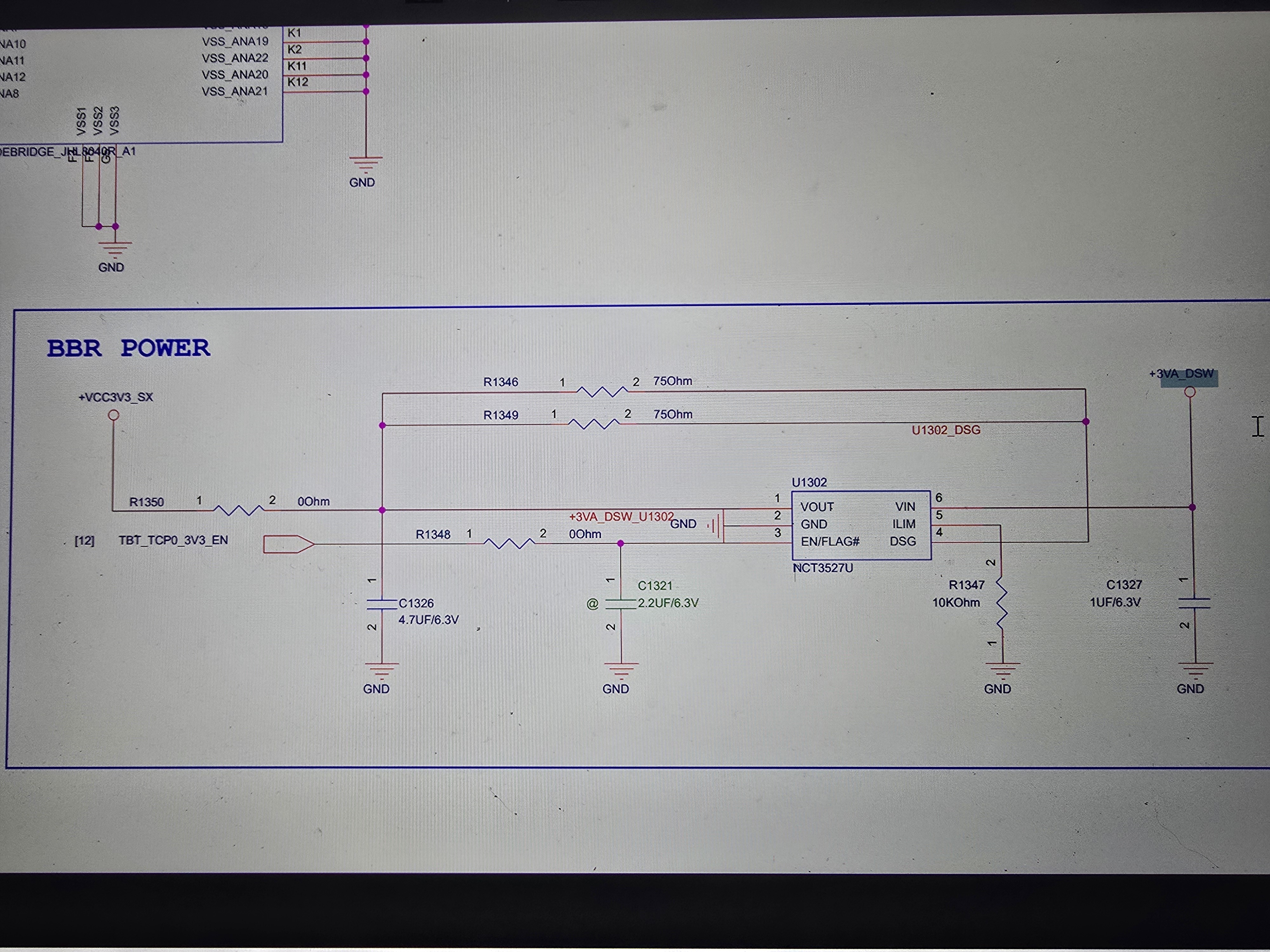

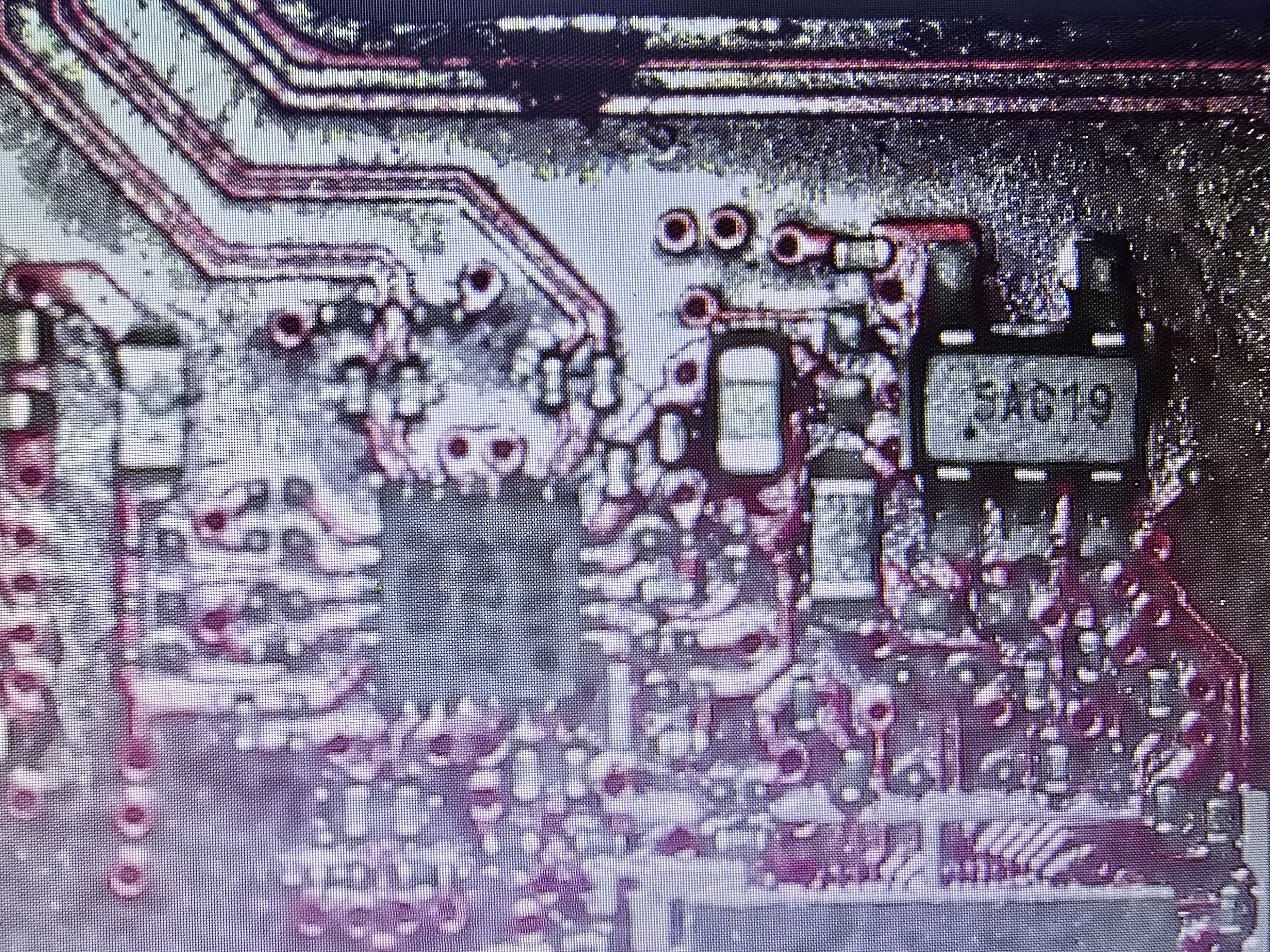

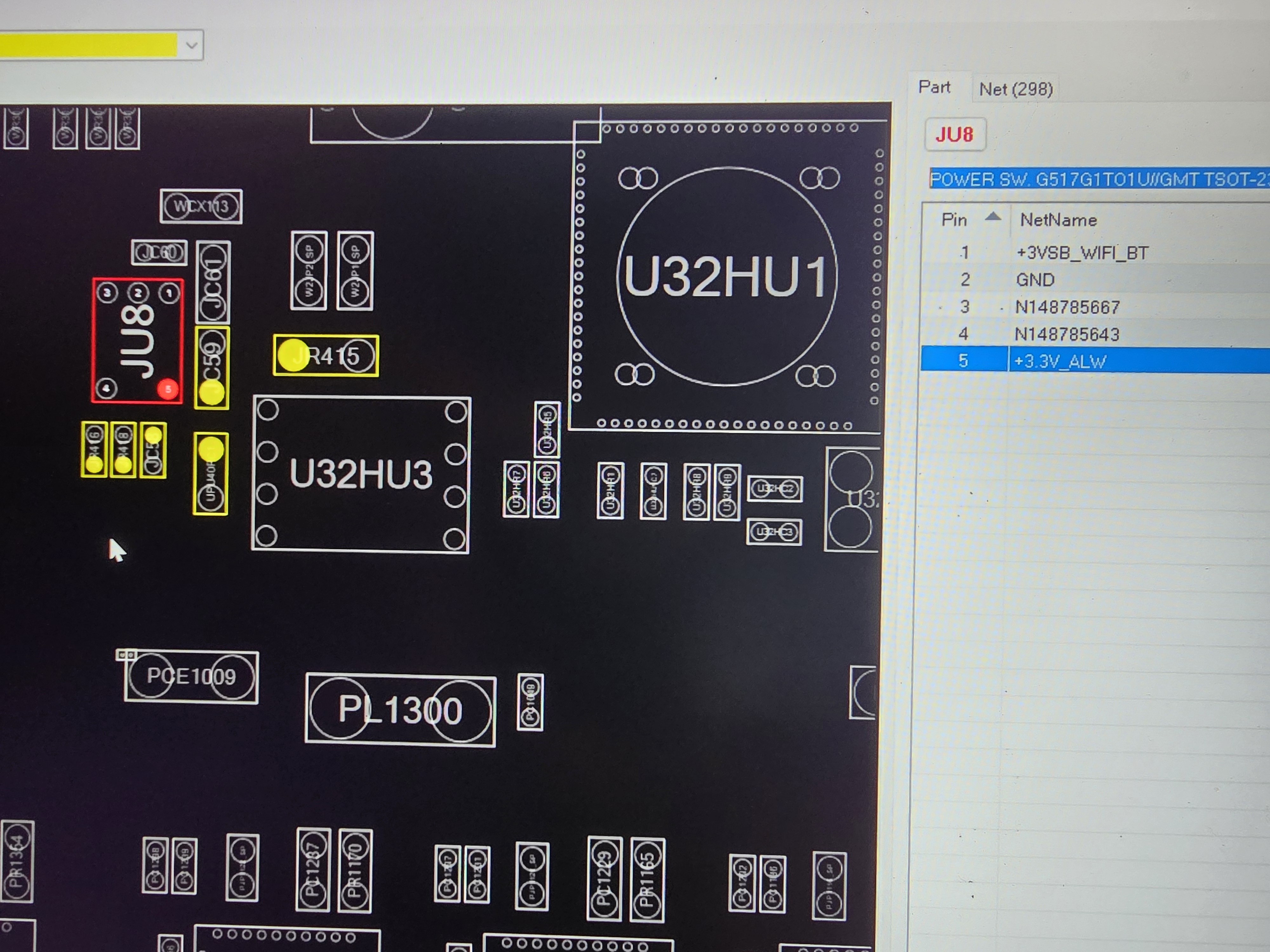

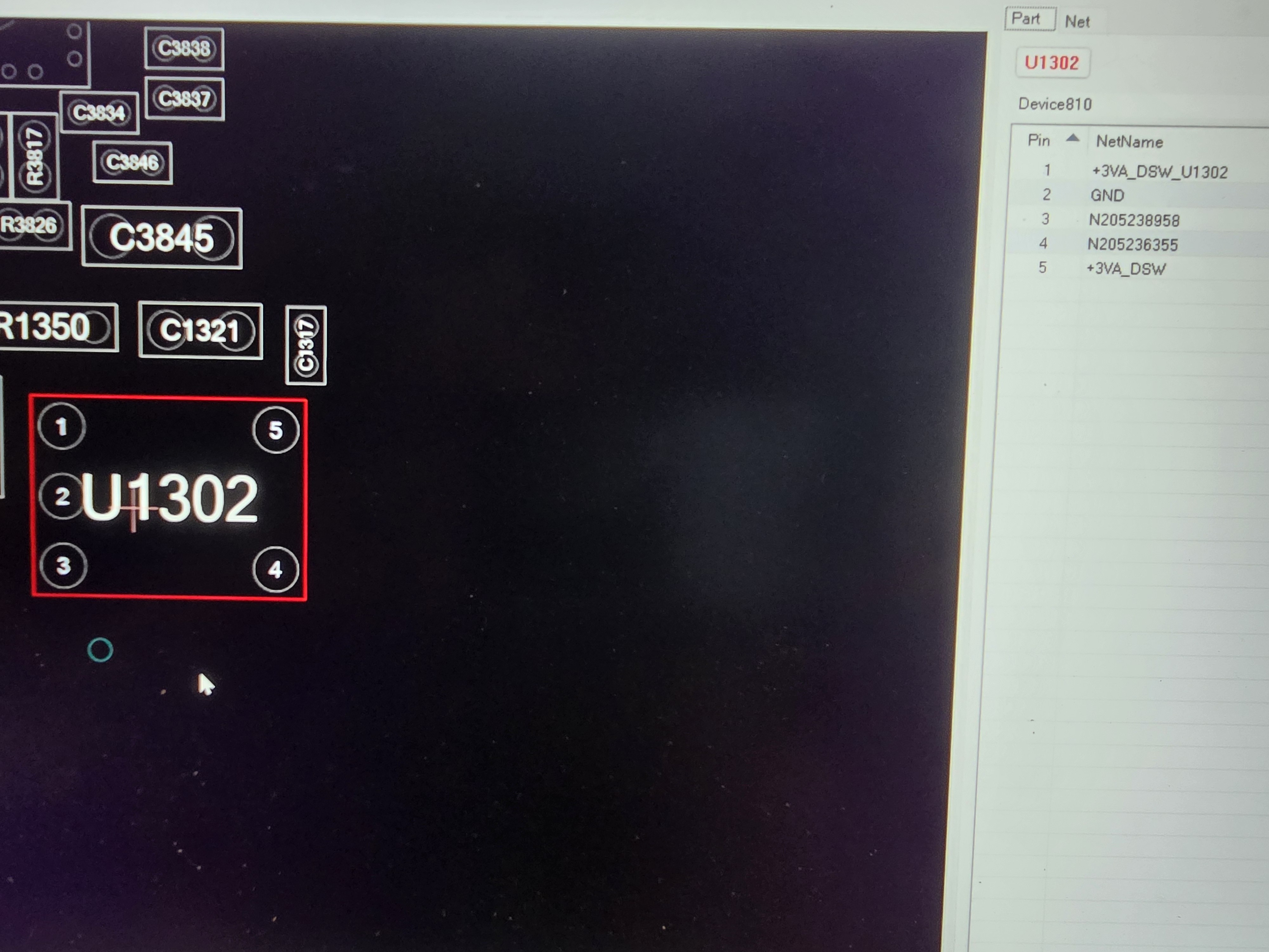

    I can't seem to find this component anywhere i belive it is a sot 23 5 package but could be wrong. It is an asus gu603zx laptop motherboard ill add photos of what im seing in boardview it doesnt label the part. Thr schematics i have are for asus603he i cant find the 603zx. On the schematics it is a different component 6 pins ill show that as well not sure if that will help in identifying what it does so i can find a replacement. The board was powering on without it to bios but when i try to boot with ssd it goes into protect mode i belive. I located another sot 23 5 where the circuit looked similiar and pin 2 was ground that part number is 5ag19 ill also show the pin out from the board i got it off of. I started down this rabit hole, board had no power removed, 2 shorts board powered on to bios, but fans didnt spin. I started looking for other issues and seen that part was missing. I belive i was using incompatible fans and i think the part i put on shorted the audio chip out because i blindly put capicitors where i thought they went based on the other circuit. But the board is still booting to bios so that is where i am currently. May be a long shot but any advice/help will be greatly appreciated.
