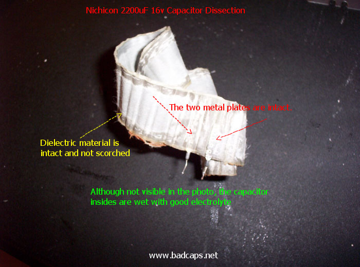

      Ok, this next capacitor was a good one to use as a demostration of what it SHOULD look like... It was a perfectly healthy Nichicon 2200uF 16v low-ESR.
      You can see the obvious color difference! Everything is completely intact, and was soaking wet with electrolyte! You will note that the paper filler and the metal plates are all in one piece and intact.
      Ok, if you've ever wondered, now you'll know...

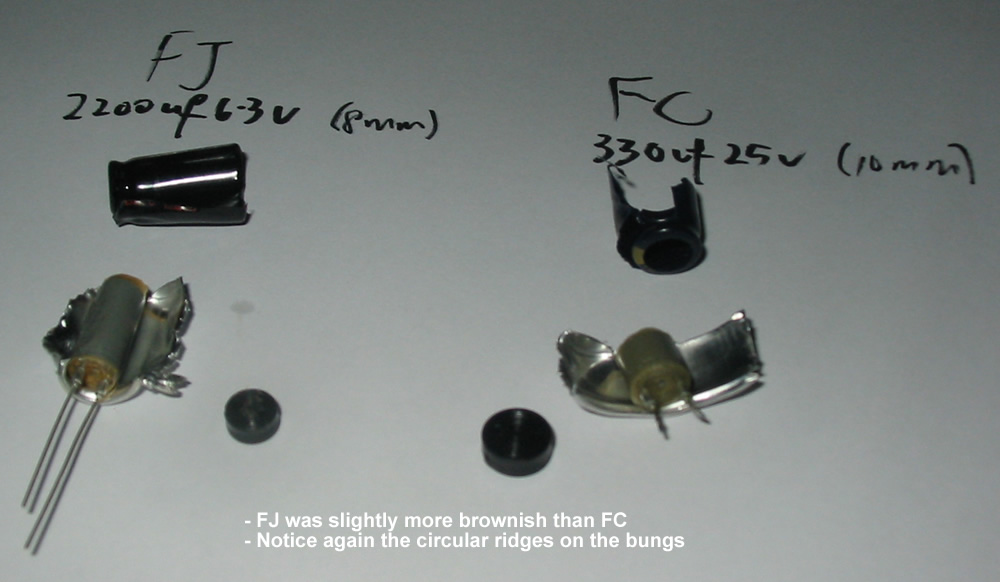

        Comparison of Panasonic FJ and FC by BluBlur

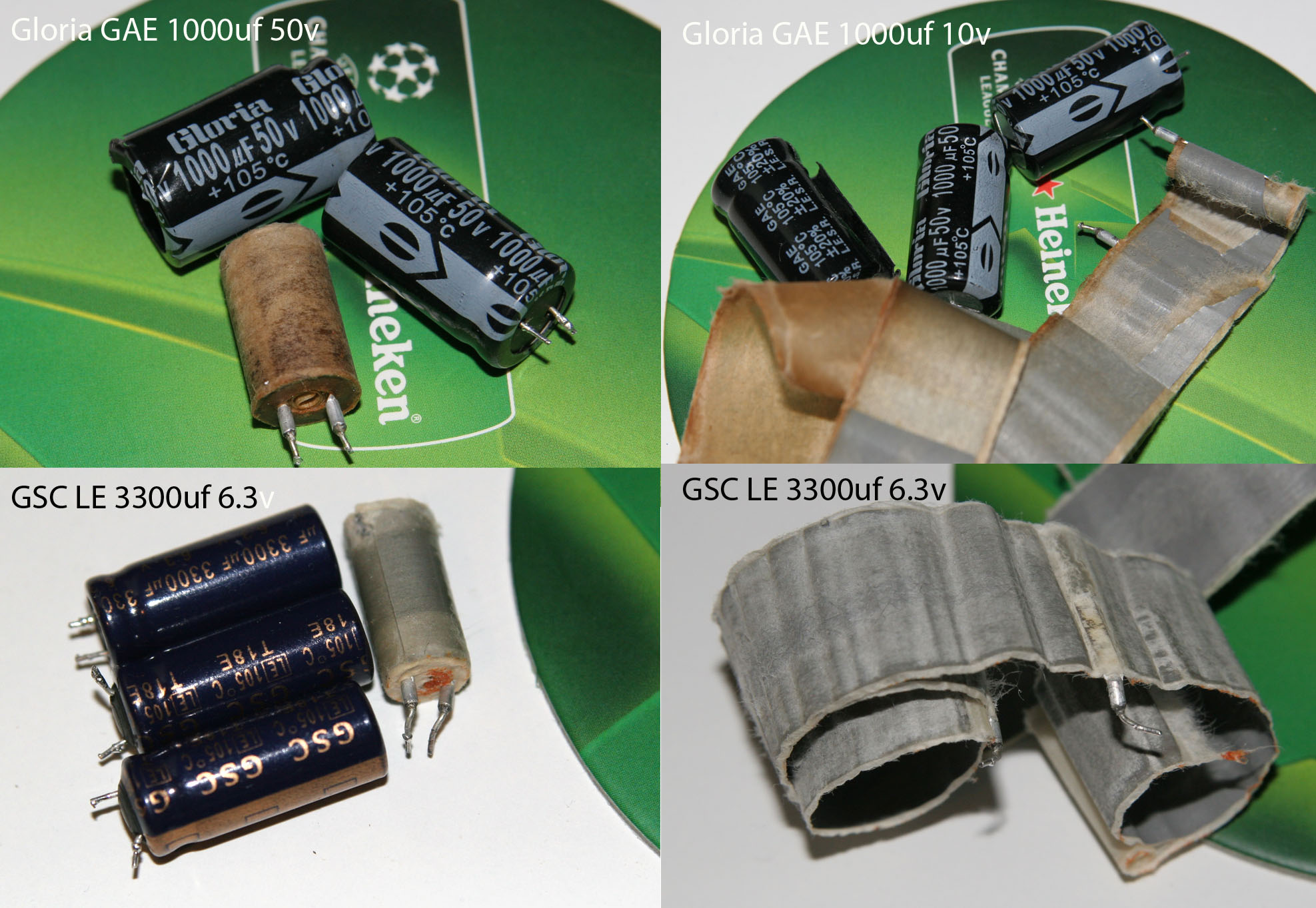

          Chhsi / Lelon and Gloria / GSC by Willawake
