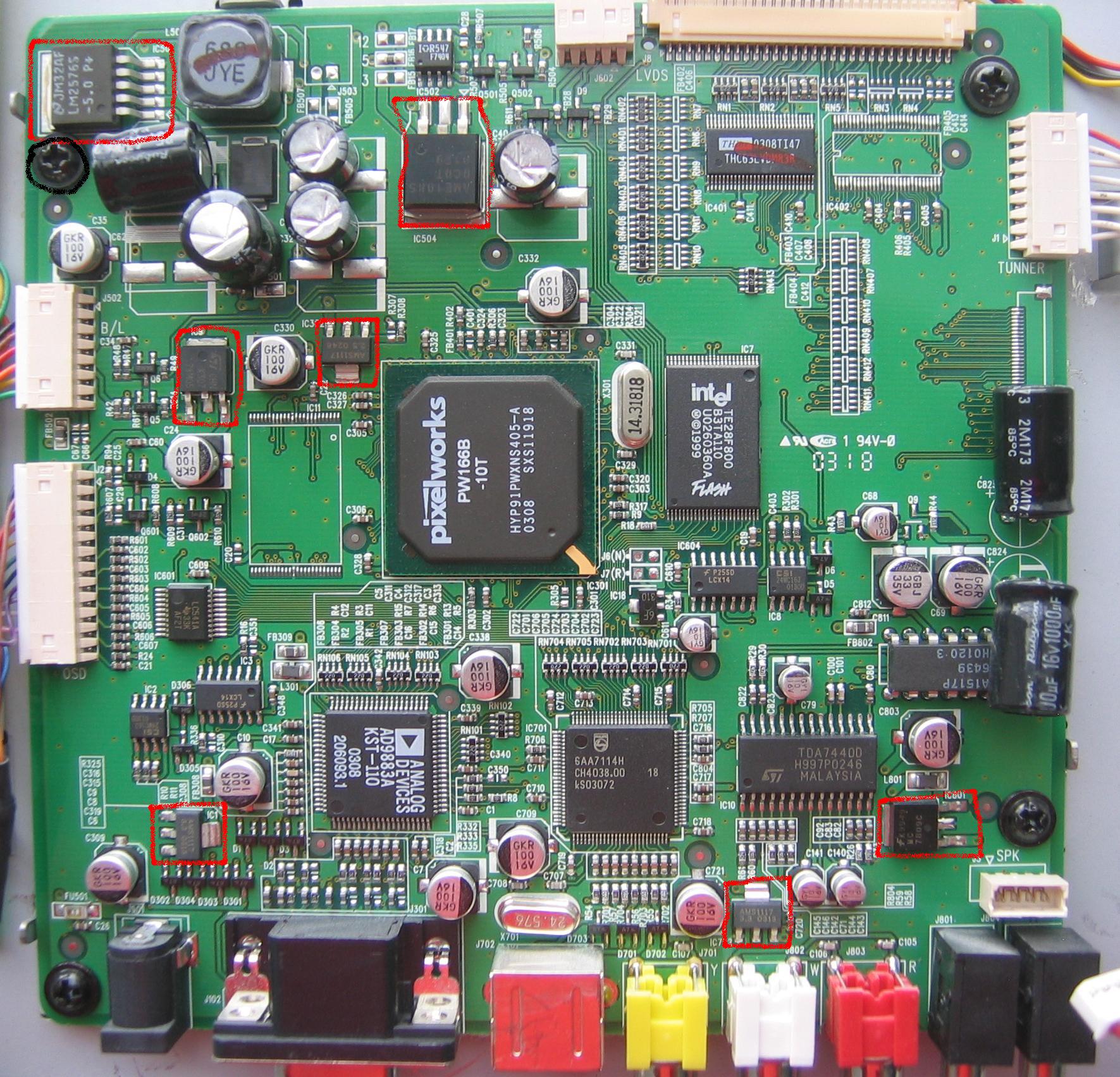

    Testing a voltage regulator requires a digital multimeter. The test is simple and easy to perform. Note: Voltage regulators are typically "low" voltage. Most are 5V DC or less so there is little danger of you getting shocked, but as always, exercise caution when measuring power.
    To test a voltage regulator (circled in red),
    1) Set your multimeter (if manual range) to 20V DC or DCV for autoranging.
    2) Put your black probe on a ground screw (circled in black). Leave it there the entire time. This is your ground.
    3) Put your red probe on each of the pins including any "cut" or "stub" pin, but ignore the "fat" tab. The fat tab is "up" or "north". Number the pins left to right.
    4) Report them like below along with the part number (include all lines on the IC) of the IC. Don't report "they all tested good". About once every 2 weeks, we get someone who reports that only to find out they did the arithmetic wrong or mis-interpreted the results. So report all the readings.
